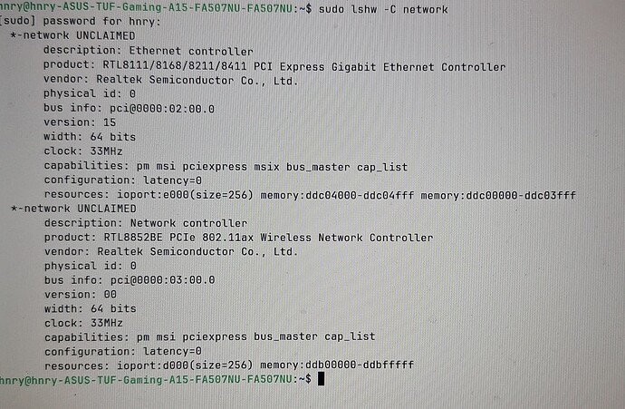

I haven't used my laptop in a week, and when I open it up again, my wifi and bluetooth are completely unavailable. I've tried multiple wired connections and nothing worked. please help me fix this.
(apologies for the image, I am unable to connect to the internet in any way shape or form from my laptop.)
my network card is the
Realtek RTL8852BE.
let me know if more information is necessary. thanks in advance.
Static electricity or a "stuck" power state in the Wi-Fi card can prevent the driver from claiming it, which could happen after sitting for a week.
Shut down the laptop completely. Unplug the power adapter.
With the laptop powered down, press and hold down the power button for 30 to 60 seconds.
Plug it back in and turn it on normally.
This forces the motherboard to discharge completely, resetting the hardware's internal state, so it can be "claimed" fresh by the kernel.

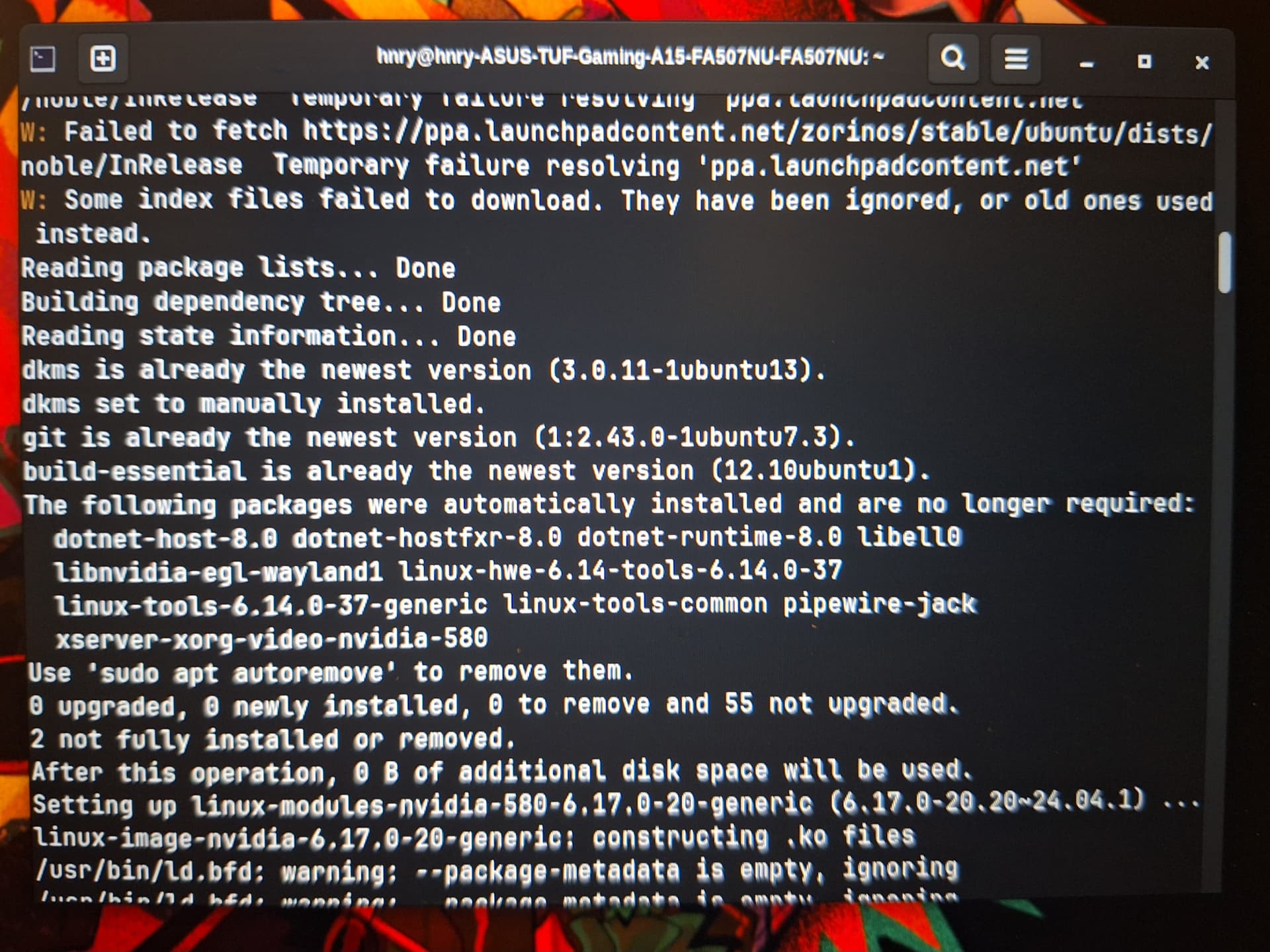

Install the essential build packages (you’ll need a wired (Ethernet) internet connection for this step, or you can download them in advance to the USB drive. If you don’t have a wired connection, proceed to the alternative step below). Type the following command and press Enter:
bash
sudo apt update && sudo apt install dkms git build-essential -y
