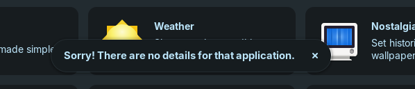

From the Main Menu, Select: Windows App Support.
Windows App Support, only opens "Software" with an error message:
"Sorry, There are no details for that application"
How do we remove this defective software?
i.e. Remove "Windows App Support" completely from Zorin
Do You have Windows App Support installed? If not, then that what You see is only a Link which leads to the Installation. You can uninstall this Shortcut with:
sudo apt purge zorin-windows-app-support-installation-shortcut

No. When You click normal on this, it should lead to the Install Page of Windows App Support.
What this is, is a redirect in the app menu to Install Windows App Support from the Software Store.

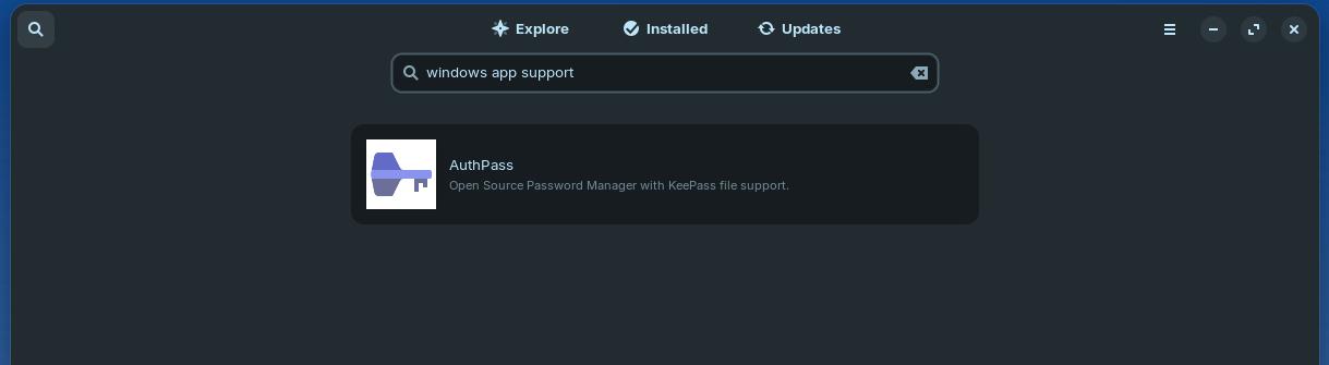

Have you tried using the Search tool in Software store and enter "Windows App Support".
There was a Software Store issue a long time ago, when you could not see the App icon in Software, but a Search did actually find it.
I'm not saying this is the case now, but maybe worth a try.

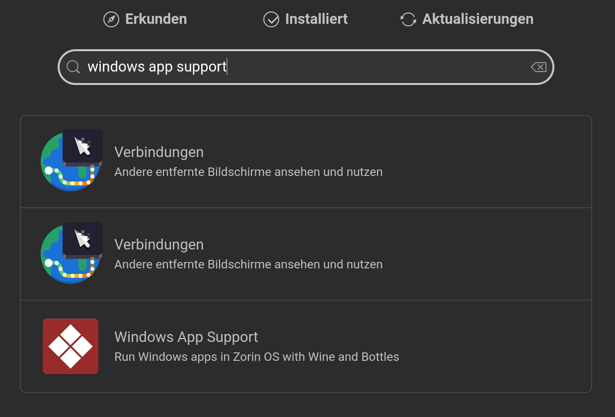

It is listed in Gnome Software:
This makes sense to me.
@AZorin, it appears the App Menu entry that redirects to Zorin Windows App Support does not fully redirect to the installation process.

I do not know what to say, I do not get the same result when searching for the same string

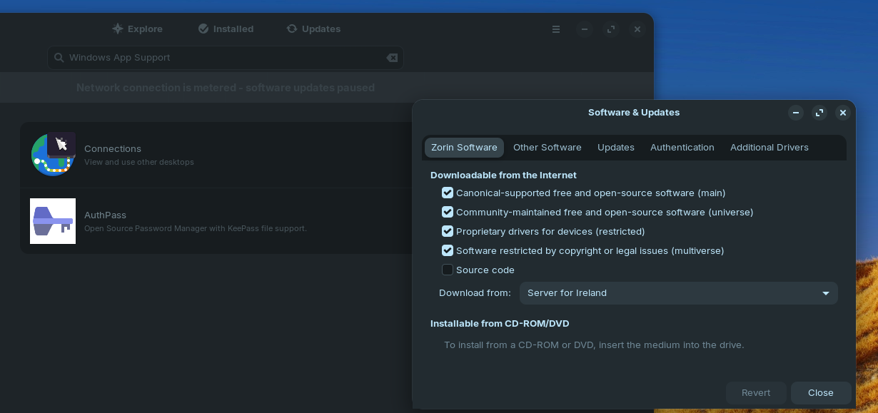

Hmm ... when You go to Software & Updates and there in the first Tab on the left: Is there ''Main Server'' chosen for the Download Source?
I don't know if Search is case sensitive, but try add the caps. Windows App Support in search.

2 days ago screenshot shows server as Ireland
Regarding the question on case-sensitivity. Screenshots from Ponce-De-Leon shows lowercase.....
2 days ago screenshot from me shows Leading Caps, and yesterdays shows my screenshot with the same string (lowercase), with different result.
