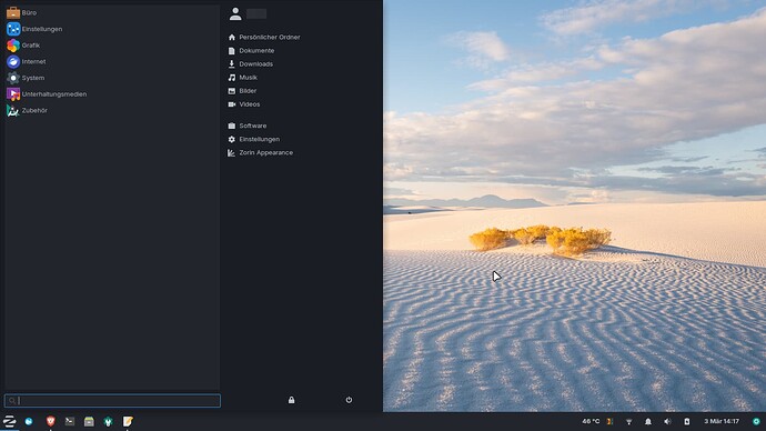

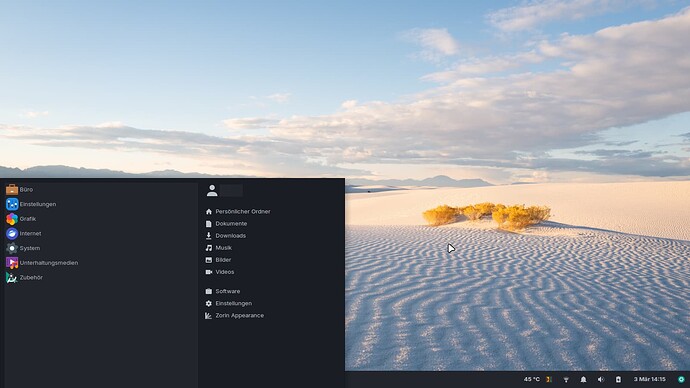

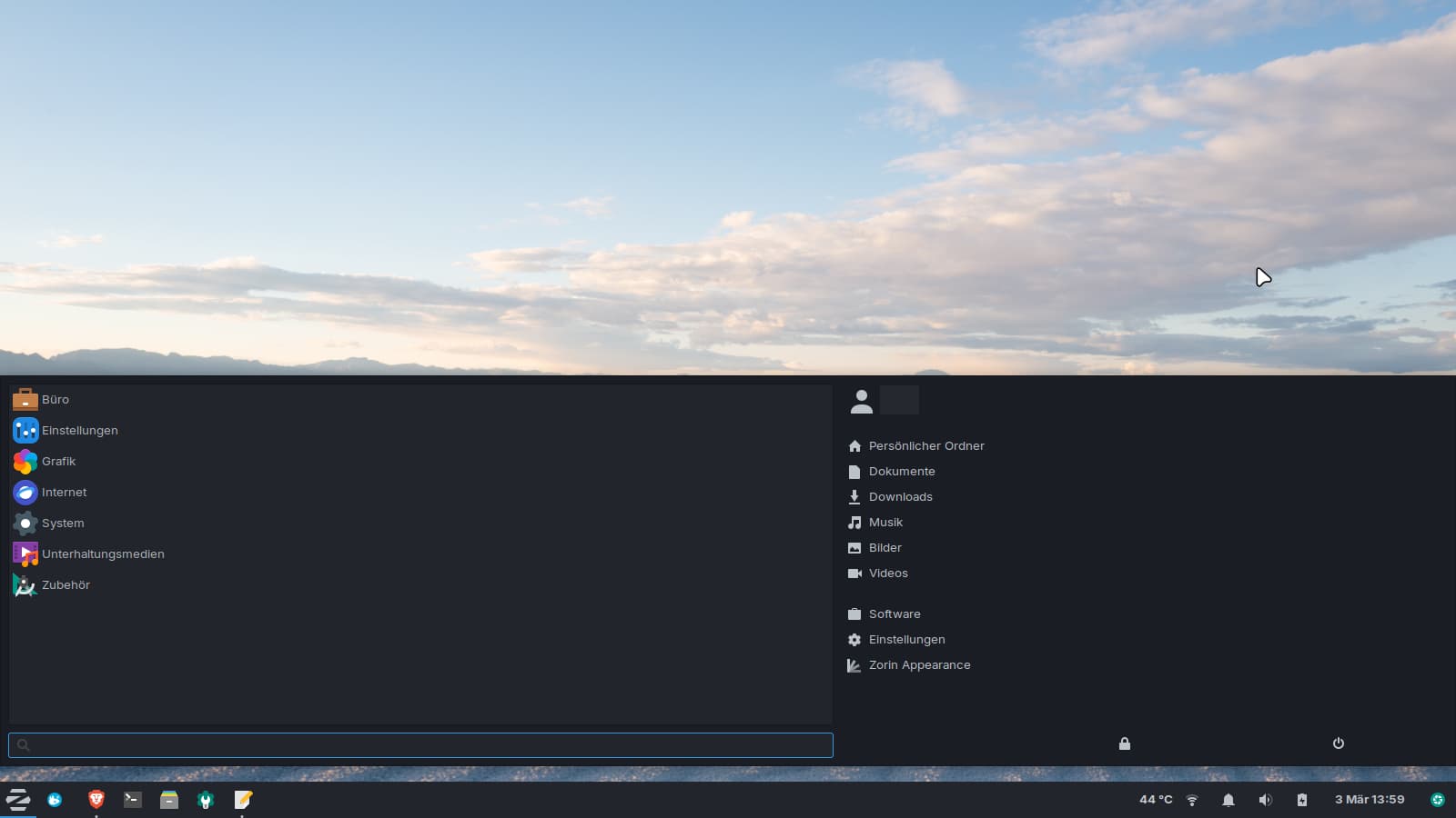

I have also a strange problem with the Zorin menu. When I use SUPER+arrow keys it gets out of its form and I can only logout to get the normal Zorin menu back.

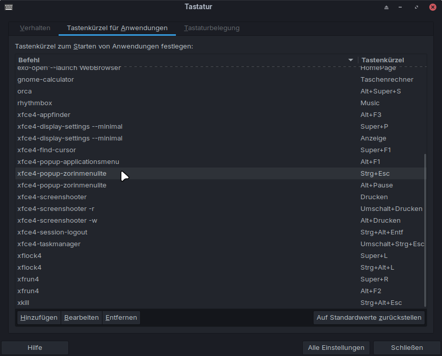

I tried to delete the SUPER shortcut key for Zorin menu but it isn´t set to use SUPER key in the keyboard settings:
I think it disturbs the window tiling functions which also use the SUPER key.
If Super Key is bound to the zorinmenulite plugin, and also bound to the window tiling, maybe that is what is causing this glitch.

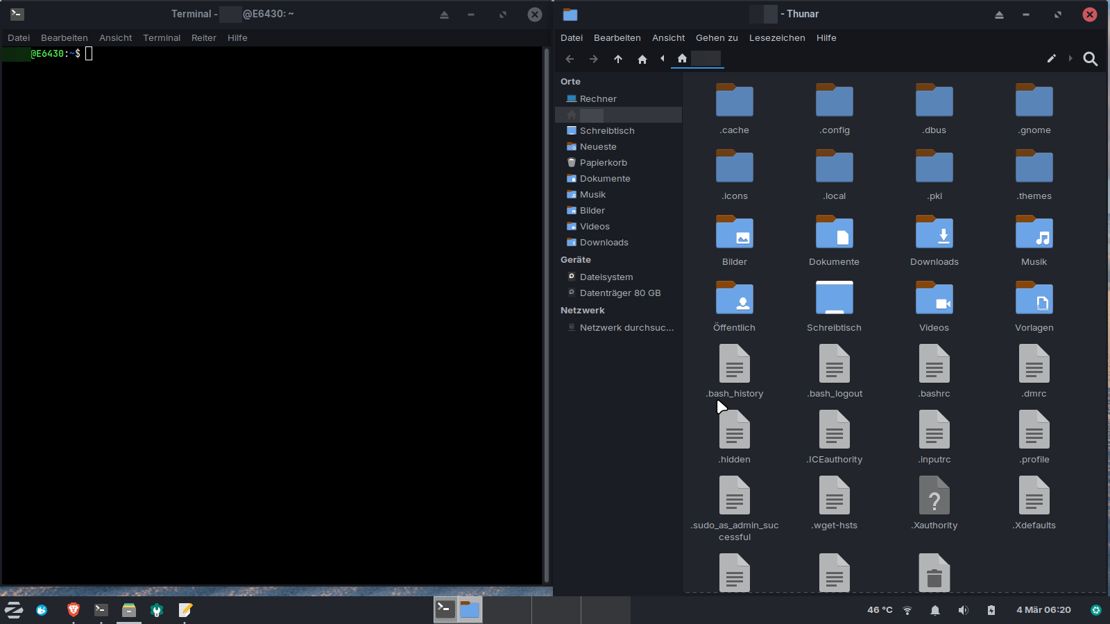

You can drag the Window and move it towards the edges of the screen (don't release the window) , as soon as your cursor reaches to the edge it will be tilled accordingly.
I have used this way of tiling in Zorin Lite 17.
Ah, thank you, that works after many trials with a window - when you move it fast enough. It is difficult with the touchpad to be so fast.

I believe it doesn't need to be very fast. Just drag the Window normally and while keep holding it move the tracpad towards the edges, just don't release the window until the cursor reaches to the edges.
Also you can try increasing the touchpad sensitivity and see if it helps moving the cursor fast.
That did it! :grinning_face: I've never found out what the problem is and have used XFCE nearly a year now.
I always released the window when the window reached the edge, but not the cursor.

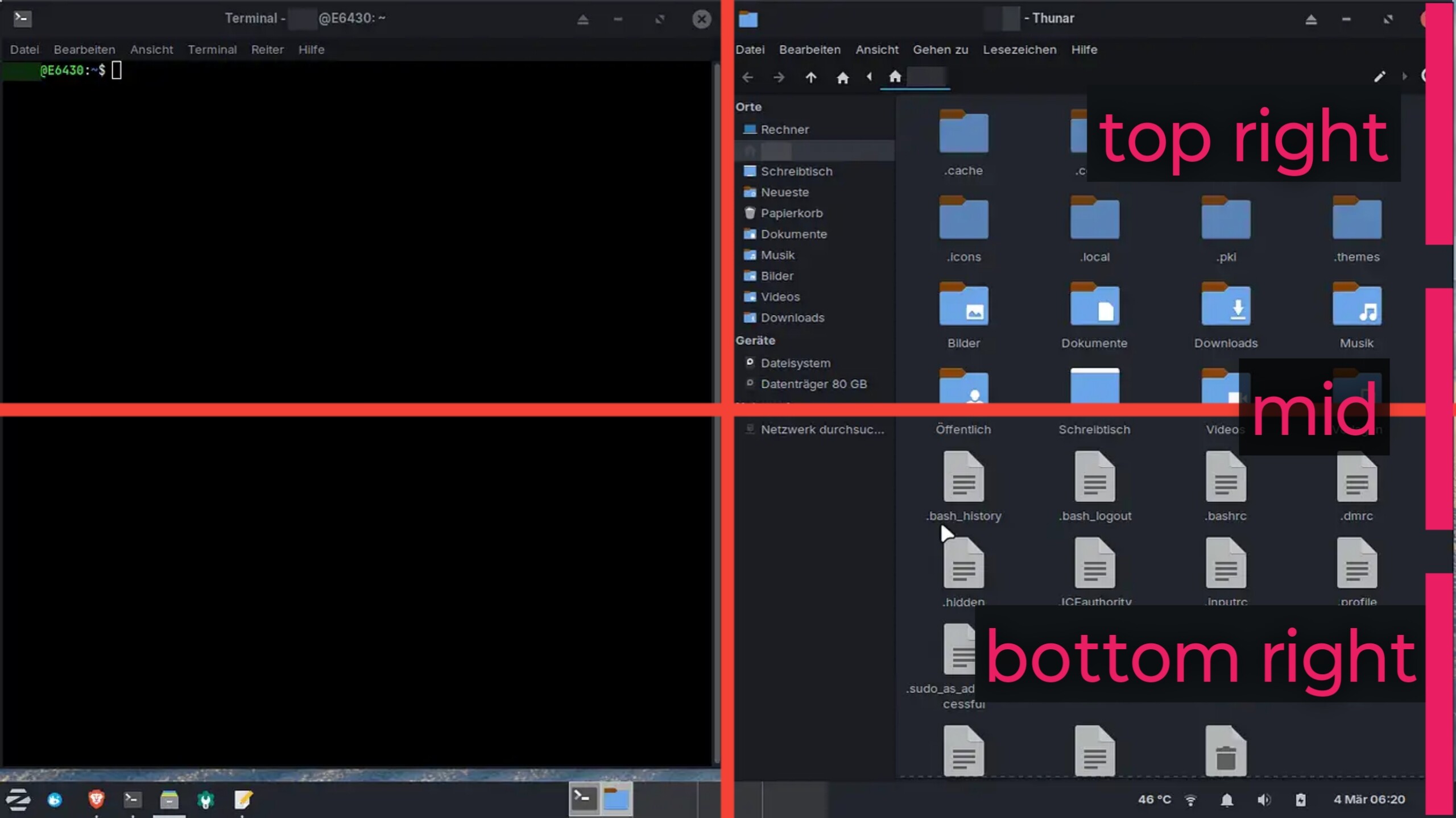

This image is not accurate but it's should work in the same manner
Drag your window to top-right edge and it will be tiled in top-right. Mid edge will tile the whole right side. Bottom-right edge will tile the window at bottom right.
Similar to the left side edges.

That was a stupid question of me. It works perfectly when I focus my eyes on the cursor and not the window borders. Important is where the cursor is.

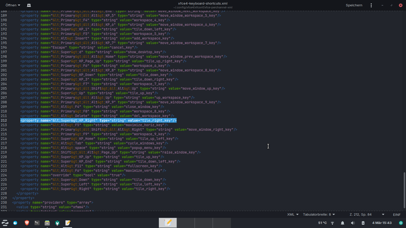

I searched for a solution that may help with the SUPER+➡️ bug. I edited the file
~/.config/xfce4/xfconf/xfce-perchannel-xml/xfce4-keyboard-shortcuts.xml
and removed the following line from the file:
With a fresh reboot and not re-adjusting the shortcut for tiling windows to the right side, it worked to move a window to the right side with super+➡️. I'll see if it is a permanent solution. It may also help to remove the other ones KP_Up and KP_Down (You can also set the output to empty instead of removing the line).
I have no keypad with numbers on my laptop, so it may help to avoid conflicts. As far as I see, it works good now (have removed all three lines 202, 212, 220 - KP_Left doesn't exist).
The problem with Zorin menu loosing its form and treated as window is still there when the Zorin menu is opened while pressing SUPER+an arrow key.

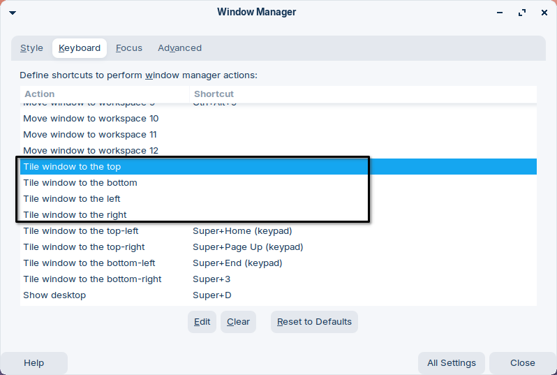

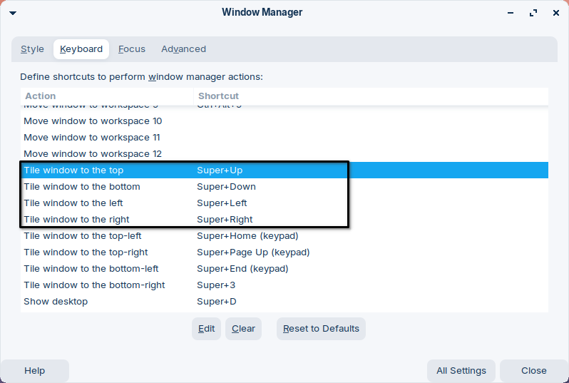

For all those users who don't like editing files:
You can go to settings > Window manager > Keyboard
and clear the four marked entries there. You have mostly to do that twice because they are double-booked. The right side should be empty then.
Now remap the four lines with the keys you like by clicking on edit. I used SUPER+the arrow keys.
This action removes all double-booked entries for the window tiling so that there no longer are conflicts.
That are the settings before editing:

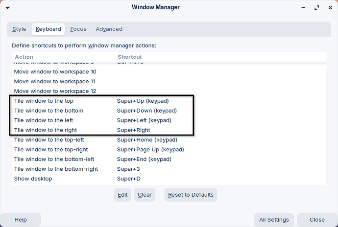

Now all four lines cleared:
And when you have finished:

If you try to use the Whisker menu with the SUPER key instead of the Zorin menu and set SUPER key as shortcut, there are considerably more problems and the Windows tiling shortcuts SUPER+arrow keys do not work at all - the Whisker menu always opens (all Zorin menu shortcuts were removed before).
But when you assign Whiskermenu e.g. to Alt+Pause or Ctrl+Esc, then it opens also when you press SUPER, and window tiling works.
So it seems as Zorin menu isn't assigned to pure SUPER key, although you only need to press SUPER to open it.
There is probably a function integrated that redirects the keyboard shortcuts Ctrl+Esc and Alt+Pause to the Super key.

There is this tool called xcape used in Zorin Lite to perform the Alt+Pause with Super. Launch task manager and look in the process list or search for it, you will notice xcape is running to perform this task.
