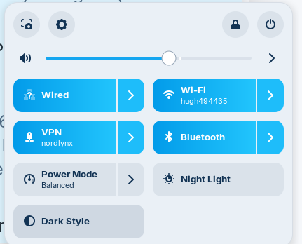

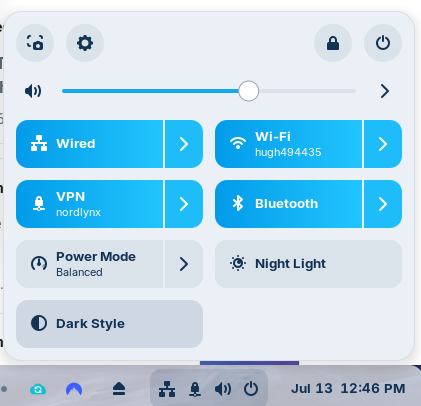

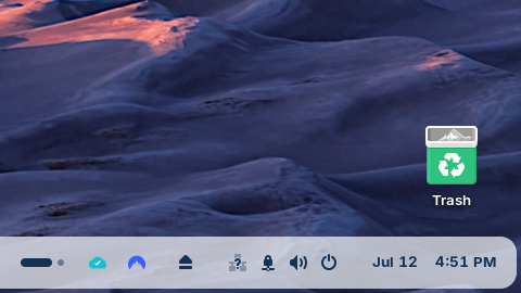

Can anybody explain to me why I have a faded wired connection with a ? mark. After I installed Zorin. All my connections were lit up so to speak. I would say about 1-2 weeks. I started noticing that my wired was fading after start up with a ? mark. I have checked this 3-4 times everything is still connected by wire and wireless. I use both. I need wired for my VoIP phone tied to a Satellite Internet. Just makes the phone better. I use the Wireless for my printer/scanner. Which I just got solved after many weeks of trouble. I also use the wireless for others if need be. But the wired connection fading with a ? mark. And still connected is confusing. This is not a great importance. Since I have connection on both wire and wireless.

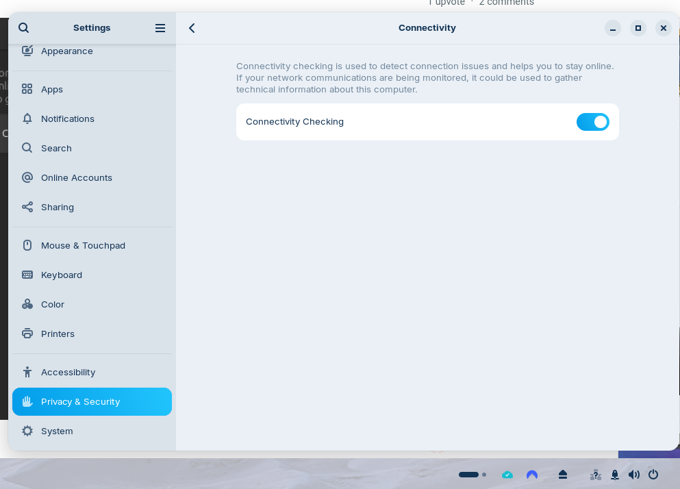

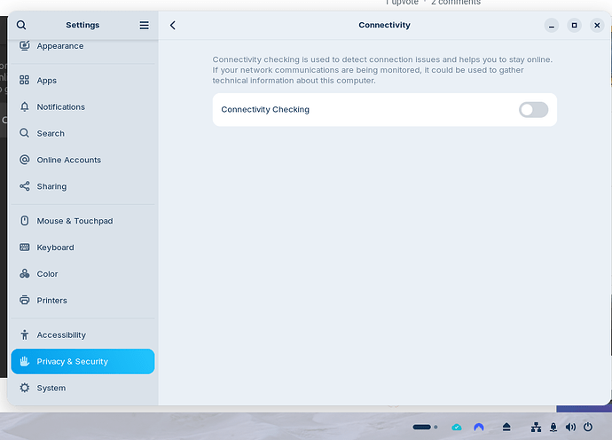

Can you please post the terminal output of the commands? Disabling the connectivity checking removes the questionmark, but it's actually better to leave the feature enabled. Are the speed and connection of the wired connection normal or are there problems?
Maybe the question mark has something to do with your VPN. I read that you're using one.
I find that Connectivity Checking indication and setting flaky on Z17.3 with wifi showing [?] randomly on boot. I just toggle that setting on/off and [?] disappears, as wifi is good regardless of that indication.
I have it disabled permanently. When it would disable the Indicator, too, I would it let enabled. But so ...
I also have it disabled, but when tray icon indicates [?], I toggle it enable then back to disable.

Truth be told I did not do any terminal codes. I saw the reddit screenshot. And did that. Then everything started working. I started to notice some changes to Firefox. I don't know about anybody else. But I have been having great issues with Firefox. It wouldn't load, then stop loading. And pages just didn't want to open. Then I had a lot of pop up windows. I think saying Force Quite or Wait in Firefox. This happened dozen times or more everyday for the last maybe 2 weeks. Since I changed that setting. There are no problems in Firefox anymore to date for me. Now I just got back on. And I discovered something new and weird. Said something about "connection failed?" with a pop up window. The ethernet symbol had 3 dots in a row, my wifi was "out" even though I had connection still. I just went into my wifi and clicked. Seemed to fix it. You are right I do have a VPN. Nord. I did look at the settings but still trying to figure it out. At this point I thought a setting change in the system. Was easier. Considering I am still very new and hesitate about Terminal Coding. Don't want to lose my network connection.
