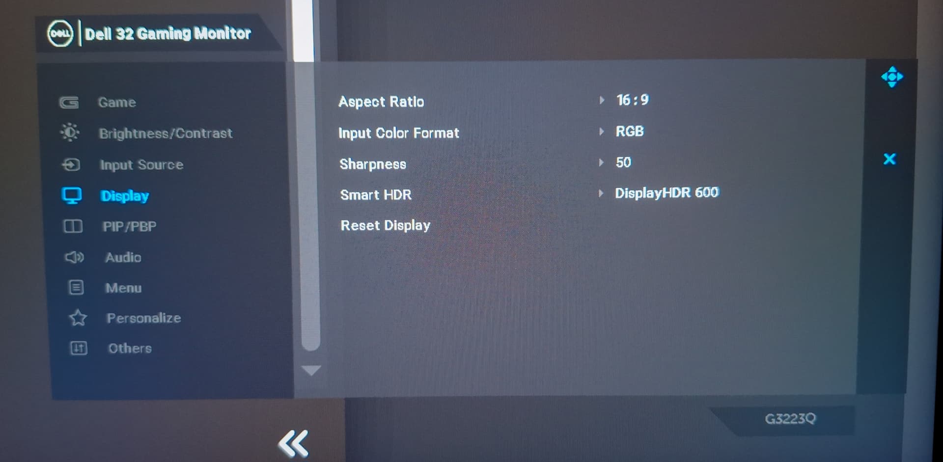

You could also try to switch to another color profile for your monitor/display. Perhaps this also solves the issue when using X11.

Thats an excellent suggestion for the OP @Forpli , I run the RGB color profile on my Dell G3223Q monitor, everything works as expected.
