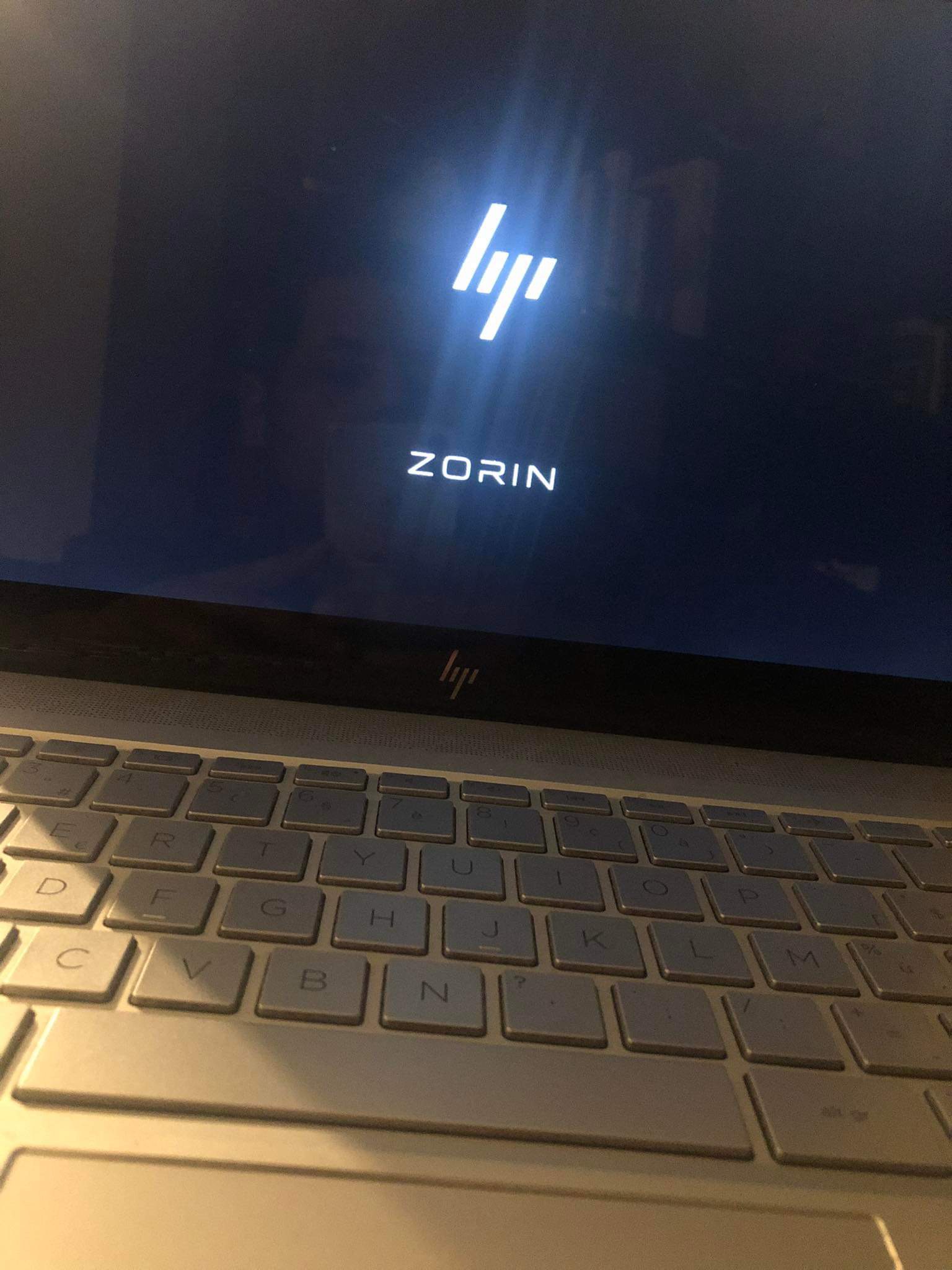

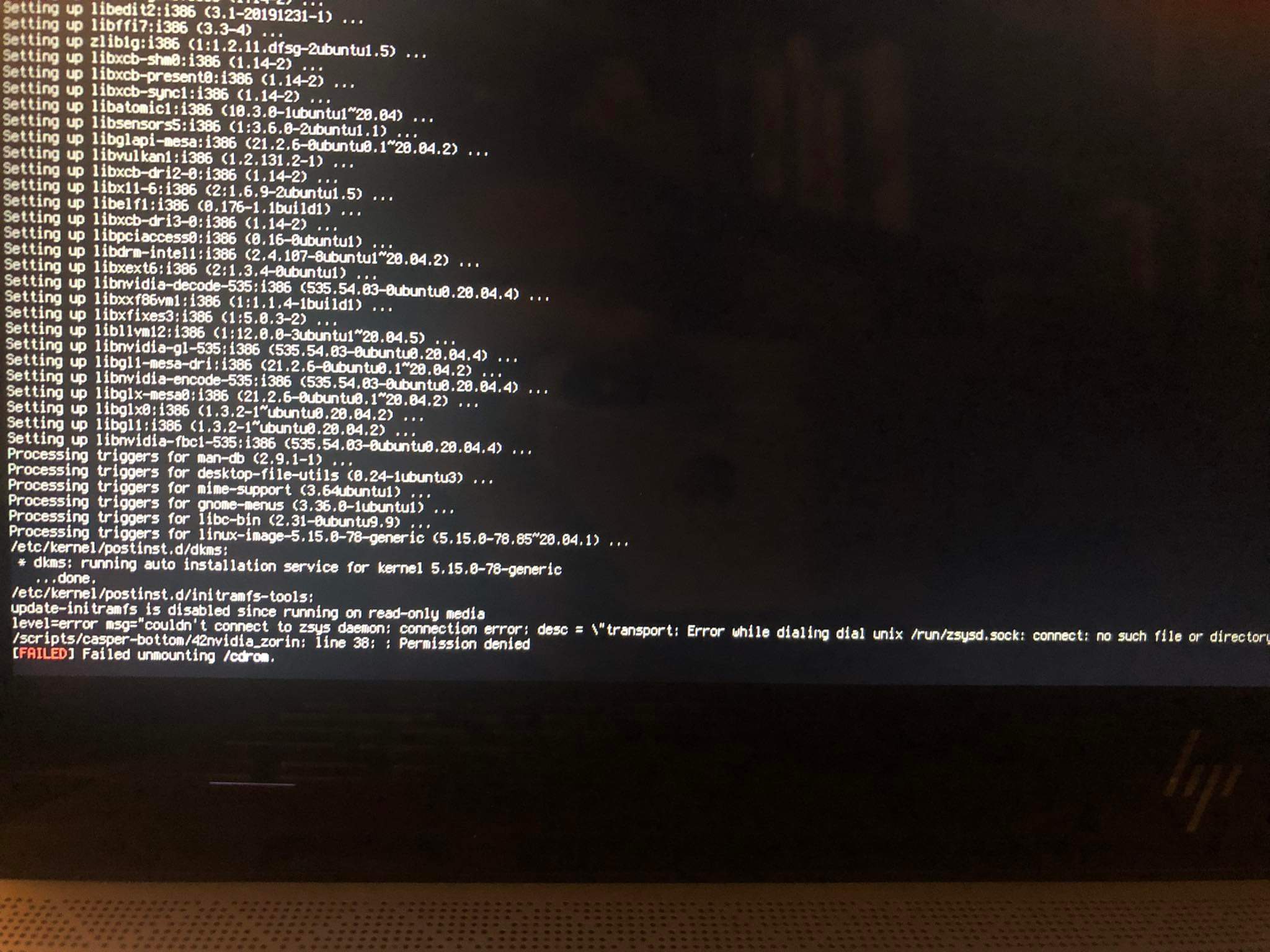

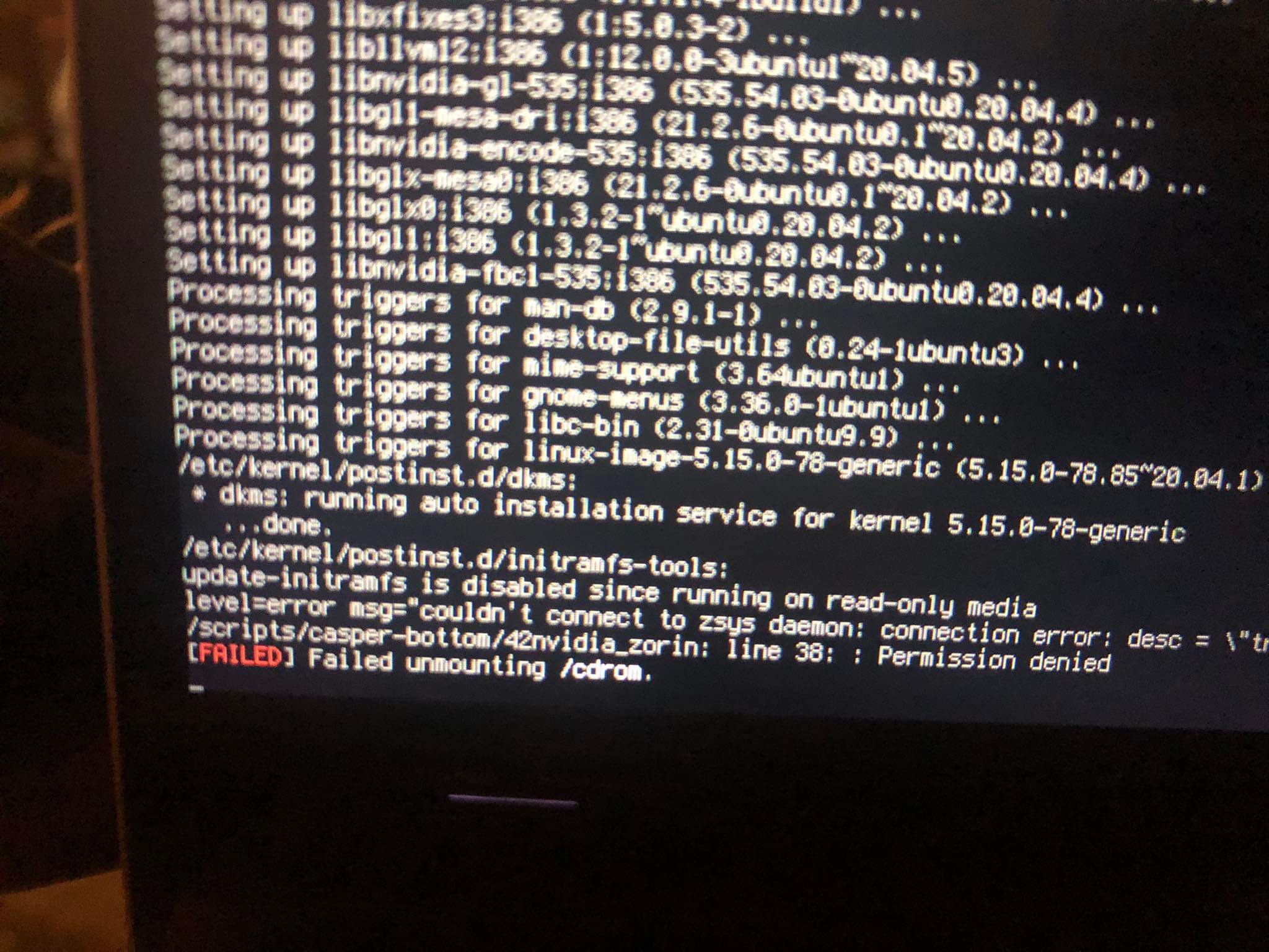

Zorin 16.3 pro : can you help me solve this error and be able to proceed to the installation?
I want to install Zorin using a bootable usb drive but I still get this error message. I used different tools to put the iso file in the usb drive but it stills the same problem.
Can somebody help me please ?

Have you yet tried launching Live Zorin With Safe Graphics?
I also tried this option but still have the zorin logo in the screen
It gets stuck inti 'running Network Time Resolution' . I still have to zorin logo on the screen and I can go into the installation menu.
You may have a network card not connecting - but the installer is looking for the network connection. Try unplugging the Network card, if accessible. Then boot the LiveUSB.
I cannot unplug the network card. Maybe trying to connect my computer using ethernet cable ?
This also is a Good Option. :smiley:
EDIT: I also just noticed another issue in the above post: Did you select to install Zorin OS with Full Drive Encryption?
If you did so, try installing without checking the box for full drive encryption.
