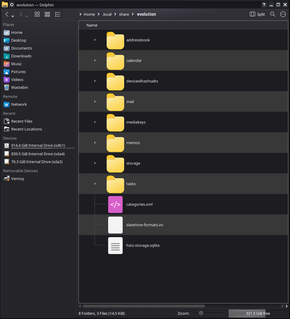

If one was APT and the other Flatpak, the latter isolates itself from the system. I will look at my APT Evolution install and see where it is at. I have a VM of Zorin 17 on another OS. I will see where Flatpak installs to and get back to you.
Update 1: APT, storage is here - /home | .local | share | evolution:

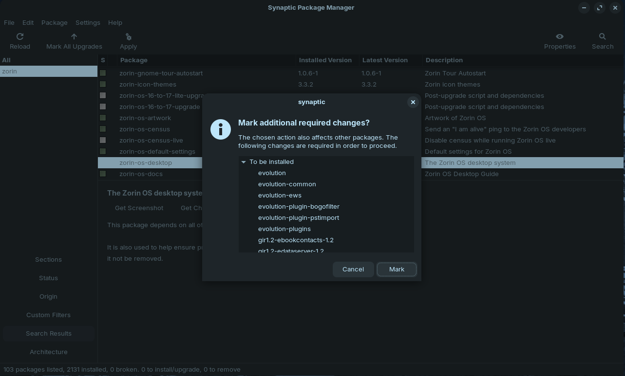

Well, this was an interesting experience with the VM of Zorin 17. Been awhile so had to do a ton of updates/unattended upgrades. Then I launched Synaptic Package Manager and selected all packages related to evolution. This had a major effect of destroying (based on what I saw was going to be removed) the Zorin Desktop, Gnome Extensions, and Zorin Appearance and Zorin Connect.
So after completing the removal I opened Synaptic Package Manager and searched for all things 'zorin' in the search bar. Selecting the reinstallation of ZorinOS-desktop pulls back in the APT package (I am making an assumption it is APT) of Evolution! So I have not done that. Now to see what happens when I reboot the VM:
