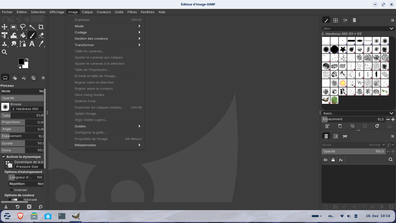

A very nice bug... the impossibility of using GIMP in French.

What happened here seems to be simply that the Zorin OS developers have decided to include GIMP at its latest version, the much awaited 3.x, but have not yet handled all of the language packs.

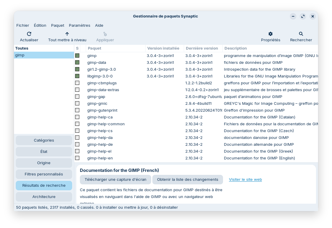

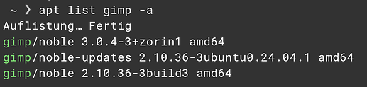

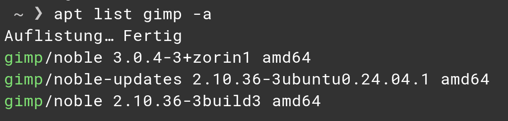

On the live stick of Zorin 18 only the gimp 3.0.4 is shown, no other ones. I tried to install 2.10 versions with terminal, but didn't work.

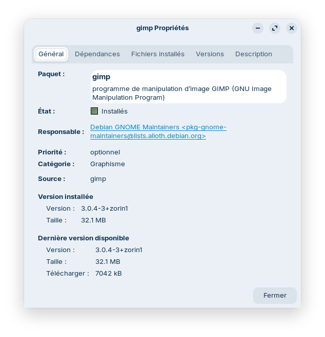

The Version Attachment shows that:
grafik
I mean the +zorin1 at the End.
I have Zorin 18 installed and get to see 3 Version:
I had made something wrong. I only entered
apt show gimp | grep -i version
and there was shown the 3.04. And when I entered -a because it was said from terminal that there were two other packages, the command was not known.
But I was not able to install those older packages due to dependency problems and it was said that 3.0.4 will be installed.

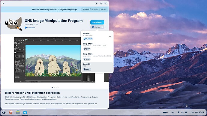

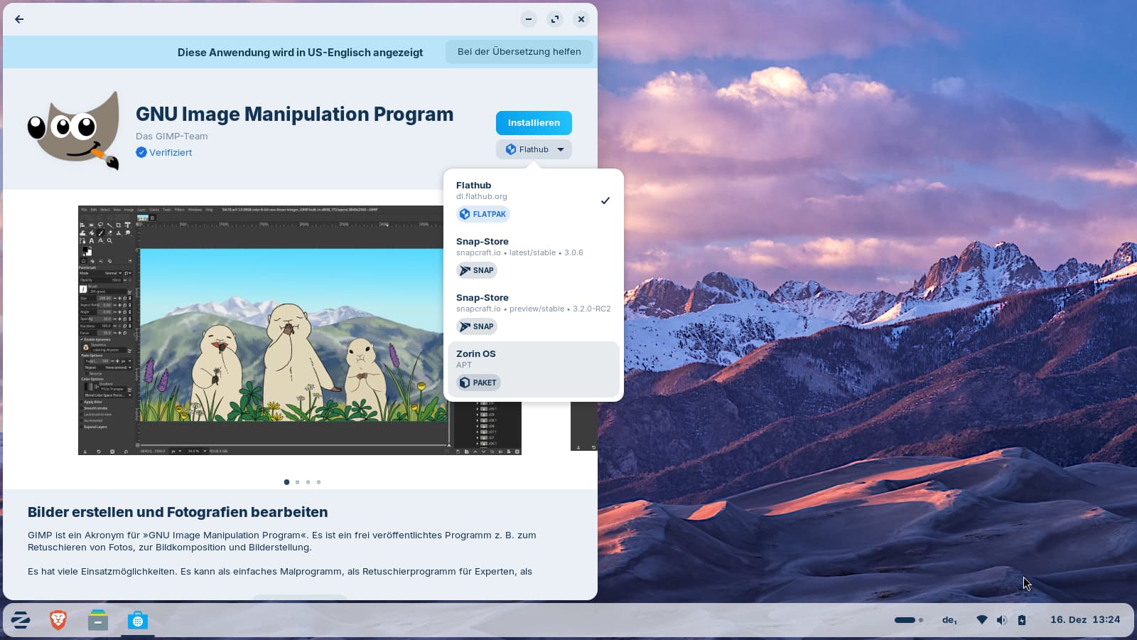

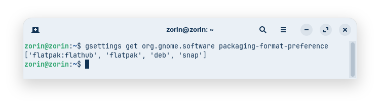

Edit: Has the sort order of packages in gnome software store been changed from Zorin 17 to 18? When you search for gimp, there are at first position flatpak, then two packages snaps and the last one is the Zorin package. In Zorin 17 the Zorin packages were at second position and snaps at the last position.
In the gsettings snaps are shown at last position, but this setting seems not to be applied and useless.

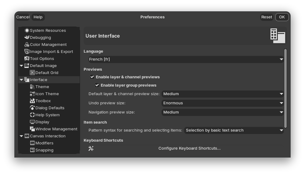

@merinos I tested the gimp appimage and there the french translation worked. The flatpak and snap versions were too big to install on my Zorin live session.
On the Zorin live stick I also tested a workaround/hack from ubunuusers.de and adapted it to french:
I added a french translation to the gimp version of Zorin, but I don't know if this approach is risky, because I don't know what I actually did there. So I wouldn´t recommend to follow the steps and better install the appimage or flatpak/snap if you need a french translation. These were the steps I did:
1  sudo apt update
2  sudo apt install gimp
3  wget https://gitlab.gnome.org/GNOME/gimp/-/raw/master/po/fr.po
4  sudo apt install gettext
5  msgfmt fr.po -o gimp30.mo
6  sudo cp 'gimp30.mo' '/usr/share/locale/fr/LC_MESSAGES/'

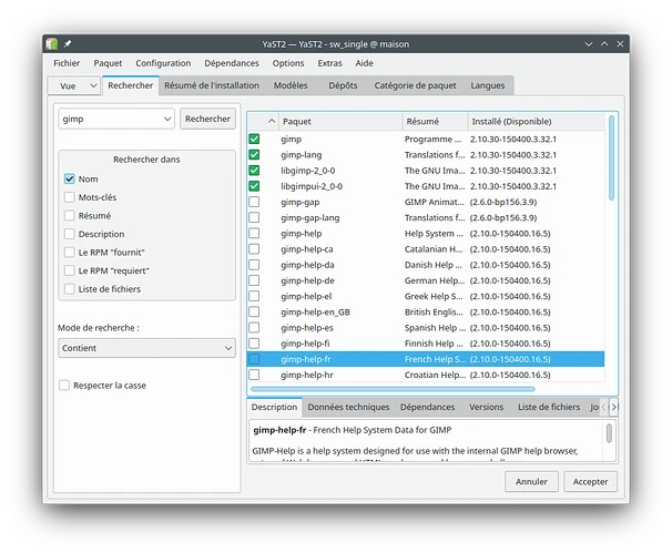

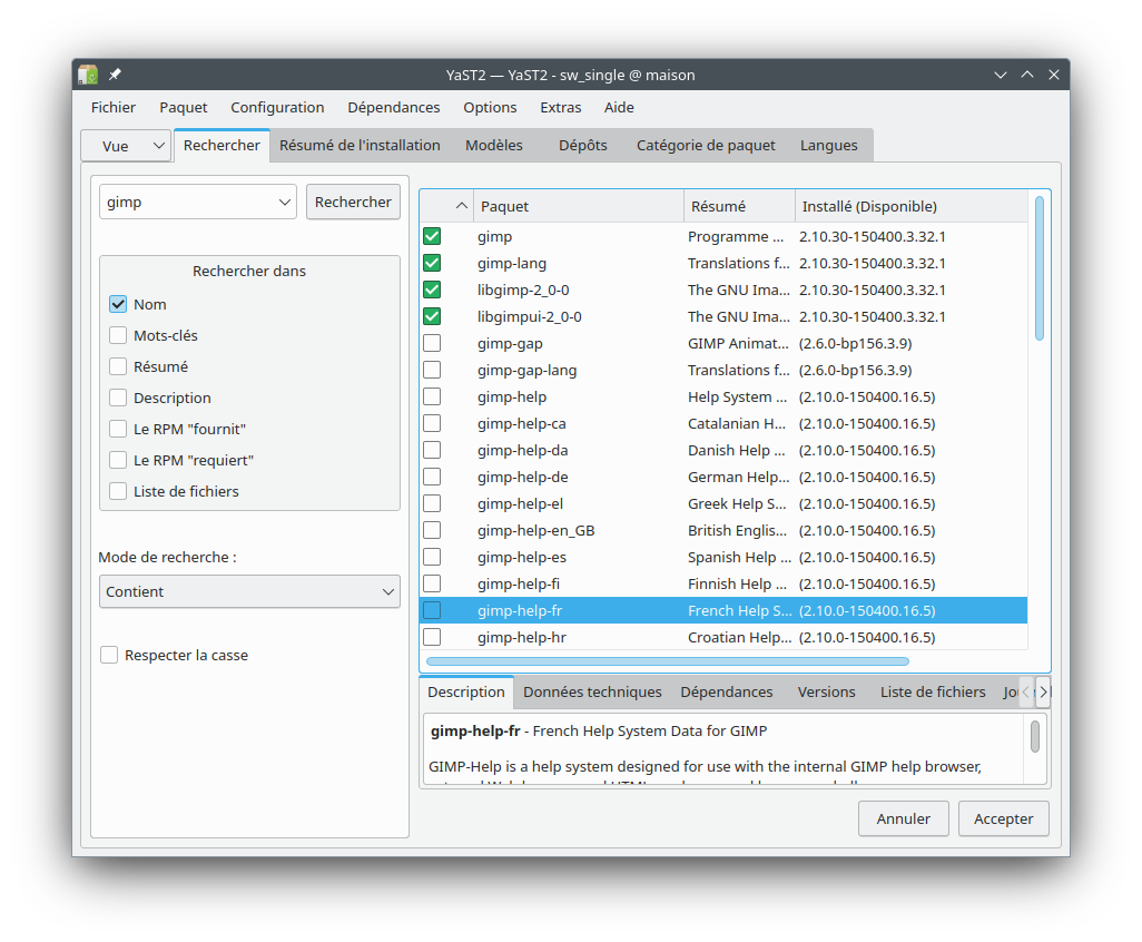

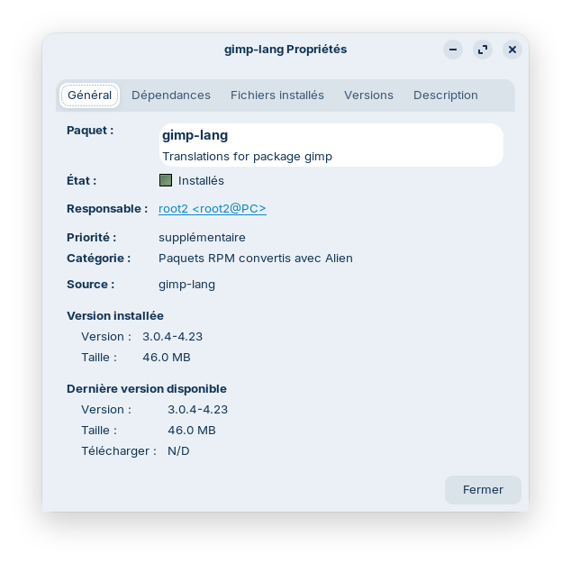

After some searching, I found a solution for the graphical interface.
Download this RPM file:
download.opensuse.org/repositories/home:/lalala123/standard/noarch/gimp-lang-3.0.4-3.23.noarch.rpm
Convert it to DEB (not necessary, but nicer to send to friends) with the alien program (which must be installed first).
Finally, install the new Debian package and the interface changes language.
But, for the user manual packages, it still doesn’t work.

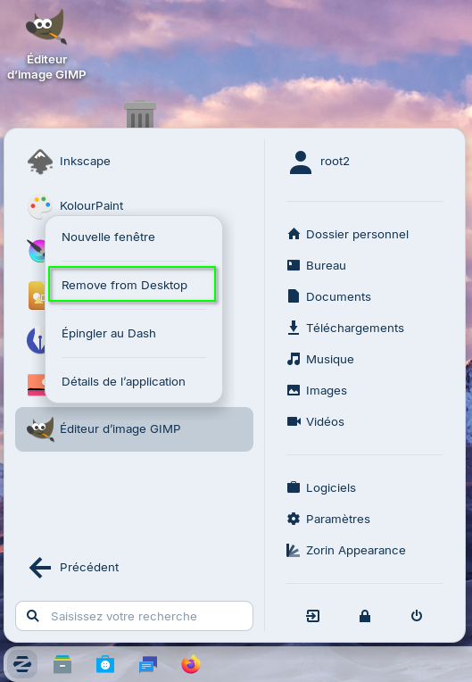

Snap icons on the desktop after an update.
This problem is in principle being resolved:
Another small translation in the menu:
