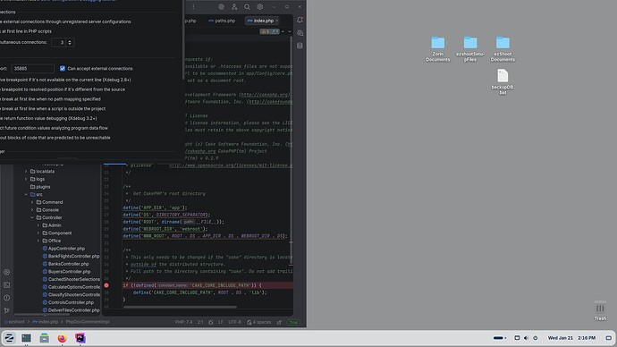

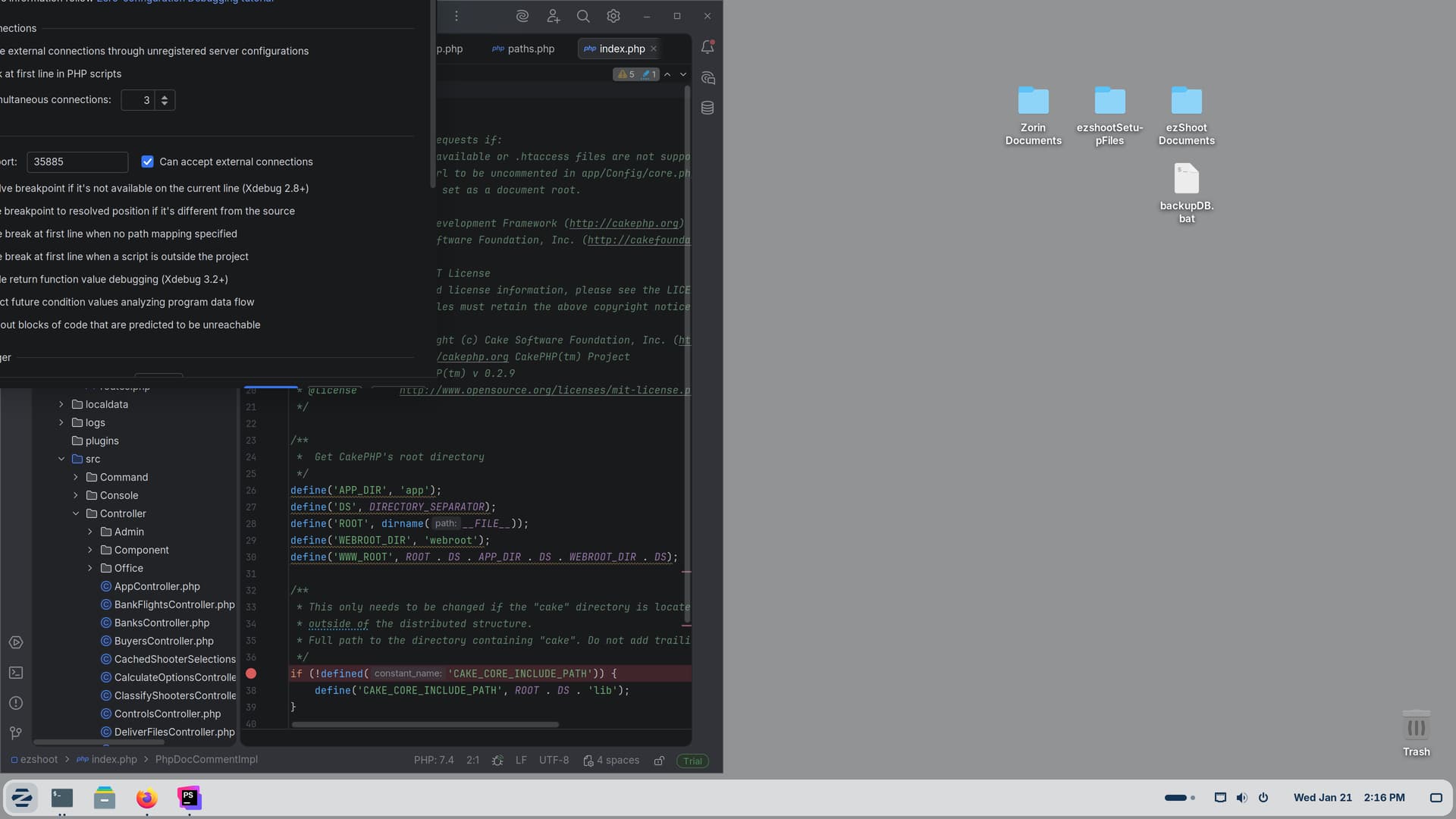

After 30 min, system suspends. I come back to phpStorm still on screen, but its sub-window is 1/3 off screen at upper left. I can't move or close it, so I end up having to kill the phpStorm job. Is this a setup error on my part, a problem with GNOME, or Wyland?

Yes I'm happy to let it suspend, just don't like the sub-windows moving. I think is has something to do with the zoom of 200% to get text to be legible. I "think" maybe upon wake up, the zoom is applied to late?

Yes it does... something new I've noticed... when i sit and watch the system time out to blank the screen at 15 mins, once in awhile the screen flashes on again, and it shows the full background, with another upper left version of the screen in 1/2 size! My hi-res 32" monitor is unreadable at normal zoom... so I'm going to try using 100% with larger fonts instead of using the zoom feature.
