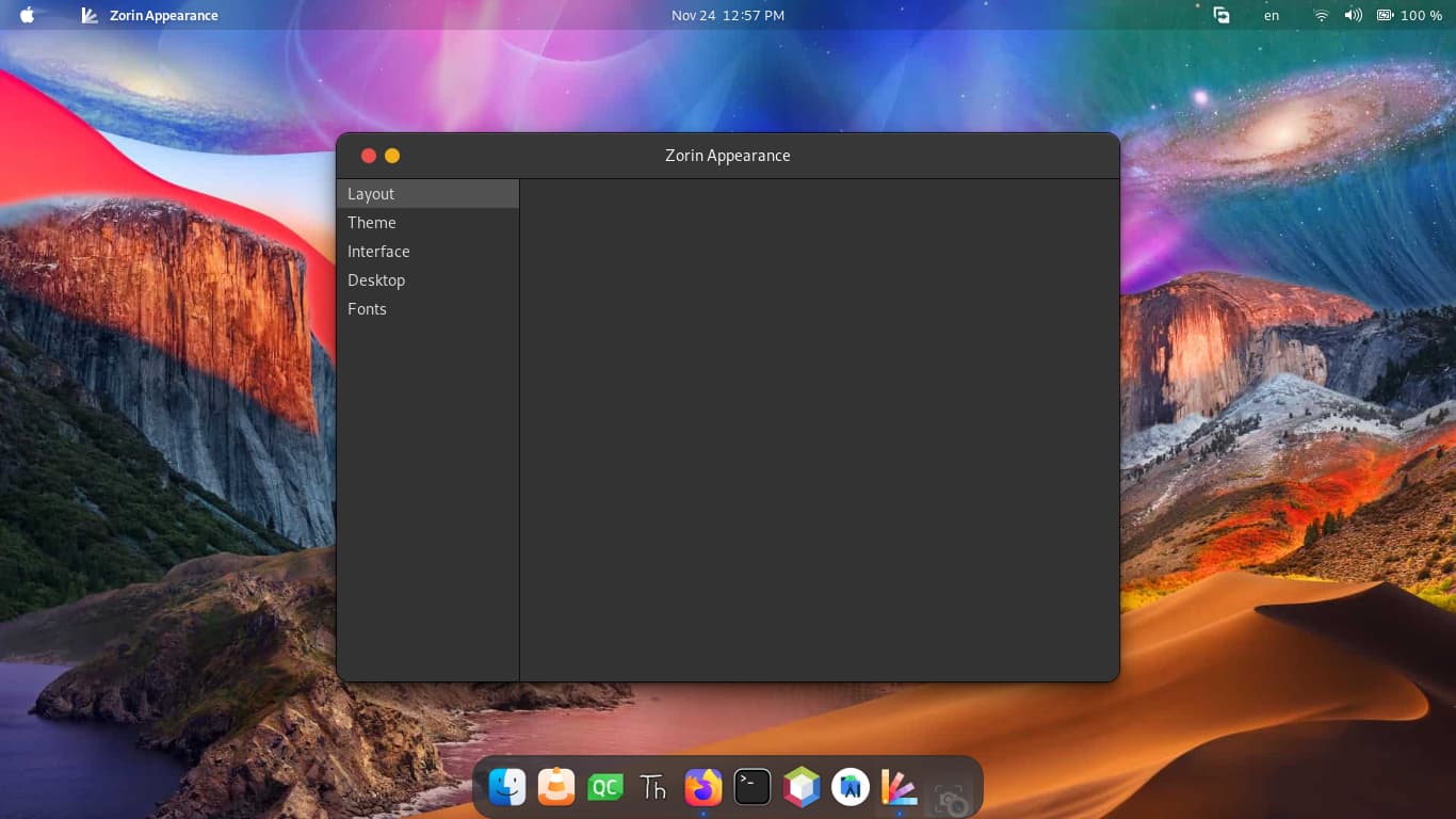

zorin appearance layout not show up
I am using zorin 16.1 pro version and updated to 16.2. How to appearance back?

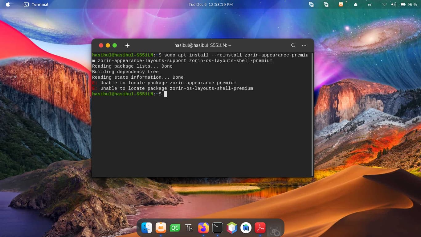

Have you tried
sudo apt install --reinstall zorin-appearance-premium zorin-appearance-layouts-support zorin-os-layouts-shell-premium
