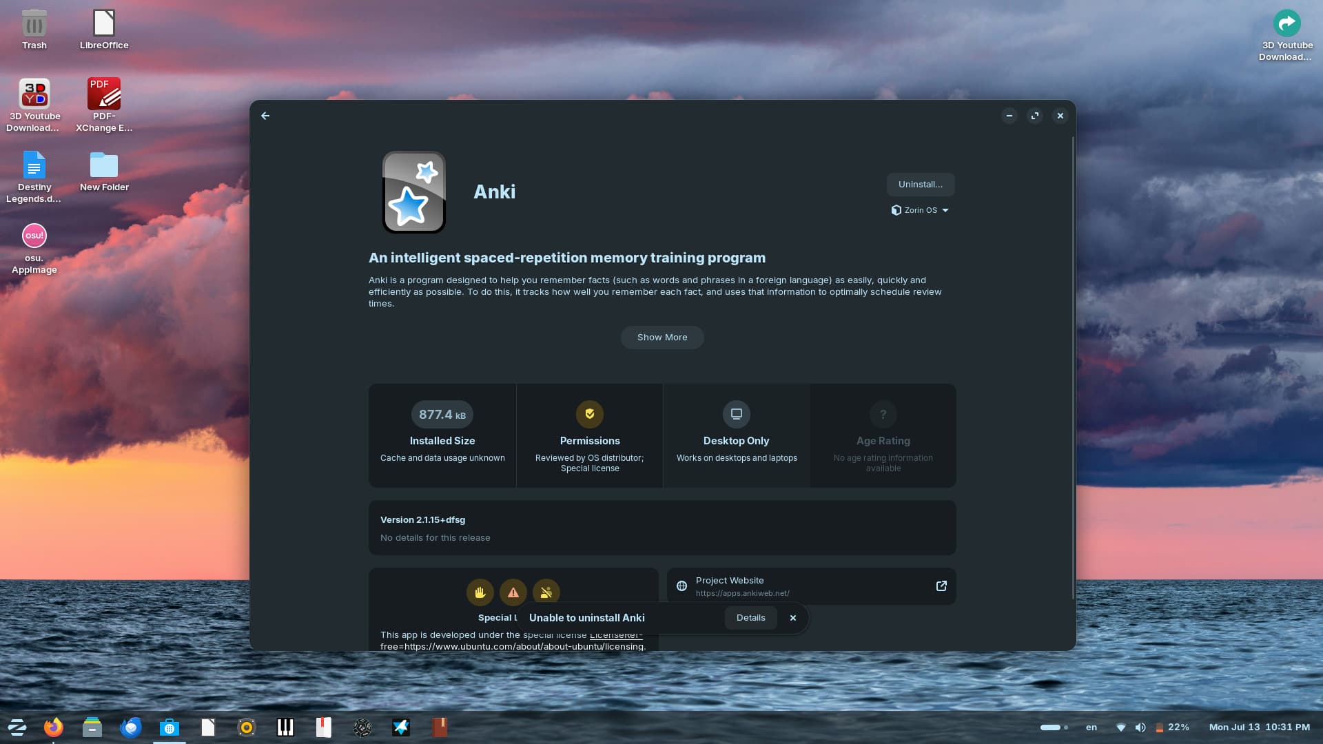

I've had to use the flatpak version but I am still wondering about it. Coincidentally yesterday I decided to try to install Zorin's APT of Anki and that didn't install either.
I reinstalled Anki today and everything seemed fine. The Brave browser is still acting the same (I'm referring to the Zorin apt not the flatpak).

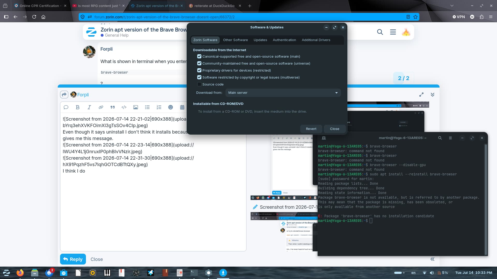

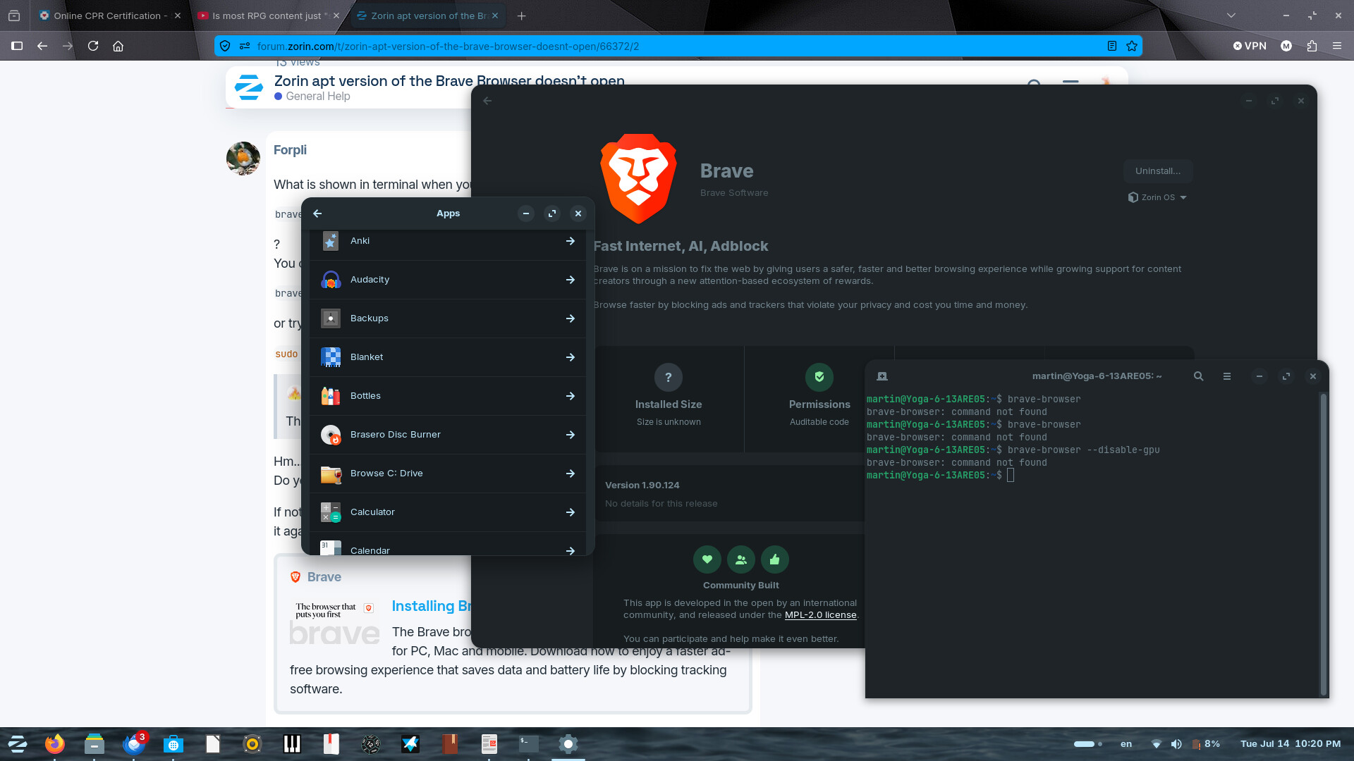

What is shown in terminal when you enter
brave-browser
You can try to launch brave-browser with disabled hardware acceleration
brave-browser --disable-gpu
or try to reinstall brave-browser
sudo apt install --reinstall brave-browser

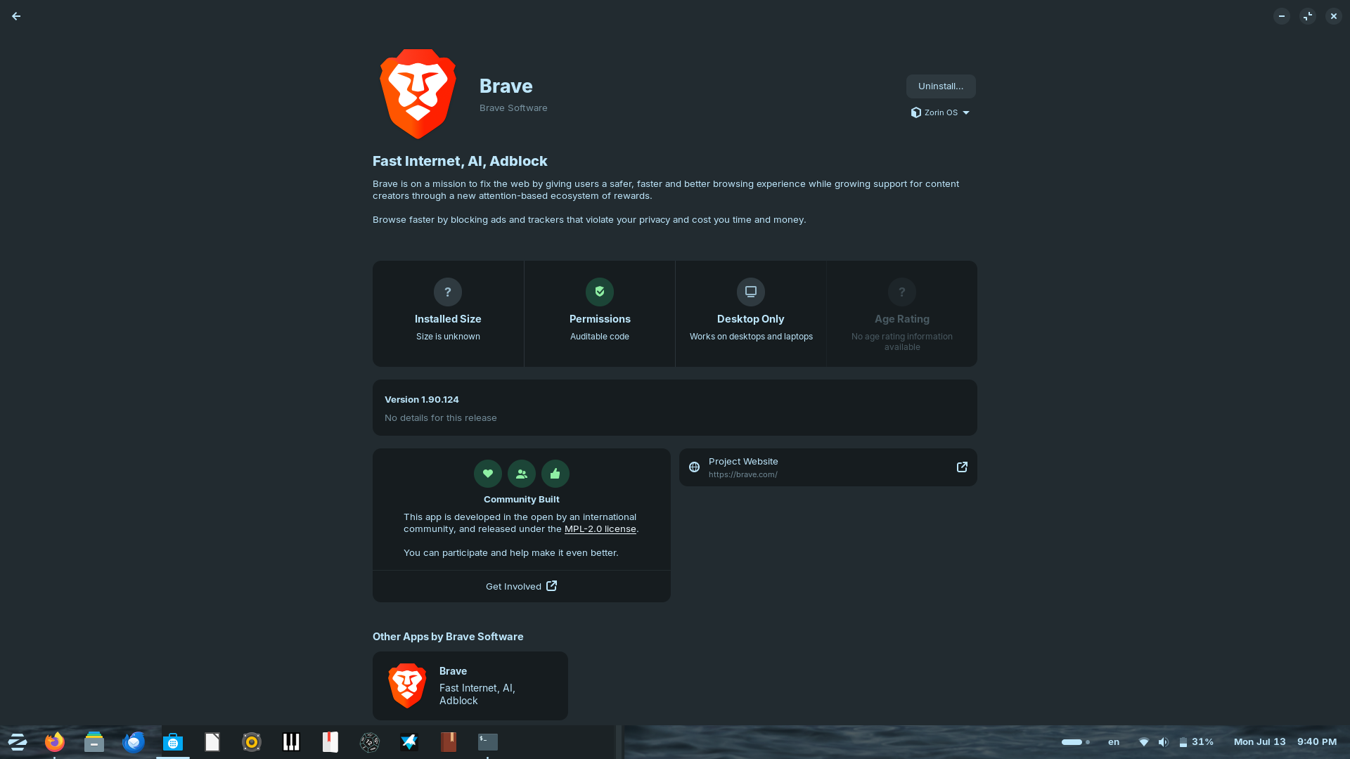

Even though it says uninstall I don't think it installs because when I try to uninstall it gives me this message.
I think I do
Okay, the brave-browser isn't installed as apt package. When you click on the arrow on the right side of Zorin-OS in the brave-browser window of gnome software center, then you see which packages are installed. Those which are installed have a :check_mark:.

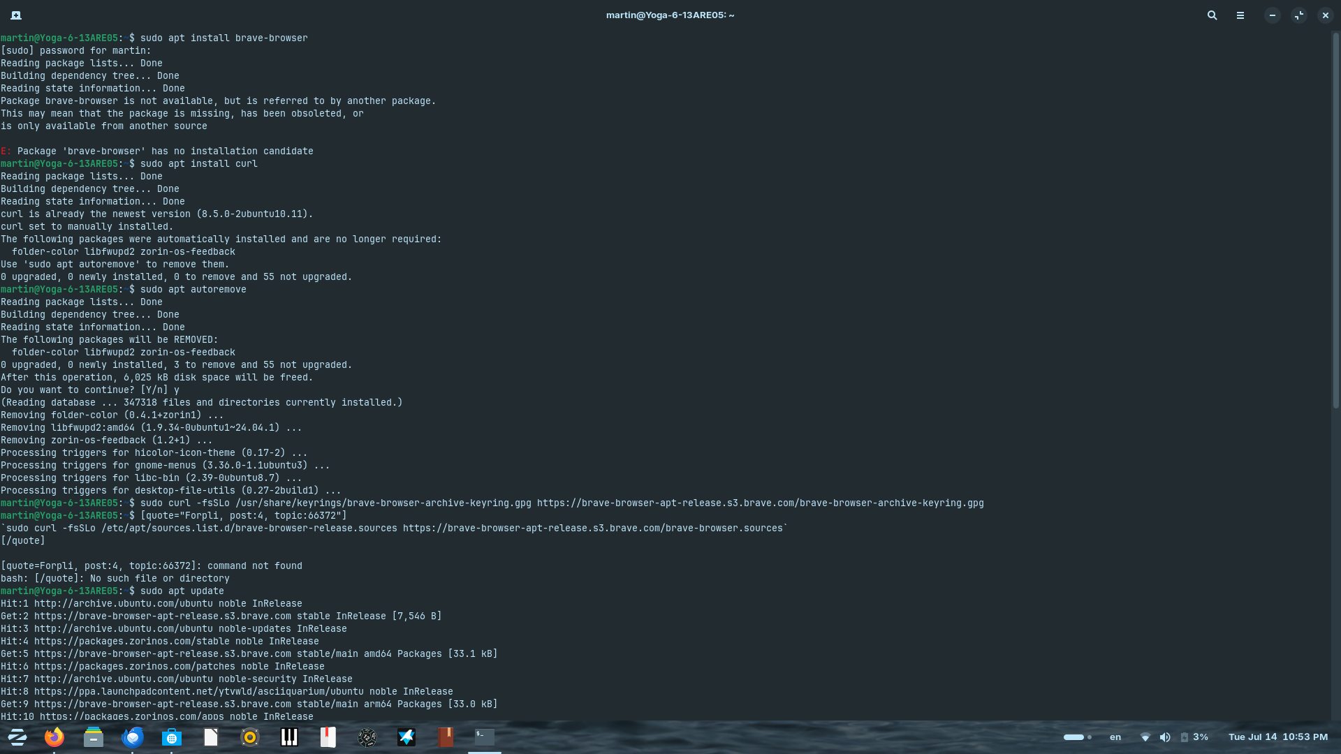

So try to install brave-browser:
sudo apt install brave-browser
When you get an error message (you can post the terminal output here), you probably have to add the brave repository first as shown in the link with
sudo apt install curl
sudo curl -fsSLo /usr/share/keyrings/brave-browser-archive-keyring.gpg https://brave-browser-apt-release.s3.brave.com/brave-browser-archive-keyring.gpg
sudo curl -fsSLo /etc/apt/sources.list.d/brave-browser-release.sources https://brave-browser-apt-release.s3.brave.com/brave-browser.sources
sudo apt update

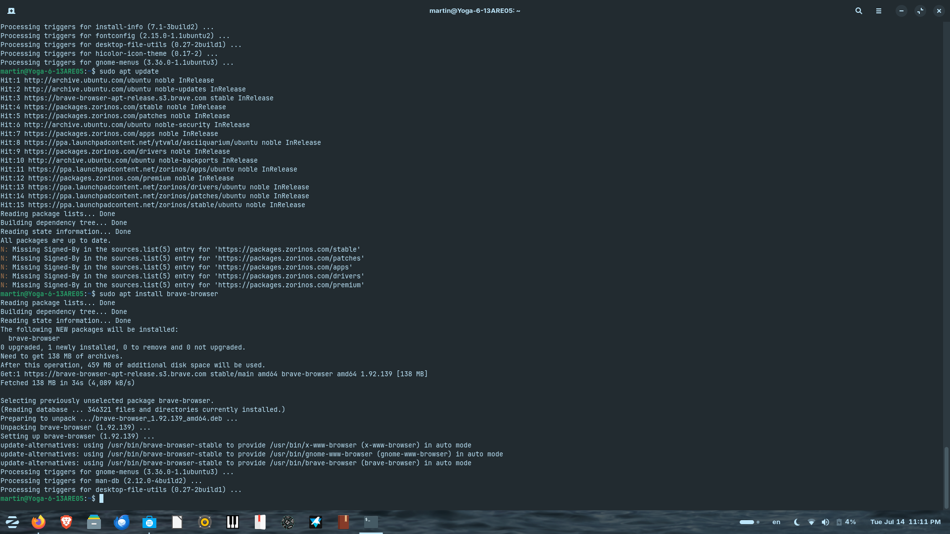

This is what I got
Repeat that command
and then
sudo apt update

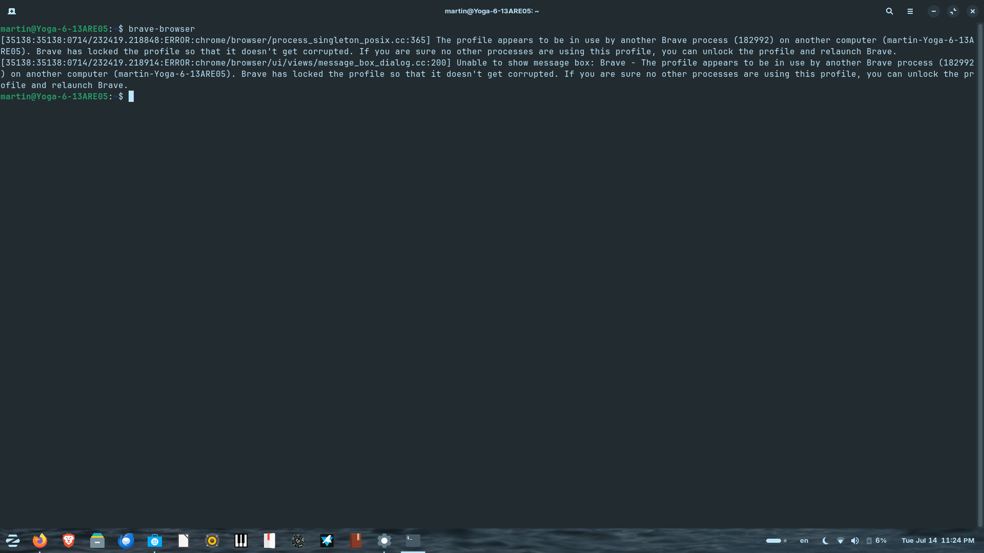

So it installed but it won't open
What is the terminal output of
brave-browser
Do you have running brave-browser in another package format as flatpak? Please quit it there and then try it again. Or do you have changed the hostname of the computer? That can also lead to the error that the profile is locked.
For your errors "missing signed by..." take a look at this thread:
Yes I did change the hostname sometime ago
Ah, then try that and delete all files with "singleton" in the name:
Press ctrl+h in your file manager to show the hidden files. Then go to the .config folder in your home directory.
Thank you very much! This has solved my issue! :+1:
