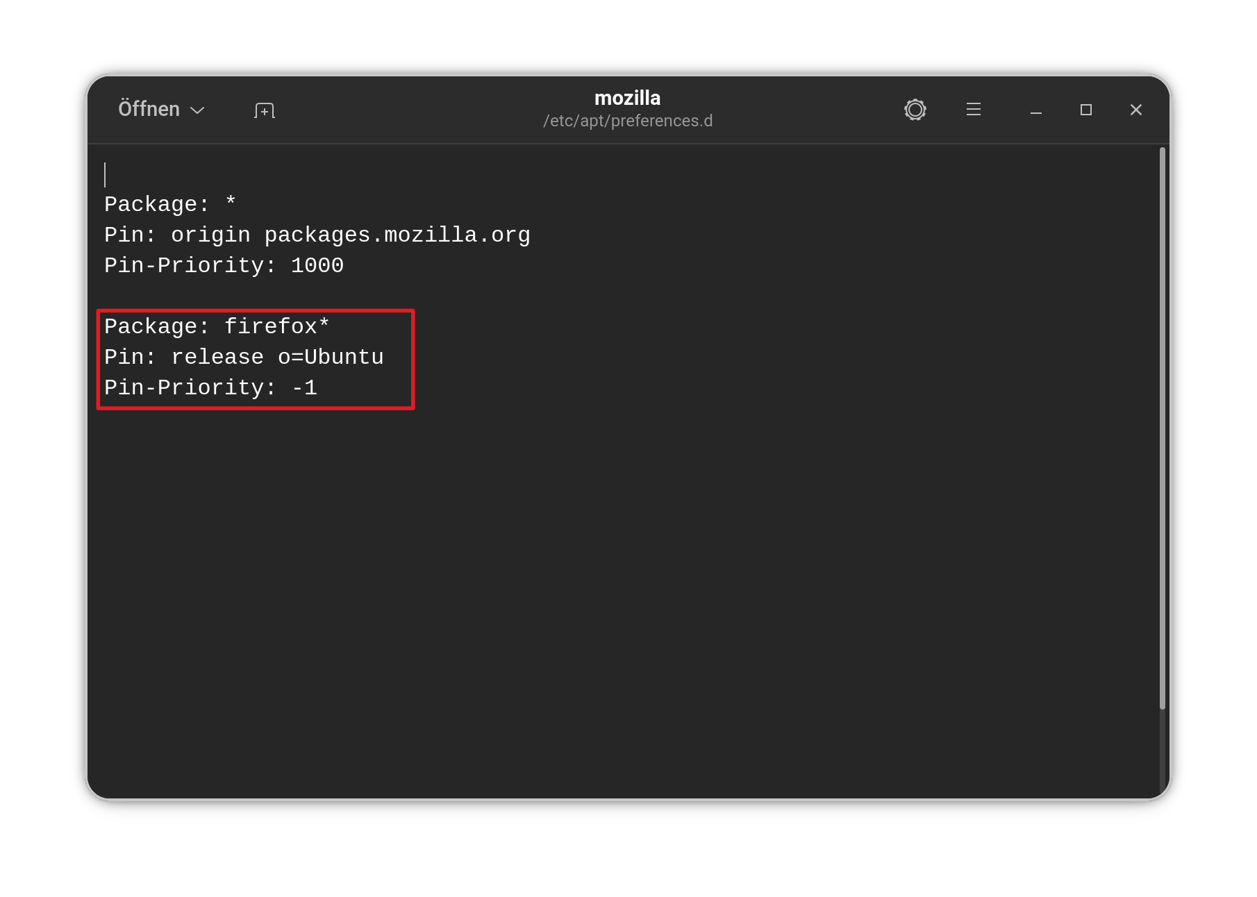

Yes, that is a known Problem. This is related to Ubuntu because Ubuntu itself doesn't offer an APT Version for Firefox. Only Snap. And they created a Redirect when You use the apt install Command to install the Snap Version.
On Zorin there should be a Redirect, too what would add the Mozilla-own Repo and then install the .deb Version of the Browser. With that, there should be landed a File in /etc/apt/preferences.d/ which is simply called mozilla. In this is set the Priority for the Mozilla Source.
To make that better, You can in this set down the Ubuntu Source. Type in Terminal:
sudo nano /etc/apt/preferences.d/mozilla
and in the upcoming Window add that:
The first Part is the default. The 2nd one lowers the Priority of the Ubuntu Source for Firefox. If the Changes are made, press ctrl+o to save, Enter to confirm and ctrl+x to exit. Back in the normal Terminal Overview type sudo apt update && sudo apt upgrade
Let's call this a solution. It hasn't installed snap firefox yet. but I guess I'll need to wait for an update to check.
