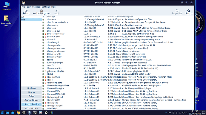

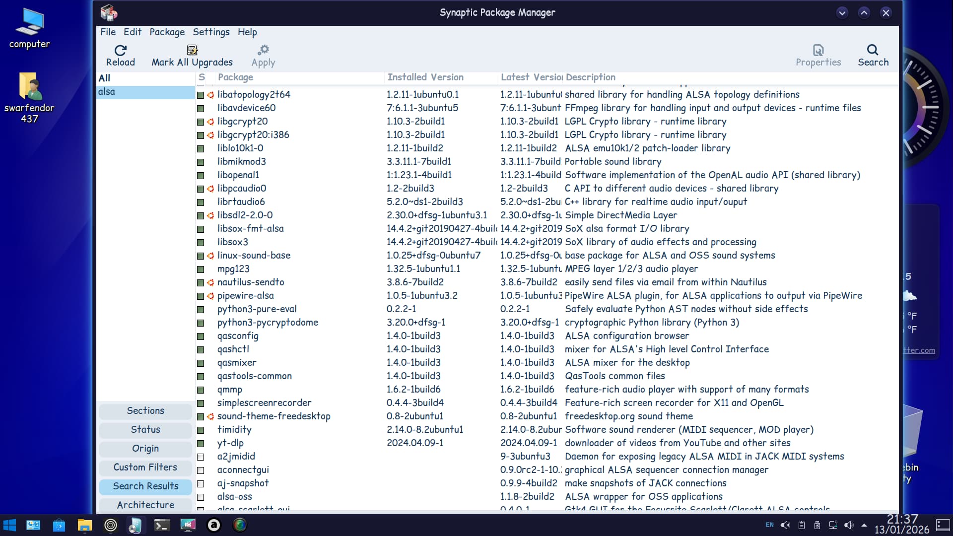

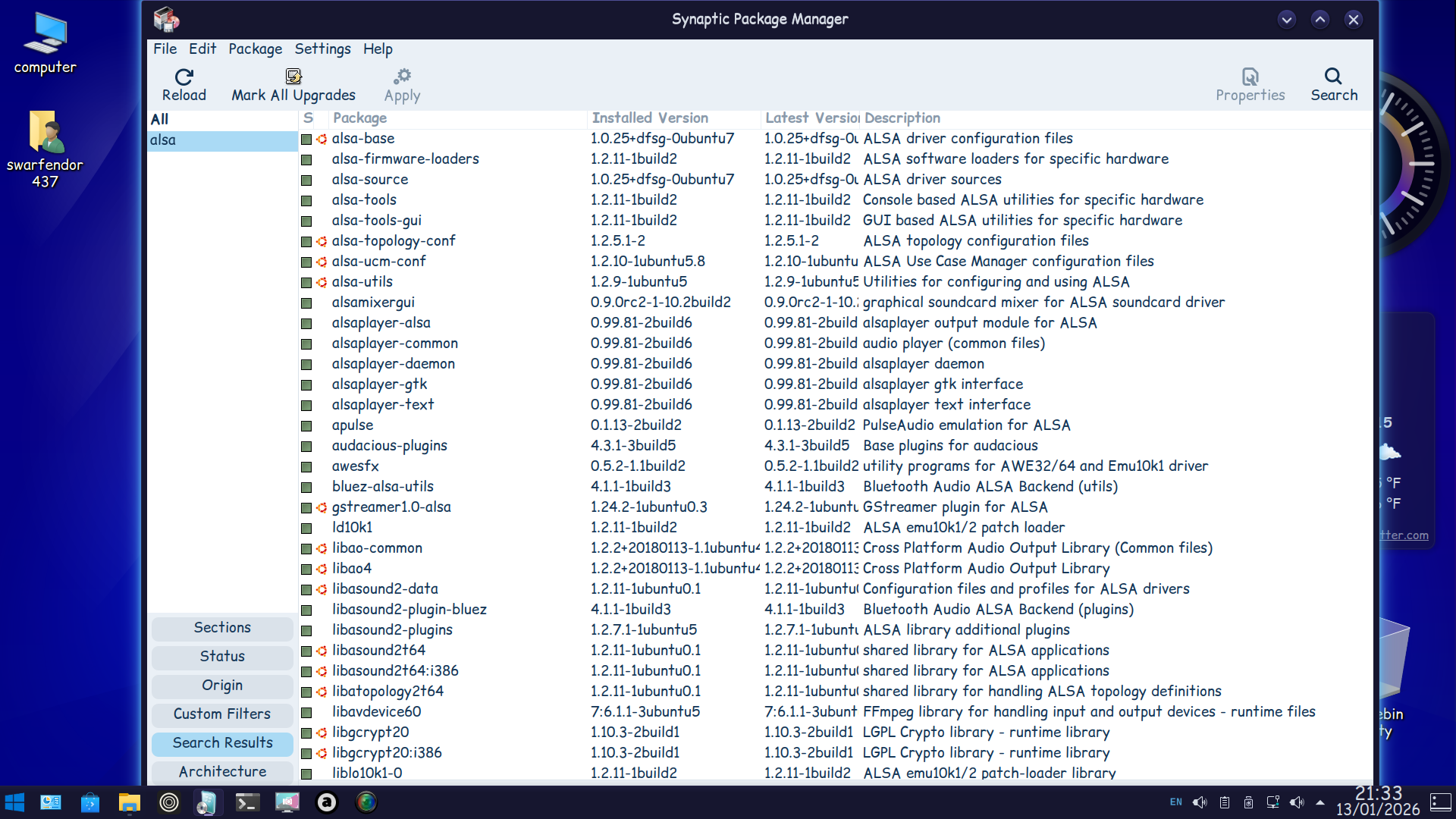

These are the ALSA packages I have installed - ignore the 'awesfx' and 'liblo10k1-O' as these are packages I needed for my Soundblaster Audio card to be present:

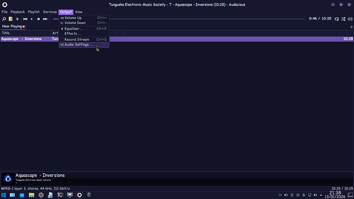

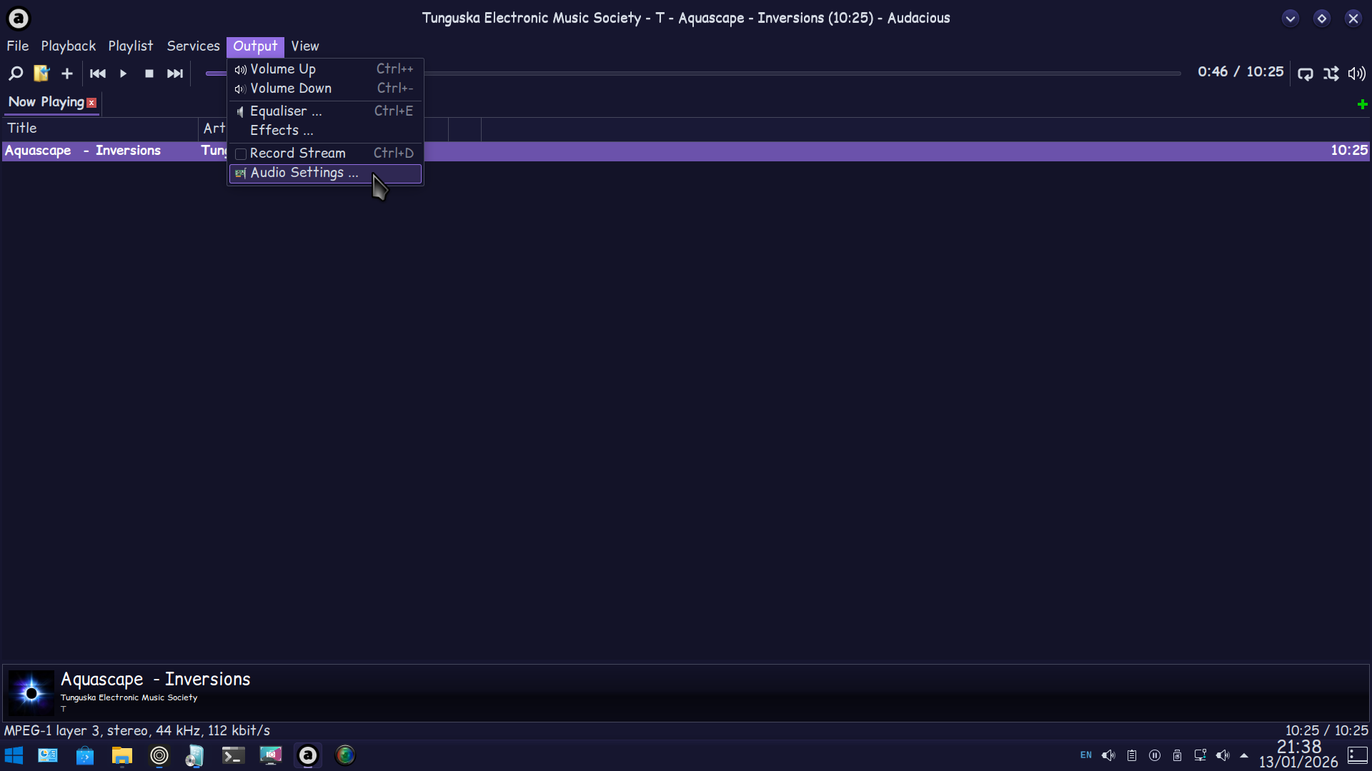

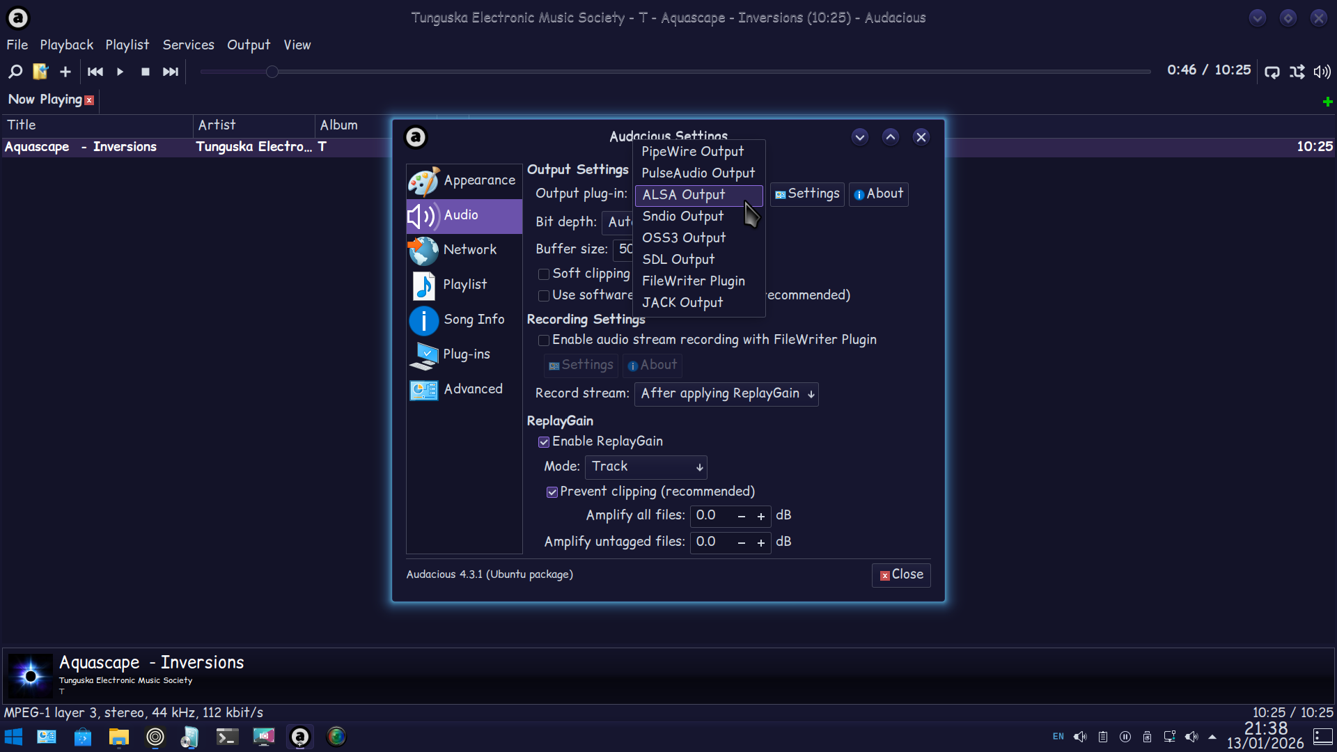

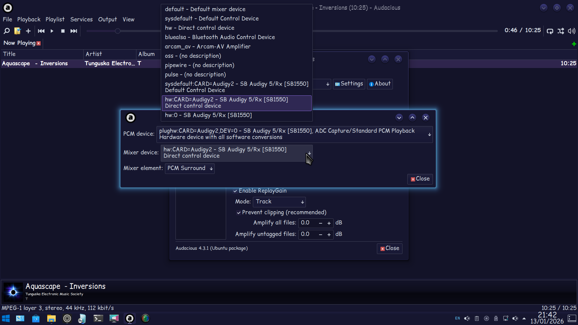

Audacious:

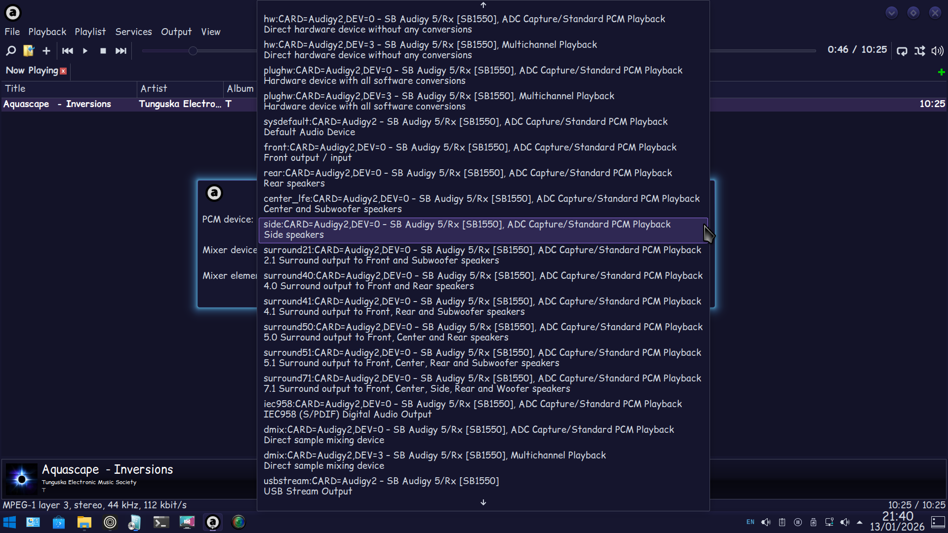

Use the drop-down arrow for the Audacious Settings and look for HDMI entries - there is usually more than one - I have blacklisted HDMI as it interferes with my Audigy card:

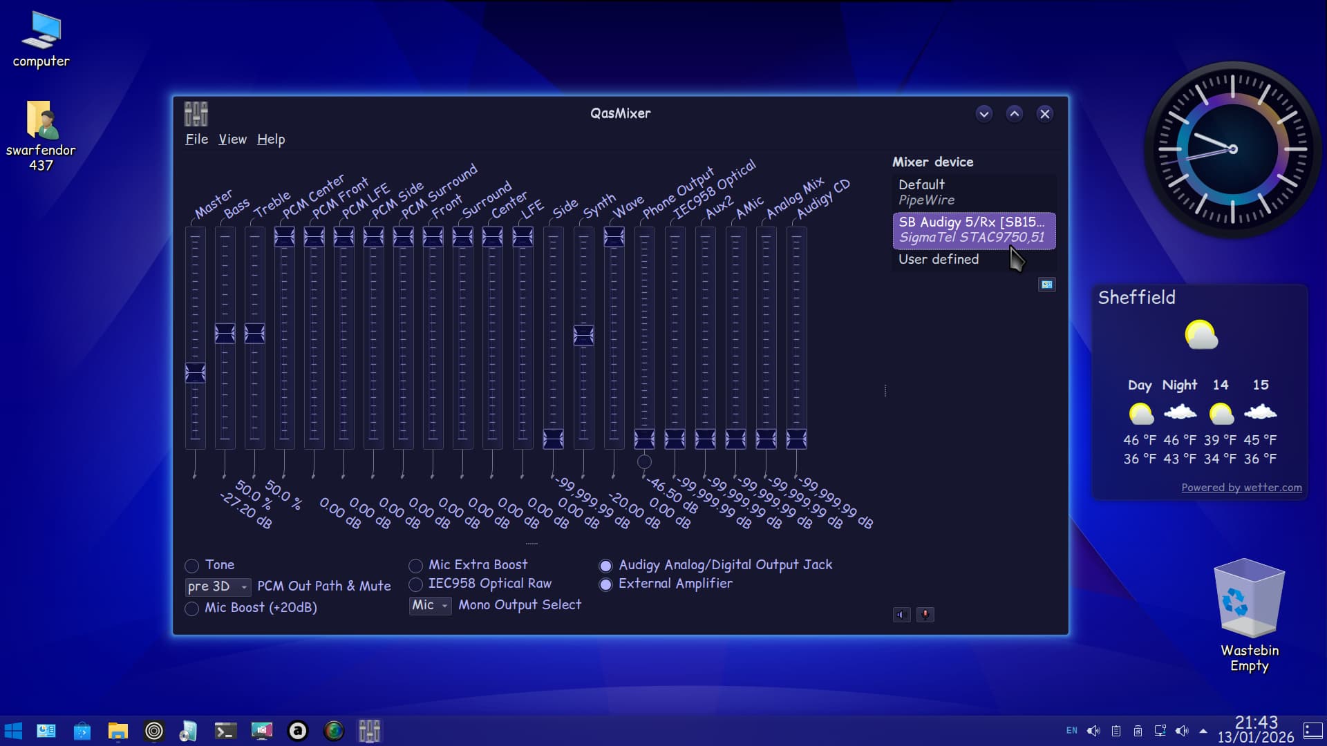

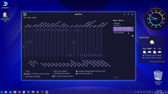

qasMixer:
You should see a 'card entry' for HDMI.
