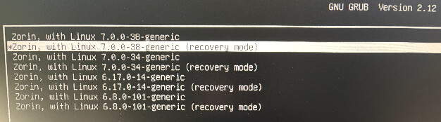

Grub appears, starts into Zorin, I get asked for my encryption password, it's doing the storage tests and then the Zorin logo appears and pulses forever. Waited for over half an hour, nothing changes, it's normally done in less than 5 seconds:
Then I tried more options and tried older kernel versions, same result. Loading into recovery mode (and normal boot after) works. The graphics driver aren't loading but the system starts and functions.

with this older linux-firmware set could you remove nomodeset parameter from grub and try to boot with older kernel now, like 7.0.0-34 ?
and also 6.17
but not with recovery mode option
It works!!
7.0.0-34 without nomodeset works again.
