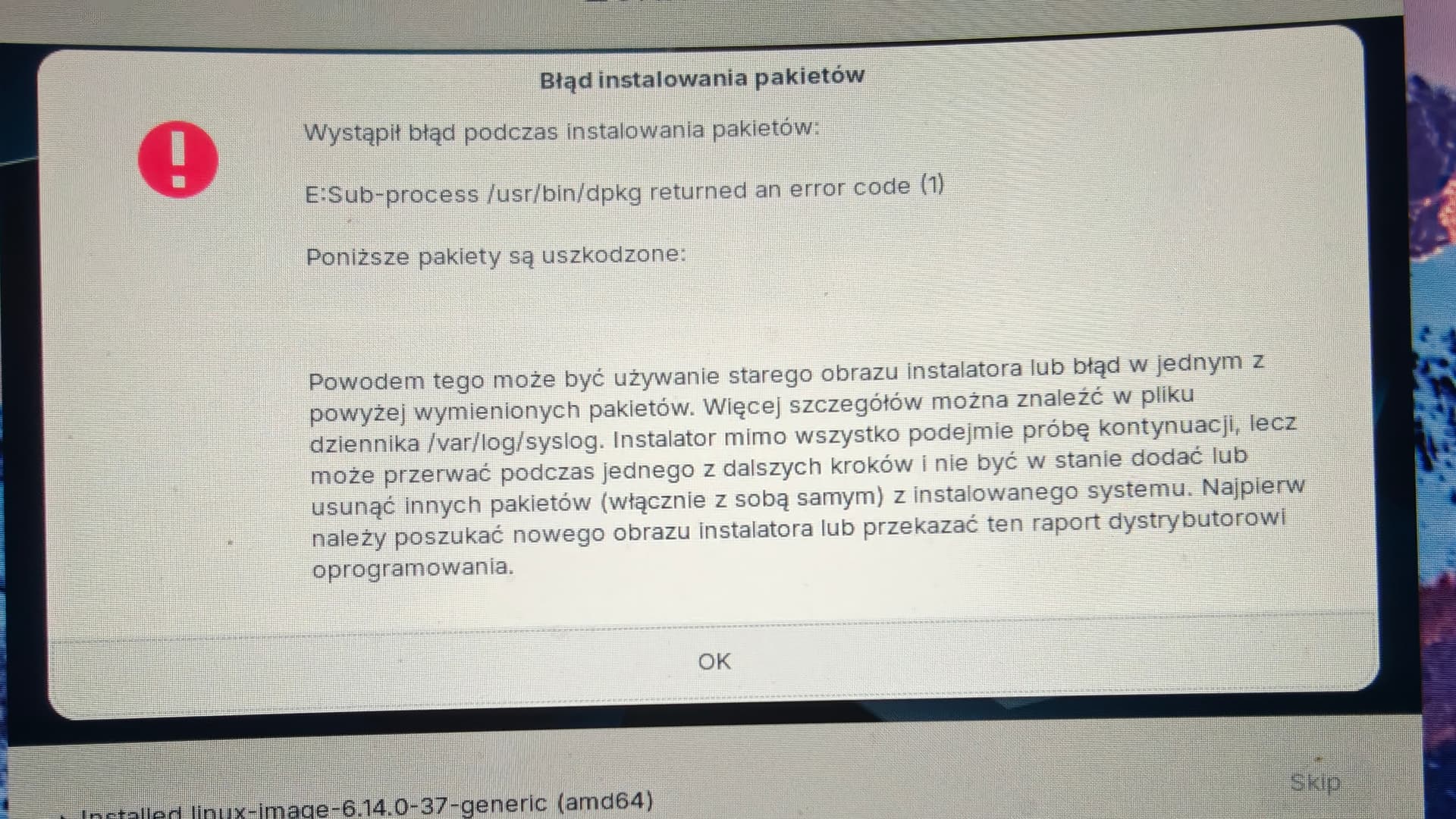

So as per instruction my fast start on windows is turned of, secure boot is off.
then i try installing zorin os alongside windows and i got an error, but it says that installer will try instaling zorin anyway.
but nothing happes, the dueal system boot does not appear.
I tried redownloding and redoing the boot device but still nothing.

Can you please take a photo of the error or do you know what the message of the error was?

The Zorin OS installer should run a diagnostic check when you first try to run it, and so in theory this shouldn't matter that much if everything goes well. However, Balena Etcher is known to have cause issues before, including breaking the USB device itself, so I'd suggest trying Rufus instead just to be on the safe side.

yes, and I even was able to select and format the partition.
this error is after files being copied or during the copy.
Did You installed it with an Internet Connection? If yes, try it offline.
ok first im trying rufus but i do use normal format - not the fast one.
then i tryinstalling it in offline
+1 to this!
So i did all of the above.
used rufus with full format the usb stick
didnt connect to the web
it worked. I am typing from Zorin OS.
