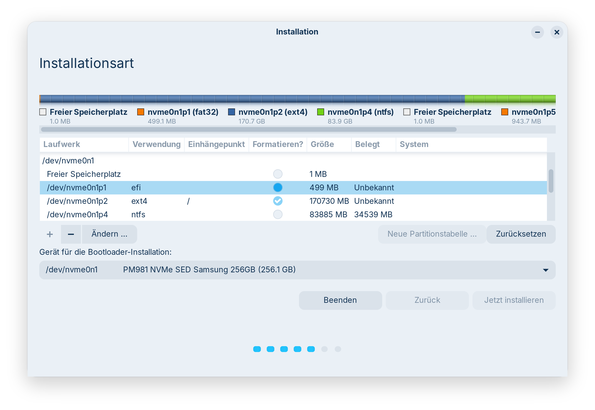

In the installer program I set a 500MB boot partition (/dev/nvme0n1p1) for FAT32 filesystem and wrote '/boot' as mount point, but in the selection field there was only shown /dos and /windows and no option for /boot.
The other partition (/dev/nvme0n1p2) is a 170GB partition for /. As place for the bootloader installation I set the entire nvme. But then I get an error when I clicked on install that the installation may fail because there is no efi partition.
Then I tried to change the boot partition from FAT32 to efi but formatting was greyed out and there is no mount point shown.

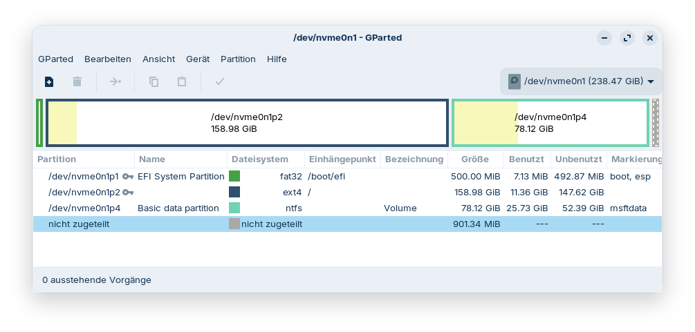

I created the two partitions in gparted but that made no difference. Then I simply clicked on install but without a mount point shown for the efi partition and set as place for the boot loader installation the first partition.

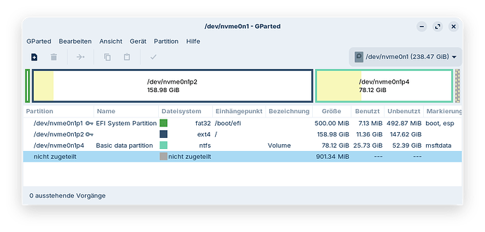

In gparted everything looks right after the installation:
Thank you very much for your help, @Nourpon and @Ponce-De-Leon!
