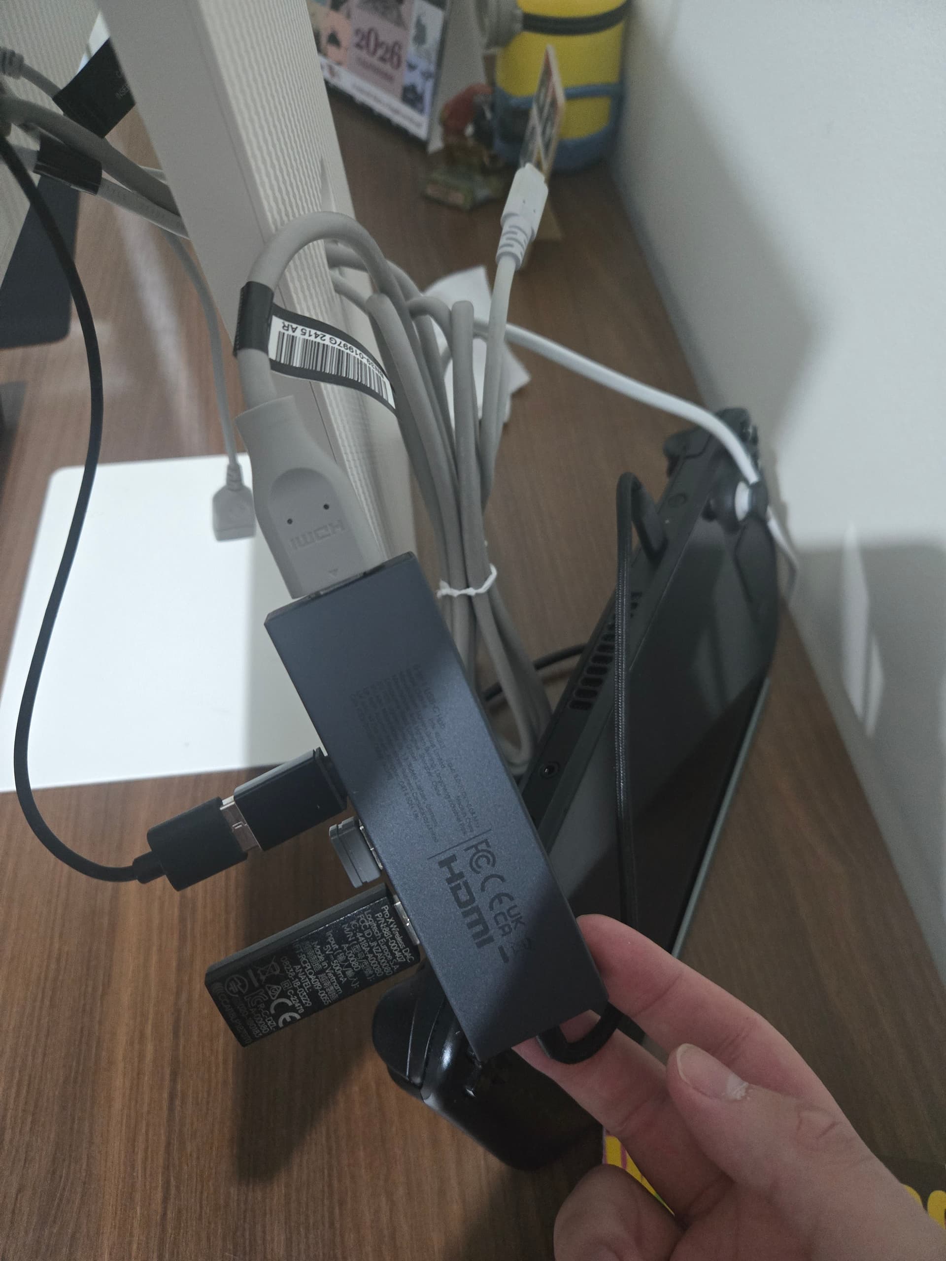

Its like the image, as it has always been this way. If i plug directly to my usbc it works as intended, but then i cant connect my mouse, keyboard, etc
Now, its connected through a HDMI. The conection is identical. Actualy, the issue started not after a fresh restart. Suddenly the resolution was 1080p and i was like... "wtf?". I restarted my SD and then i got this problem. So maybe it started while it was on. In case its relevant, i had the same issue with bazzite, but it dissapeared after a fresh restart.
Usually, those kinds of devices are powered, not simple pass through, as power is generally required, to do the handshake. Maybe try another one of those devices, that require wall power.
