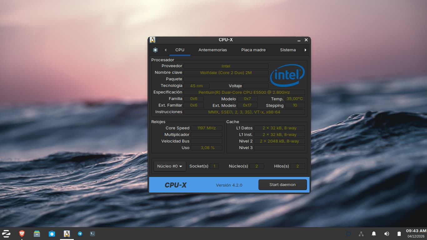

Can you please tell us the make and model of the PC? If you know which sound card it has, then please tell us that information.

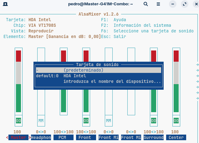

In Alsamixer hit F6 to list soundcard/s. Post a screenshot here.

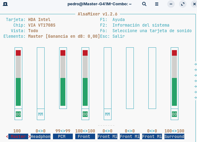

In alsamixer hit F5 to display All sound channels. Post a screenshot here.
If it's a 3.5mm jack connector, it's an Intel Pentium 4 desktop PC, and I'm attaching the screenshots. Thanks for your help.
In alsamixer, try unmuting the [Headphone] channel by using arrow keys to select it, then type "M" to unmute. Increase the volume level using the up arrow key.
