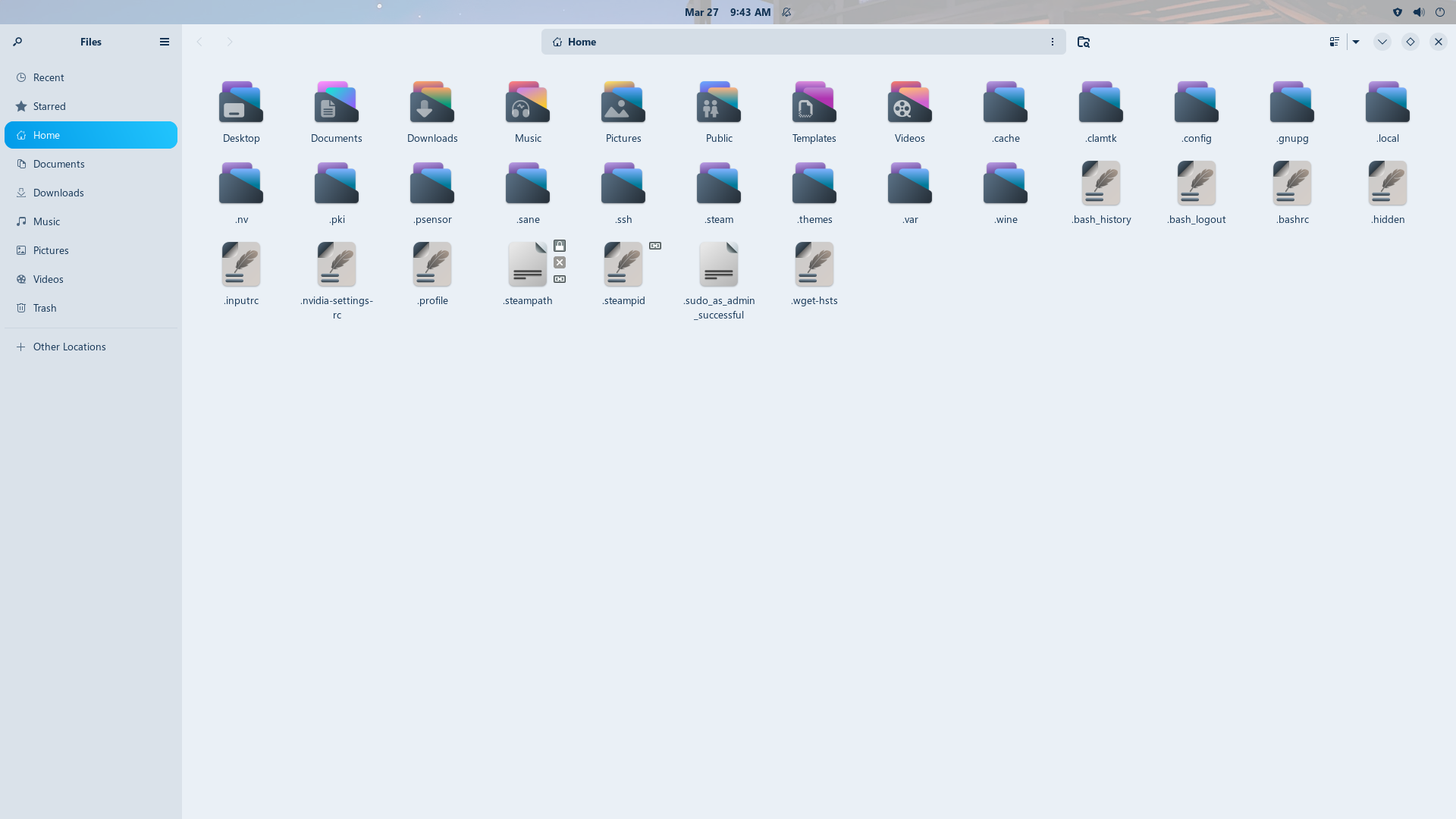

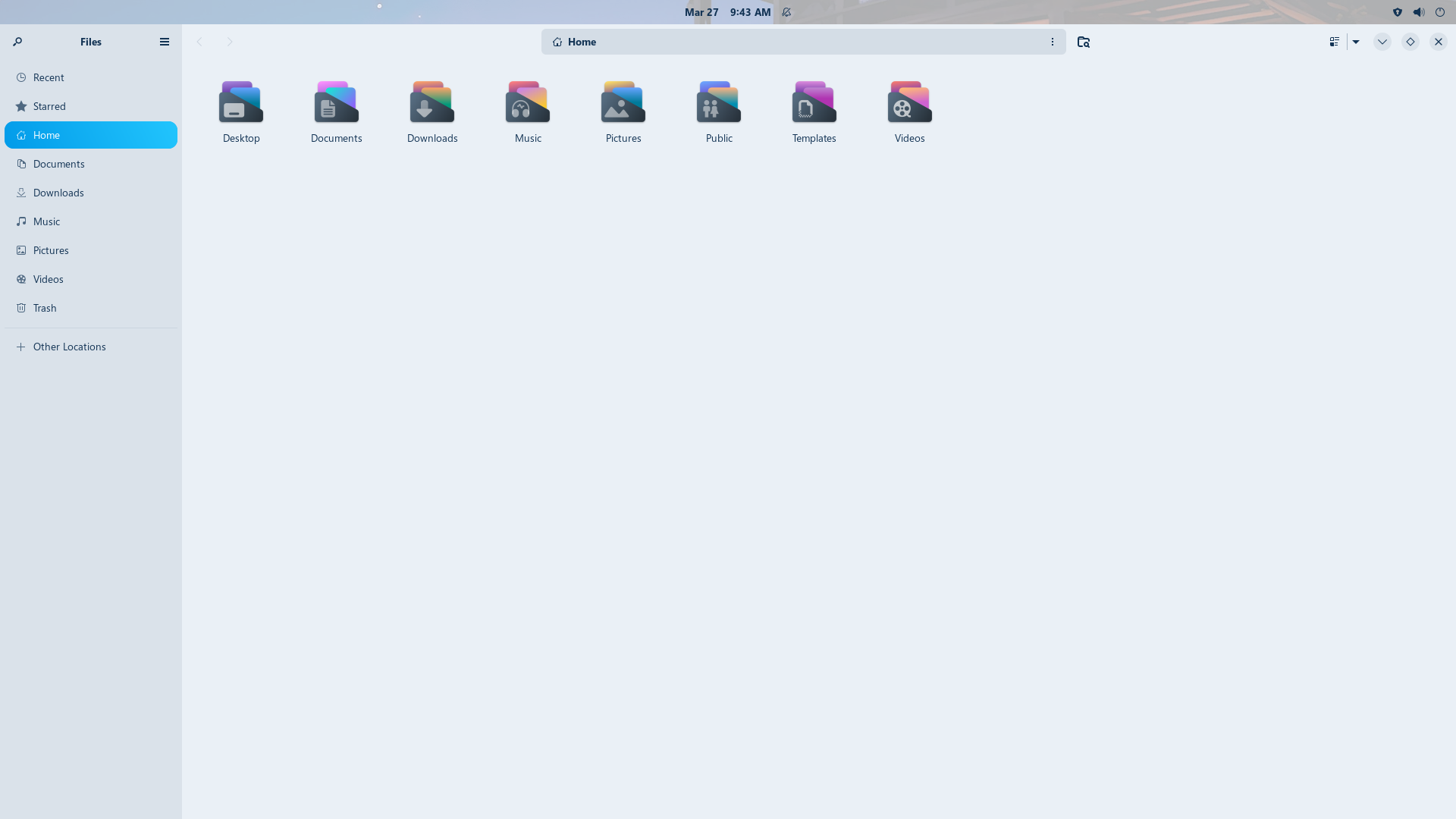

Agreed...there is more to the Home folder then appears to the eye hitting the control+h will show the hidden folders which like windows(sorta) are where the files are for system use.. moving the home folder would be like moving the registry in windows same result system wont boot cause it cant find what it needs sounds like a learning thing there...a reinstall will be way quicker
home normal
after using contl+h
