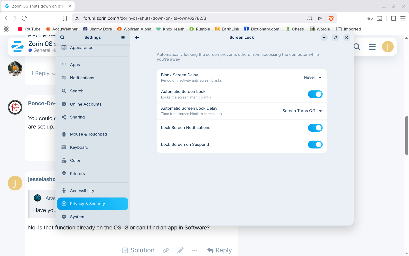

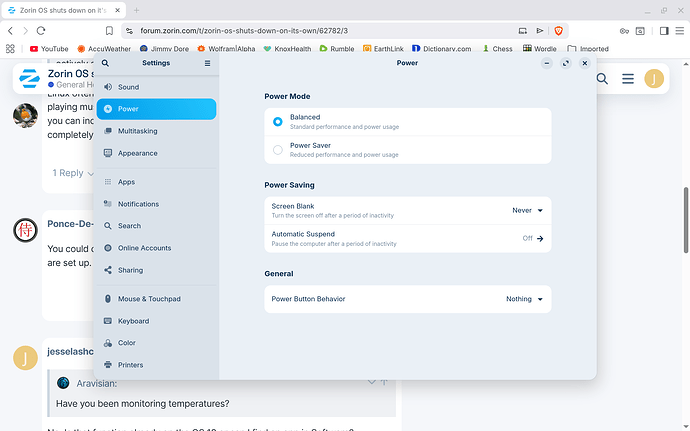

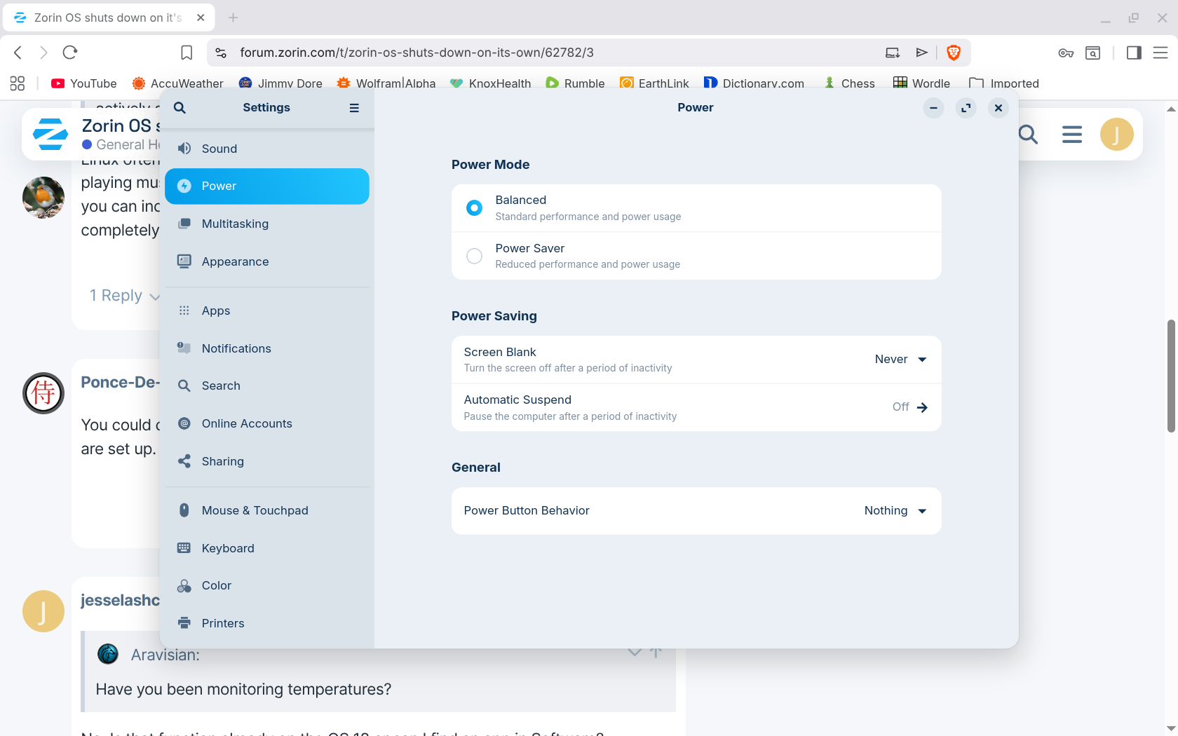

You could check Settings>Power and Settings>Privacy>Lock Screen for how they are set up. Maybe make some Screenshots and share it here.

Okay, that looks okay. And these Settings were like this, yes? You didn't changed them now?
It does sound like the system is auto locking itself, based on a timer running out, of perceived inactivity. Generally, if the system locks itself, you will then be on the lockscreen. (What you call startup screen)
Real quick, in your system settings, make sure your blank screen is set to "never." Unless your on a notebook and wish to preserve battery, set "automatic suspend" to "never."

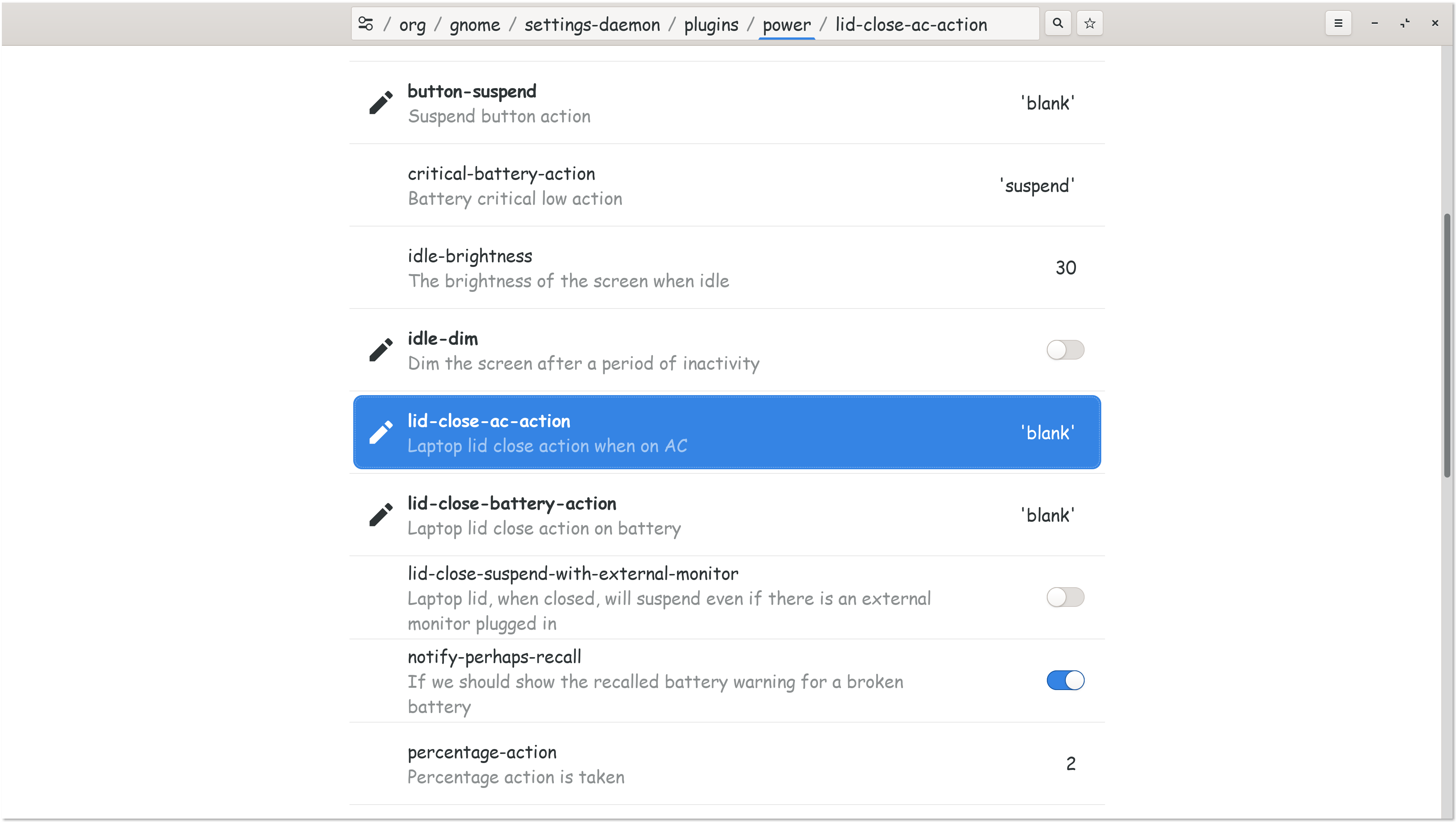

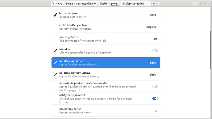

Further power saving options can be found in Dconf editor.
Setting power options to "blank," disables them.

Yes, that's right.

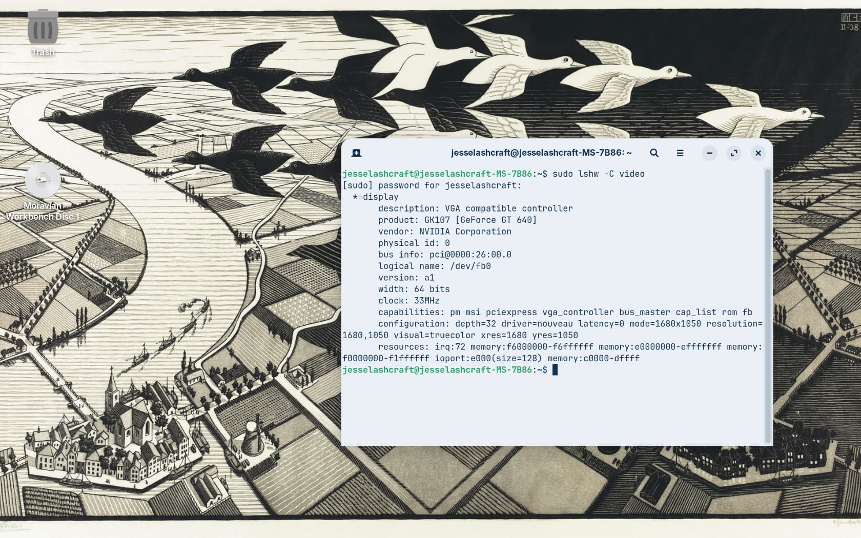

What GPU are you using?
I'll need some help finding this information.
You can open a terminal to make this easy from the app menu or using keyboard shortcut ctl+alt+t
Then paste in for GPU:
sudo lshw -C video
and for the Display Protocol (Wayland or Xorg. Xorg will show as "X11"):
echo $XDG_SESSION_TYPE
It's a Wayland.

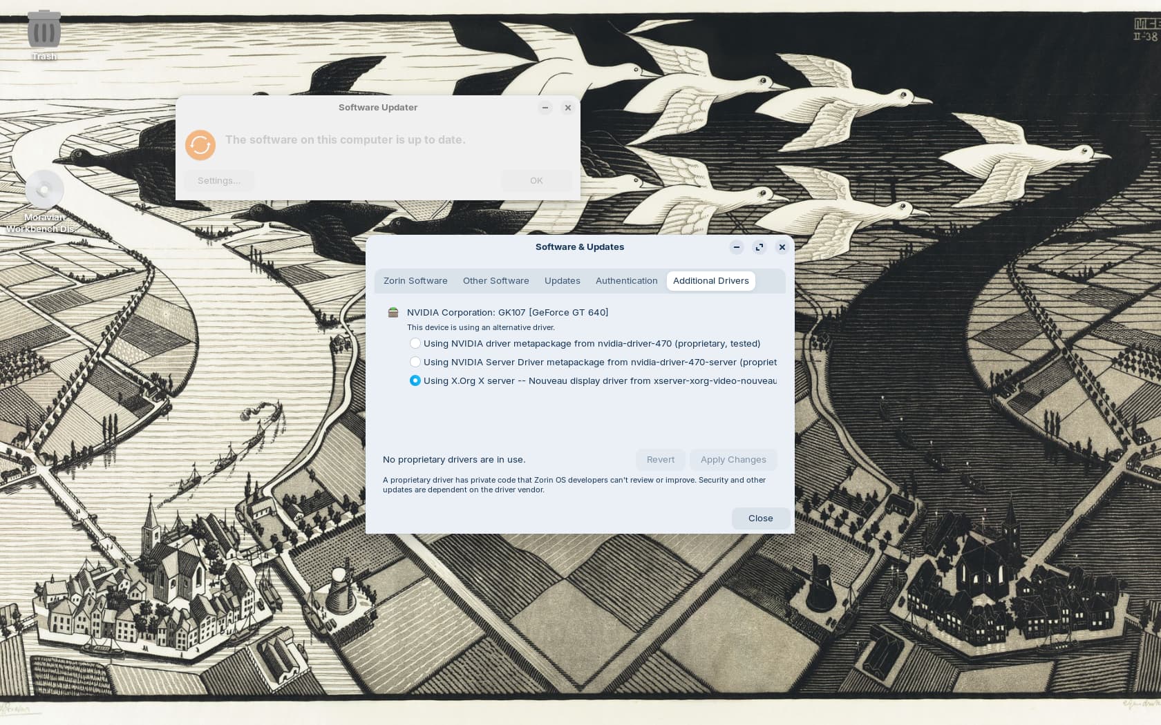

Have you ever used a proprietary nvidia driver on your computer in Linux? Do you want to use the proprietary drivers? They get no updates.
At the moment you are running the open source driver nouveau. There are more proven options to install nvidia driver 390 in Zorin 17 than in Zorin 18. So if you would like to use them, I'd suggest to stay with Zorin 17. It is still supported.
But test if Nouveau works well when you switch to XOrg. I myself also use Nouveau and have no problems while watching videos (at the moment running Zorin 17 Lite).
