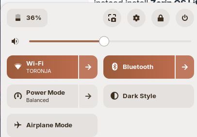

Can you setup Lite to have a settings bar similar to the one provided in Core?
I would ask what you mean by "Similar"?
In functionality - Yes. Would it look like that, no.
But if you want a very similar look on top of that function - Yes if you install Rofi, which can do that quite well.
NOTE: Rofi is not a desktop environment - it is an addon you can install for use On Zorin OS Lite.
