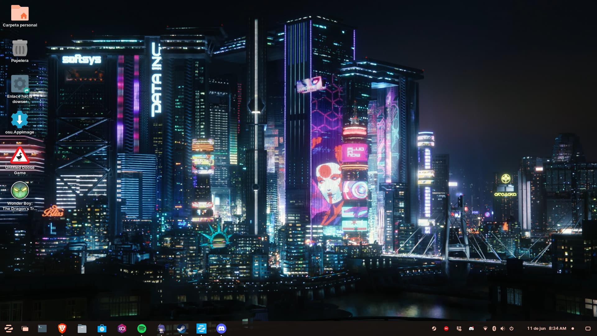

Hi, I recently changed my monitor, turned it on and tested it, and it went very well.
I turned off my computer, but when I turned it back on I ran into a problem, the taskbar was not there, the classic Gnome environment was activated, I checked Zorin appearances and it was activated, but then I went to the extensions and I saw this error:
help please

yes it worked : D
