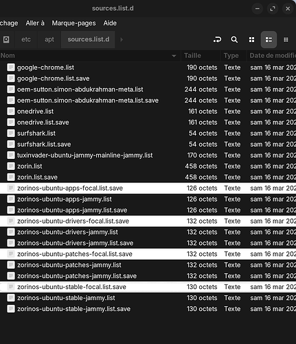

With the tuxinvader Redo is it interesting because on this Picture:
There is to see that You have the tuxinvader ubuntu jammy Repo. But on the Output the tuxinvader focal Repo is to see but not in sources.list.d ...
To change sources from Focal to Jammy after upgrading from Zorin OS 16 to Zorin OS 17:
I already do this. But there are no changes at all.
Yes, that is right. After this make a sudo apt update && sudo apt upgrade and then look what Output do You get. Another Thing that you could control is the zorin.list File if there are only jammy Stuff is.
