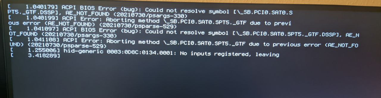

On the second boot I get the following error:
Since this is my second boot on linux, I don't really know where to start from analyzing the problem or even trying to fix it.

None of these warning messages can relate to a No - Boot situation.
Are you able to Boot into Zorin OS? Does it take longer than expected to boot Zorin OS?
If unable to boot at all, it is likely due to a different issue not shown in that screen.
After that screen it went to an permanent underscore -> "_" and stayed there. I was waiting at least 10 minutes, but nothing changed.
2nd install works now, but it still prompts the message at boot but continuous to complete the boot process which it was doing on first install as it was stuck at the '_'-Screen.
Problem solved by just reinstalling.
