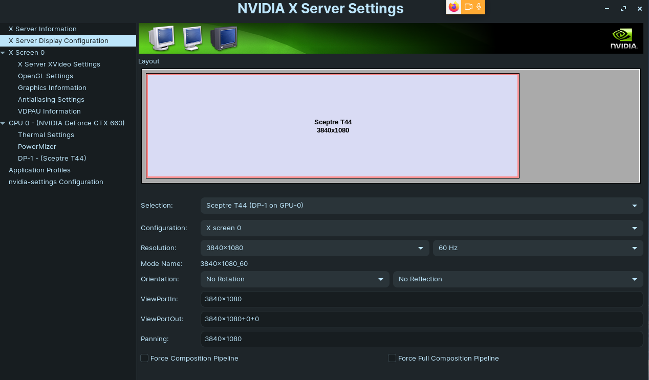

Can you open Nvidia Xserver settings and see if you can change the resolution there?

changing the settings from nvidia x server has the same effect as changing from zorin's built-in display settings
This?

Yes this is what I have been using
