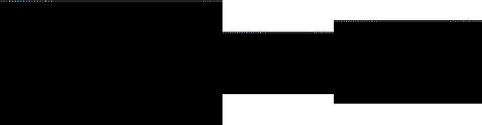

That's when I have everything connected (also what I noticed, if I'm already running a session and connect TV hdmi and then turn it on, I'm losing my desktop background image - attaching screenshot below):
