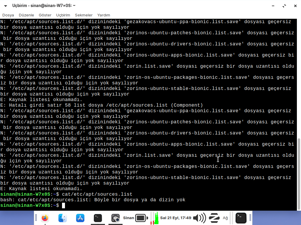

dude i try sudo but I cant download anything.
What is the output from terminal of:
cat /etc/apt/sources.list
bash: cat/etc/apt/sources.list : No such file or directory
Where id you download your copy of Zorin OS from?
Did you check the file 256SHA?
Your copy of Zorin OS is broken. I can only suggest re-installation of the operating system.
dude such a thing is impossible because downloaded from official site.
Oh I see what happened. Thanks for the screenshot.
There needs to be a (Space) between cat and /etc
