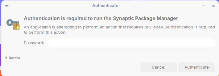

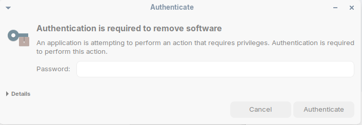

However, editing this file only eliminates the need to enter the password in the terminal. If you want to install/remove software via graphical programs such as Gnome Software or Synaptic or when you want to update programs via software updater, you will still be asked for a password. These queries of GUI apps would then have to be deactivated separately via polkit.

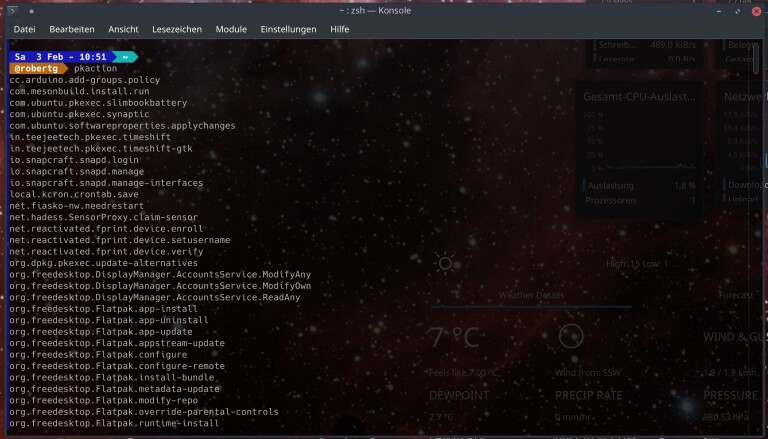

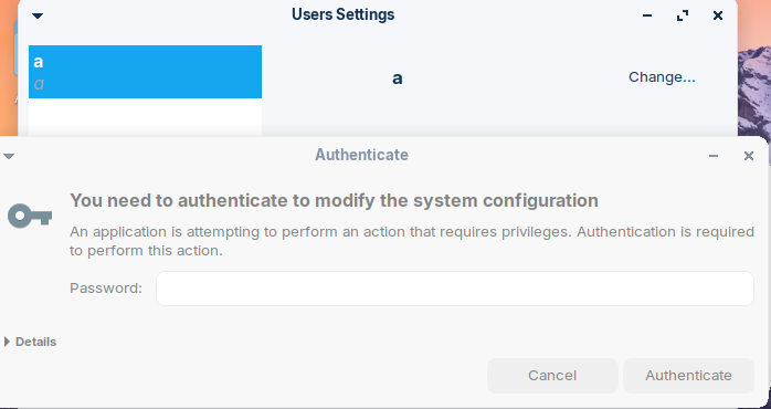

With these gui apps, access is not controlled via sudo but via policykit (pkexec).
I have found another guide here
, but I am not sure if it works in ubuntu 22.04 and I have no access to my PC at the moment. Unfortunately the posts are pretty old, but perhaps you can find some informations.
https://askubuntu.com/questions/383747/how-to-configure-pkexec-to-not-ask-for-password
https://askubuntu.com/questions/98006/how-do-i-prevent-policykit-from-asking-for-a-password
Please note that you cannot adopt the suggestions in the links 1:1, as some of them refer to older Ubuntu versions and some of them are outdated. Nevertheless, it may help you to find a solution.
For future (Zorin 18), perhaps you can adapt it to work now:
In Zorin 17.3 (ubuntu 22.04) you need to create a .pkla file, in newer versions like ubuntu 24.04 there are rules files.

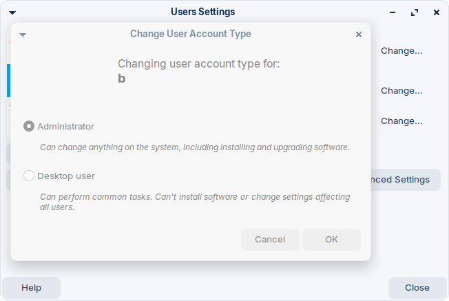

Next is right in my Zorin Settings:
And a quick search online for "admin user in linux" shows it's a common term. It appears to be mainly users who are granted added to the "sudo" group.
