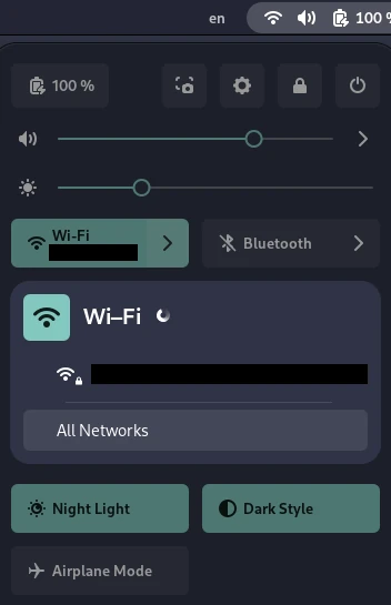

In any case, the refresh button would be welcome. I've noticed in recent versions of Gnome that when you open the settings menu there's a loading indicator:
But sometimes it loads for an unusually long time and it's a bit frustrating when you need to switch to another network. For example when I'm right in the middle between two strong signals and I need to switch to another one....
In the meanwhile, a workaround is disabling and enabling Wi-Fi whenever you want to switch to a better connection. You turn off Wi-Fi and then turn it on once you enabled your mobile hotspot, this way you make a kind of manual refresh and you'll connect to the best connection available that you already connected to previously in possibly fewer time than waiting. Not so “smart” though, it's quite weird, I know :grin:. We need to know a command to enter or file to edit to change the actual Wi-Fi refresh rate to a custom one, this would do the trick.
