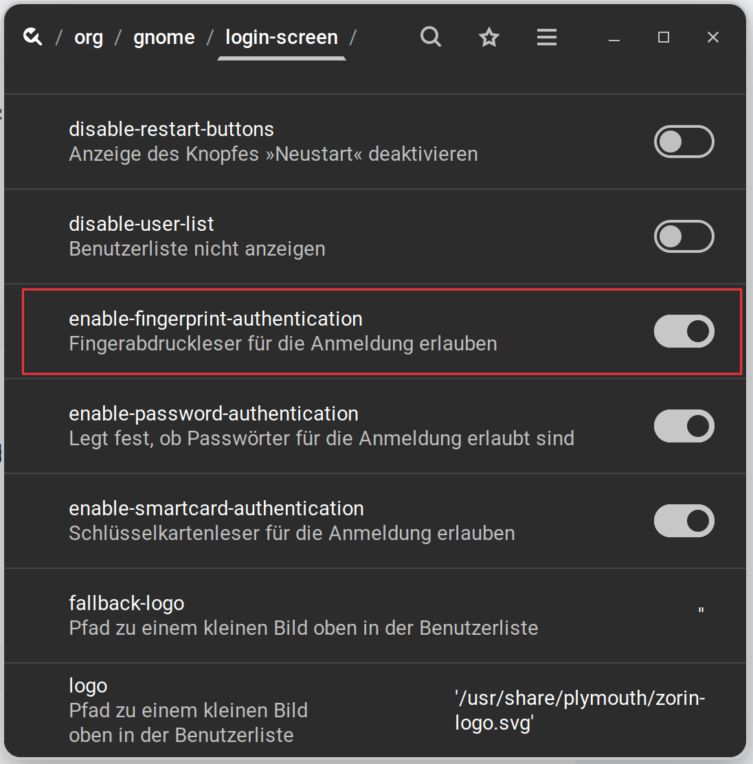

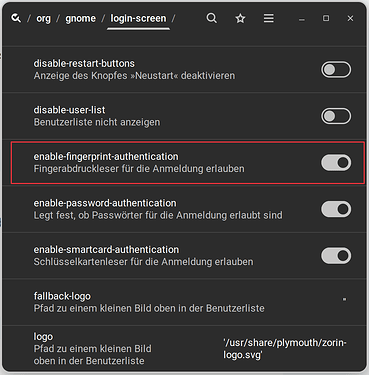

You could try it with the dconf editor. You can install it with sudo apt install dconf-editor and then open it and go to org>gnome>login-screen and there is a toggle to active Fingerprint for login:
The only downside with that approach is that you'd have to disable it again every time you turn off your computer (otherwise it stays on).

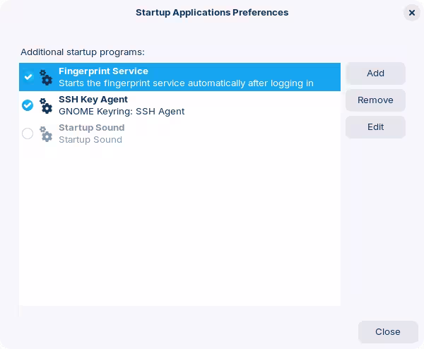

Another option is to run a command automatically when you log in. This can be easily done, but activating background services requires elevated permissions so you'd be prompted for a password again as soon as you log in.
To achieve this, you need to create a new file inside the directory ~/.config/autostart. The name does not matter, as long as it ends with a .desktop extension.
Note that files and folders starting with a dot (.) are hidden by default; press Ctrl+H in the file manager to toggle this view.
The contents of this file should be as follows:
[Desktop Entry]
Type=Application
Exec=/bin/bash -c "sudo /usr/bin/systemctl start fprintd"
Terminal=false
Name=Fingerprint Service
Comment=Starts the fingerprint service automatically after logging in
This will create a new entry available to enable inside "Startup Applications":
