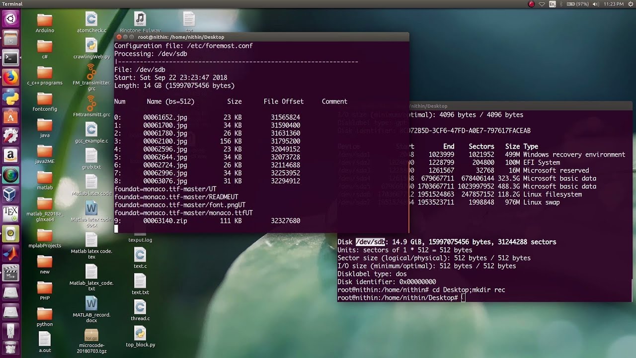

Thank you to everyone who took the time to respond to me! I managed to recover all mt lost data from the hdd with the help of this video:
And I'll be formatting the drive soon and hopefully it will be usable.
If anyone else is having the same or similar problems, I hope this helps!
