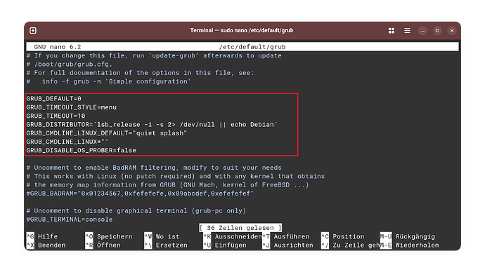

In the linked thread is linked a guide from Aravisian "[How to] add a kernel parameter".
Follow the steps there.
The file looks similar to this (Ponce-De-Leon, I took a screenshot from you)
Change the line
to
GRUB_CMDLINE_LINUX_DEFAULT="quiet splash acpi=force"
save the file and then run
sudo update-grub
and reboot.
If it doesn't help remove acpi=force and try it with acpi=off instead at the same place.
I already did, but still having the same issue.
It is important to run sudo update-grub afterwards to apply the changes.

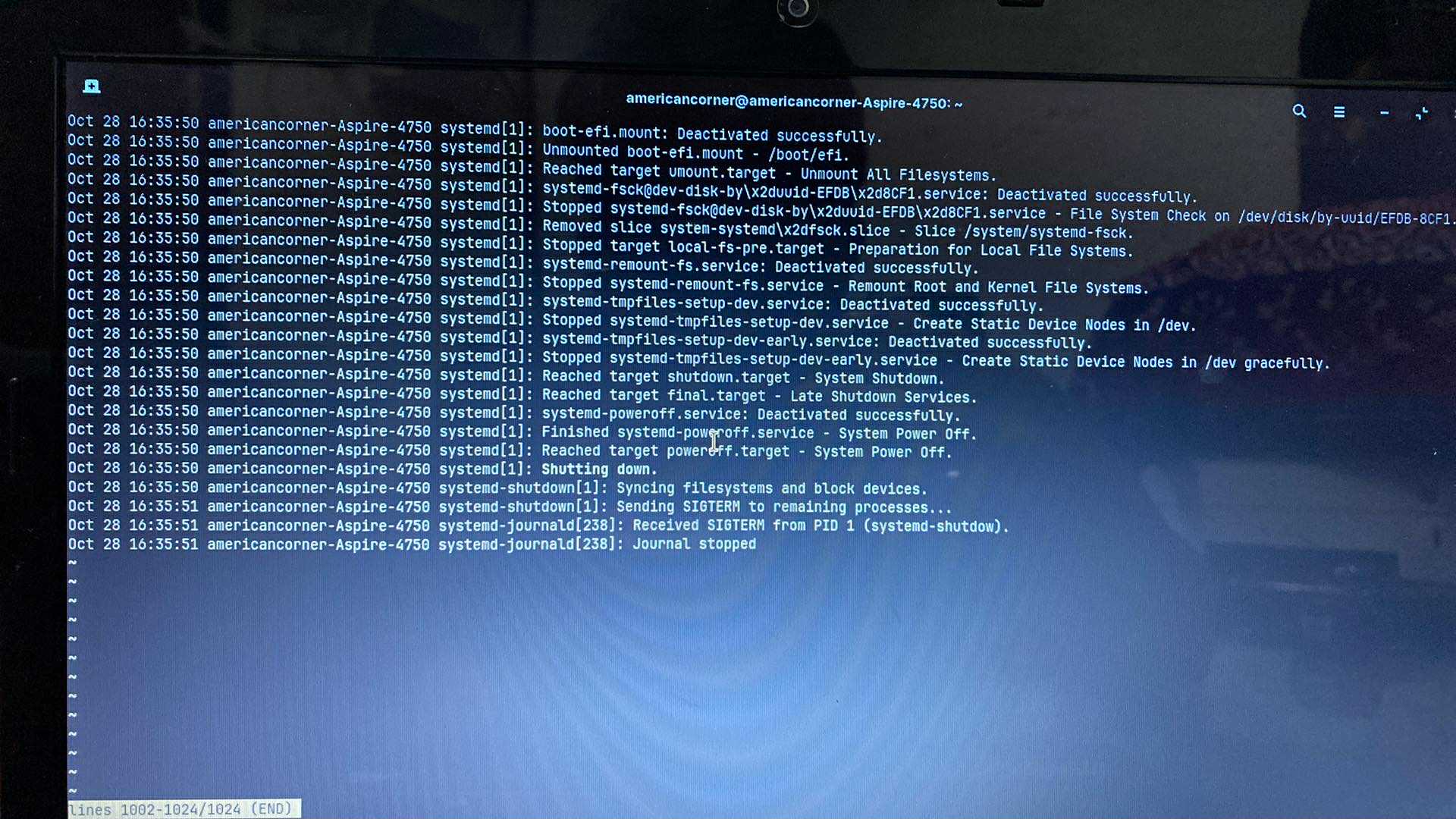

There’s no Secure Boot or Fast Boot option in the BIOS since it’s an older laptop model. I upgraded the HDD to an SSD, but I suspect the BIOS may not fully support the SSD upgrade when using Windows. I also tried installing Linux, but it seems to have the same issue. I’m confident it was a clean installation because I selected the second option, “Erase disk.” Could you check this log? It might help identify what’s causing the problem.
