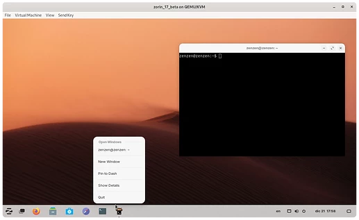

This appears to be a bug in 17. I reported it when I was trying out 17 Beta. I have attached a screen shot showing what you get when you try to pin certain programs. As you can see in the screenshot I have been able to pin other programs. I have not been able to determine why some programs can be pinned while others can't.
could it be a flatpack issue ? grasping at straws tho not a deal breaker.
Well you brought up a good point so I checked to see where I installed them from. It seems the ones installed from Zorin OS can't be pinned but the ones installed from Flathub CAN be pinned. Something for the Devs to check out I guess.
Hmmmmm, can of worms LOL
The example I shared above uses Kitty terminal, installed as a regular .deb
package so it must be something else.
Although I seem to get the same behavior when I have both the .deb
and flatpak versions installed at once. I just tried with Xournal++, all good, then installed the Flatpak version and pinning continued to work but only from the Zorin Menu. With the deb
version running I couldn't pin it anymore. I just uninstalled the Flatpak, all back to normal again...
