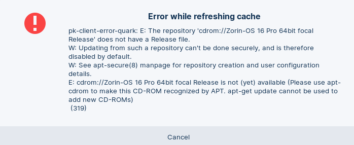

Now I get this error message.
The USB name is Zorin OS 16.2 Pro 64bit so I changed the name from Zorin-OS 16 Pro 64bit to the actual one via sudo nano /etc/apt/sources.list. Didn't help.
