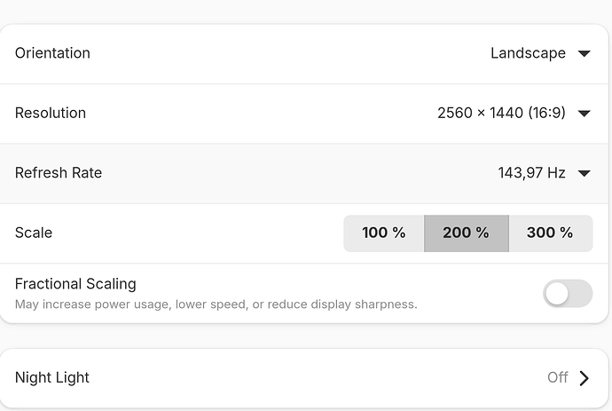

i mean, BEFORE the upgrade, all worked fine, the latest nvidia-driver-580 was installed and also you could see how fluent the system is (see image)
RIGHT AFTER the upgrade, after rebooting, the system uses wayland, 60hz (which you can feel in the unsmoothiness when you move the mouse) and how laggy browser and the programs opens.
Even when I try to re-enable x11, which i can by logging out, but it stays the same, so idk...
i should have not set signed, idk what is going wrong but sure is that my drivers are not being recognized anymore after the upgrade!
