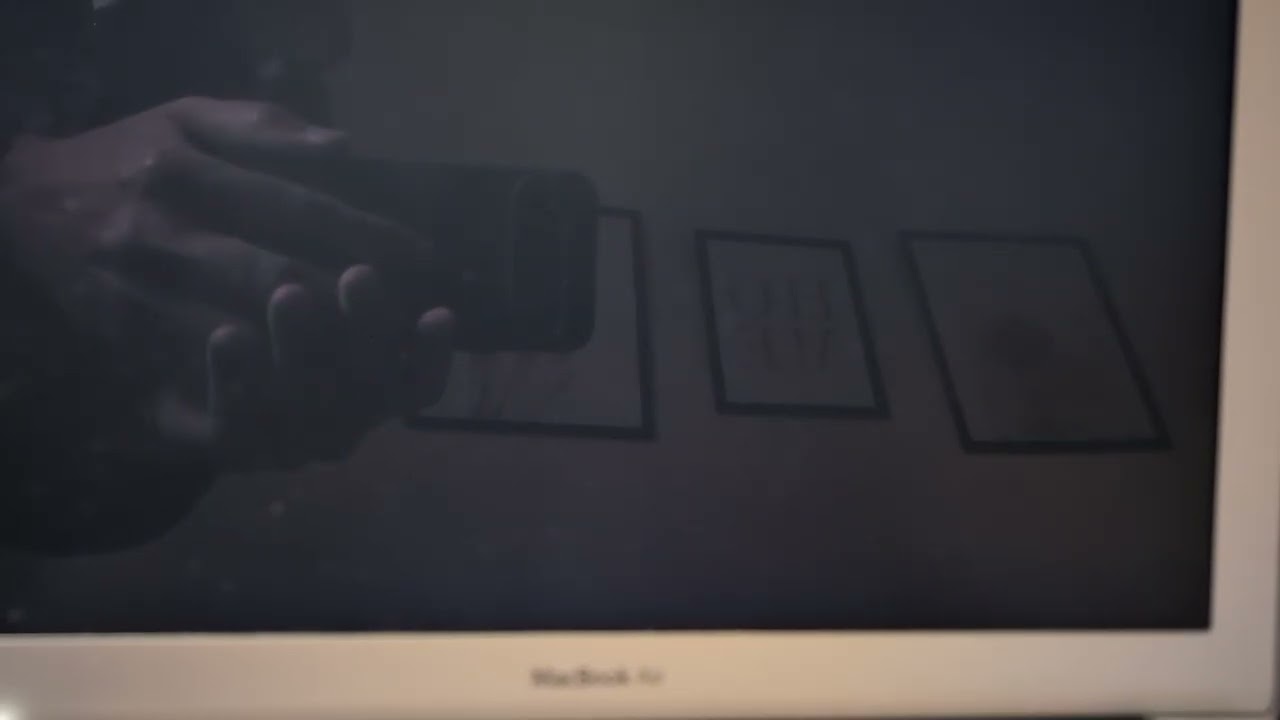

I notice that when I start my mac, that black screen appears for a few seconds 10, 15, and then it shows me the ZorinOS logo, usually the logo should appear naturally when the laptop is turned on or not?
Yes, that's normal. Do you have an SSD, spinning drive or...? The faster the drive, the faster the startup but in any case this isn't a concern.
SSD, the official one for Macs. For example, when you turn on your Mac with MacOS, it boots instantly. However, when I install a Linux distro, it's just like you saw in the video. That's what I want to understand.
I have had it occur sometimes where a specifically connected USB device will cause bootups to take longer than they should. Could be worth removing if you have any USB devices connected just to see if that may help. May or may not, but it was the cause of a 30 second delayed startup for me.
I was never really too invested in looking for a solution, since I've always turned on my computer and done something else, but if you're worried you can try.
With or without USB, the boot is always like this. That black screen and then the ZorinOS logo appears. Maybe they are not fully optimized for Macs.
You could do a systemd-analyze blame on your system to check what's taking the longest to boot. That being said, I would think you're correct and you're not going to get that Instant on that you used to with Mac OS, since it was specifically designed with your device in mind.
If this were me (and it was when I used linux on an old 2012 Macbook Pro) I always accepted the slightly longer boot times. It was worth it to have a system that was usable to me compared to .... MacOS. I haven't used it since that time, but man did I hate that OS with a passion. Or rather, maybe it hated me more. Regardless, that's just something I accepted when I made the switch.
