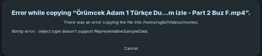

Hello, I was trying to transfer a file from my phone to pc (without installing an app on my phone)
libmtp error: object type doesn't support RepresentativeSampleData.
I got this error, I searched and I saw that it might be related to file name.
So I tried to rename the file but this time I waited a lot and then I got this error:
libmtp error: call to ptp_mtp_getobjectpropssupported() failed
