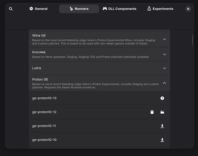

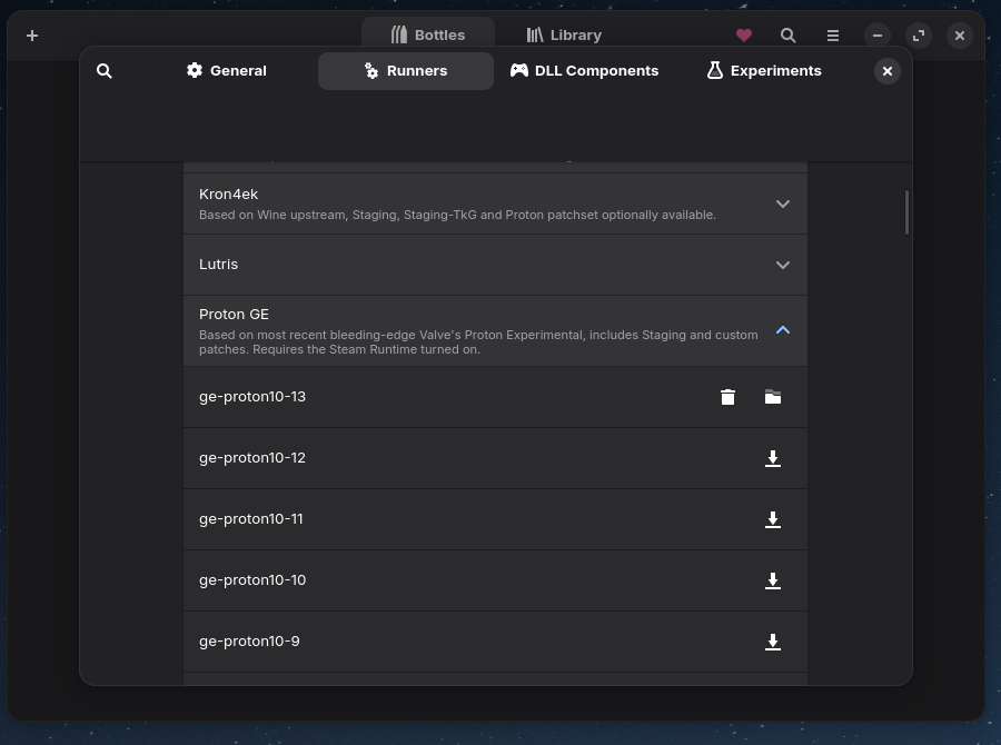

Anyone else not able to install proton10-13 on Bottles?
Fresh zorin install, all updates done, downloaded bottles as always, but can't download proton10-13, it says:
"The installation failed. this may be due to a repository error, partial download or checksum mismatch. Press to try again."
When i try again, it downloads, and at the end shows the same message again. Bottles downloaded from Software Manager.

Have you tried other versions to download and see if the same error comes up? I believe by default in the software store that Bottles comes as a flatpak, is that correct or am I misremembering?
Yes, 10-12 seems to download and work just fine. And yes it is a flatpak in software manager.
Just thought it was strange as it was working with 0 problems since i started using zorin, about a week ago.
Also i just saw that they released proton10-14 today, maybe they pushed an update to bottles and broke it? (I'm sorry if that sounds stupid lol)

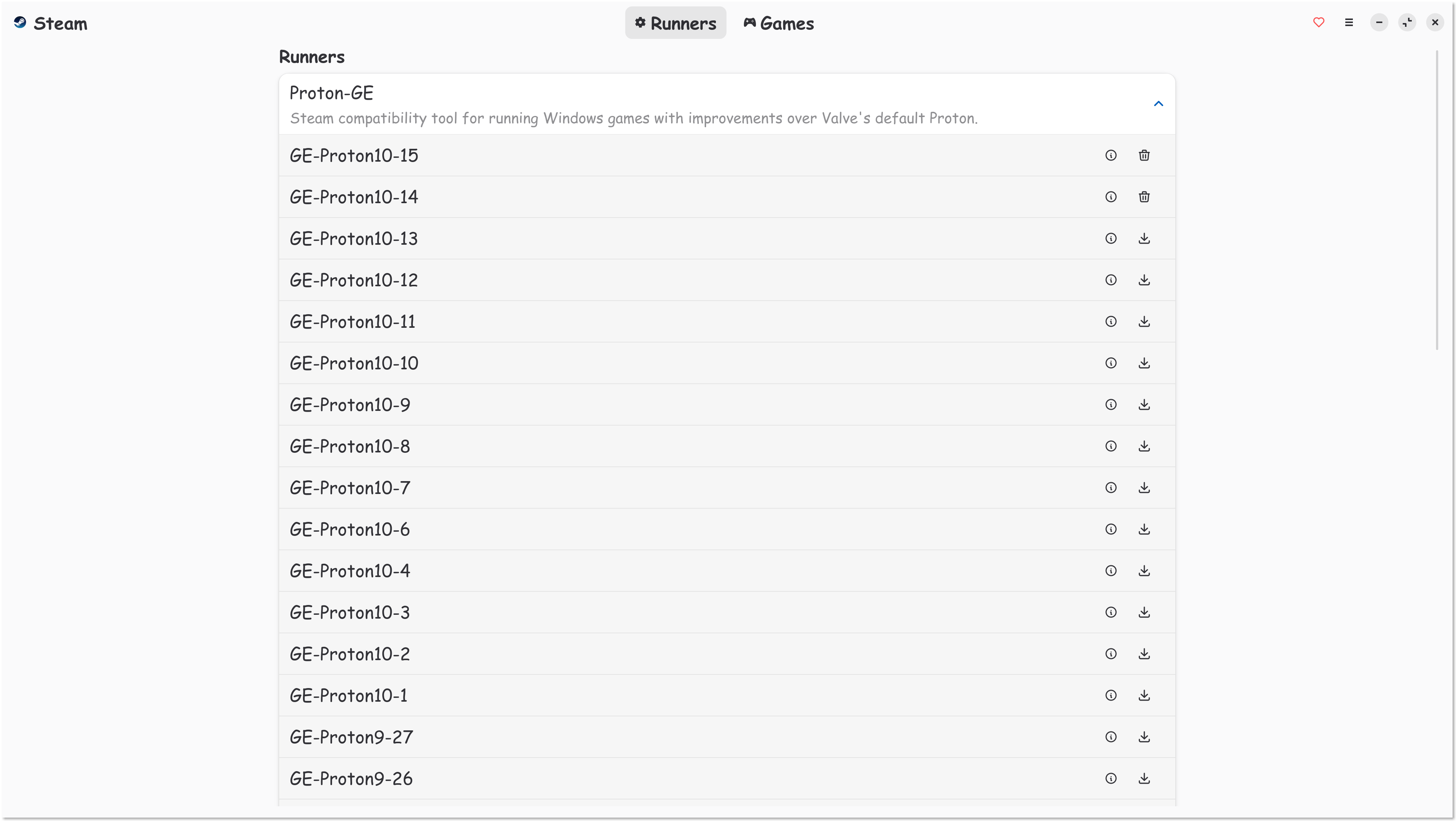

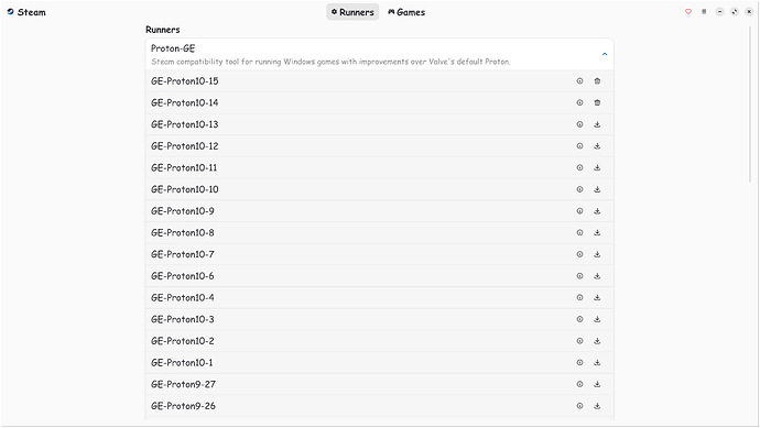

I just checked my ProtonPlus APP, and I have Proton GE 10-14 & 10-15, and got them installed. Make sure your APPs are updated.

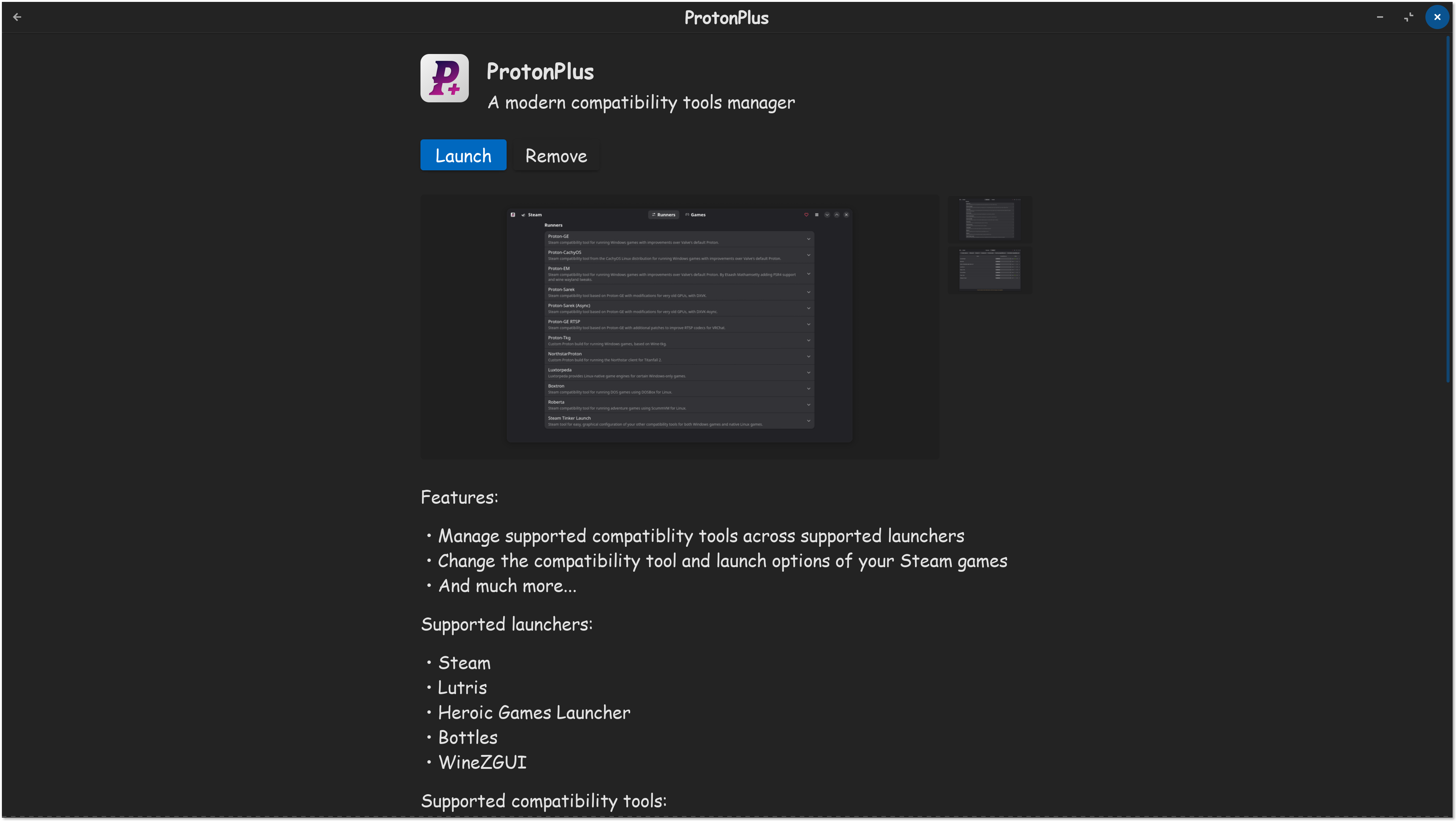

ProtonPlus Install from Software Store:

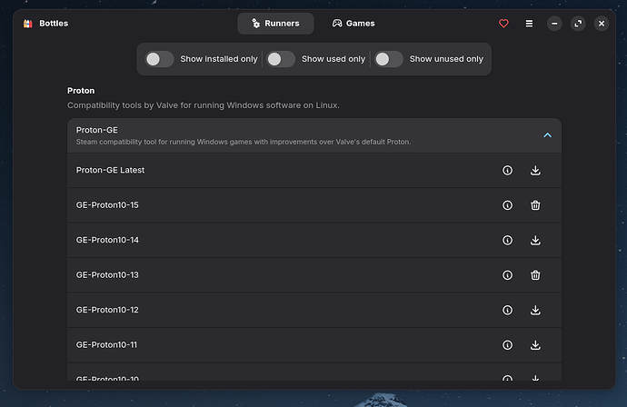

ProtonPlus Previously Installed:

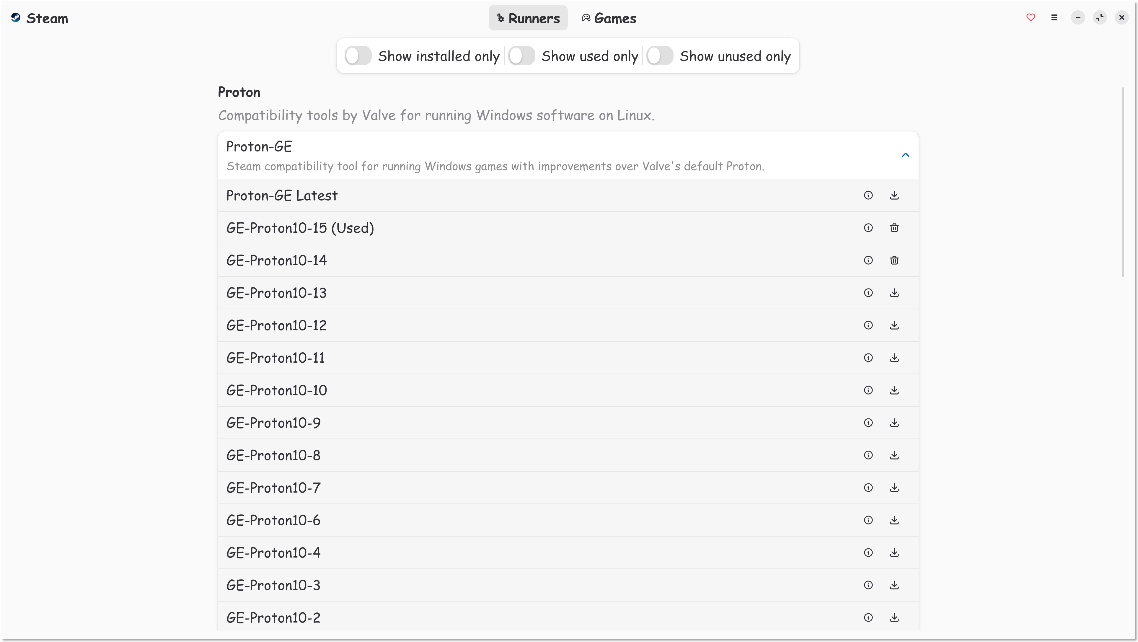

ProtonPlus After Updated In Software Store:

I've been using Bottles for more than a year and a half and have helped people with a fair few problems using it. I somehow had LITERALLY NEVER found the menu for installing runners from within Bottles. Until I saw your screenshot, I was convinced there WAS no way to do that, and that you must've been confused. I apologize and stand corrected!

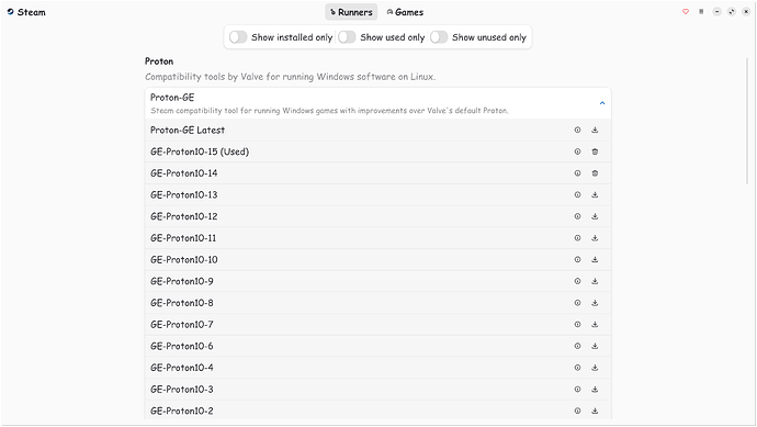

Okay so i downloaded ProtonPlus, and it does install to bottles as you said, but the thing is i can only do that to 10-13 and older versions.
When i try to install 10-15 through ProtonPlus it downloads, but nothing shows on my bottles, i can't even see this option as available.

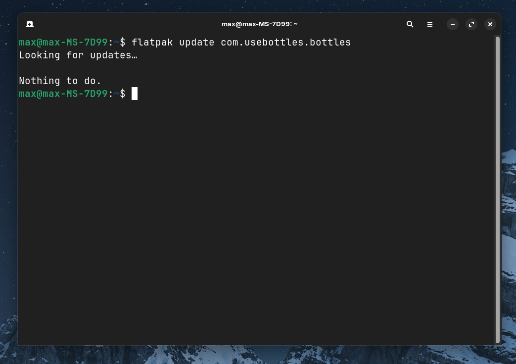

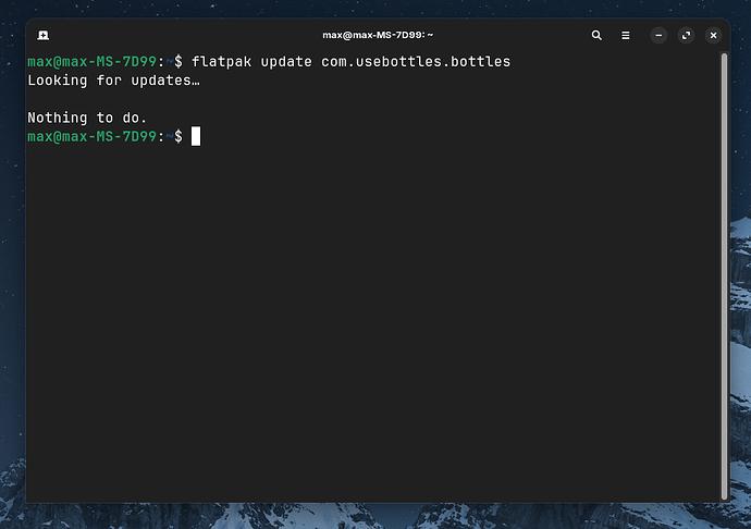

Also updating from terminal does not work:

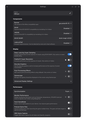

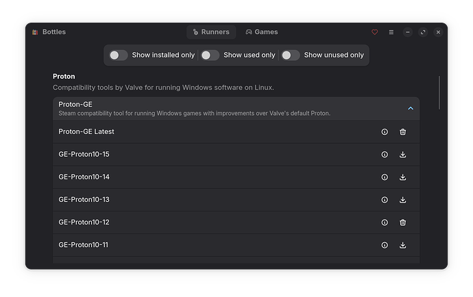

From your screenshot, you don't see GE-Proton10-15 because you're still on the download screen, not settings for a bottle. If you want to set a new runner on an existing bottle, you need to open that bottle, click Settings, and then use the runner dropdown. You can see it on my machine here:
