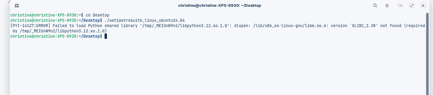

All my ZorinPro 17 software is up to date, as far as I can see. However, I have an application that refuses to run because it cannot find GLIBC-2.38.
It is an astrophotography processing app....yes I know, I'll be contacting the developer in due course...but thought I'd ask here first.
The app has two versions; one suited to Ubuntu20.04 and the other to Ubuntu24.04 However, neither of them will run (I have ticked the executable box in the properties, to no avail, on both).
When I attempt to run the 24.04 version from the terminal, it says that it cannot find GLIBC-2.38. When I run the earlier version, it will only open by using the terminal command, and promptly crashes when I try to use it. It might have a crash log but I can't find it.

Zorin OS 17 uses glibc 2.35, same as Ubuntu 22.04

Zorin 17 is based on Ubuntu 22.04, so some things that require Ubuntu 24.04 may not work, and I know it's not using the newest glibc, as that's what prevents me from replacing the desktop environment with Plasma 6. When I looked into checking glibc versions, I found two main methods: running ldd --version, which reports 2.38 (the version you need), and simply typing out the location of the file (/lib/x86_64-linux-gnu/libc.so.6), which returns 2.35. I'm not sure how to account for the discrepancy.

The location /lib/x86_64-linux-gnu/libc.so.6 will show the system glibc version. However, the command ldd --version will show the ld linker ld.so
If you have installed as Flatpak package that included an ld.so of a higher version, that may show up using ldd --version
