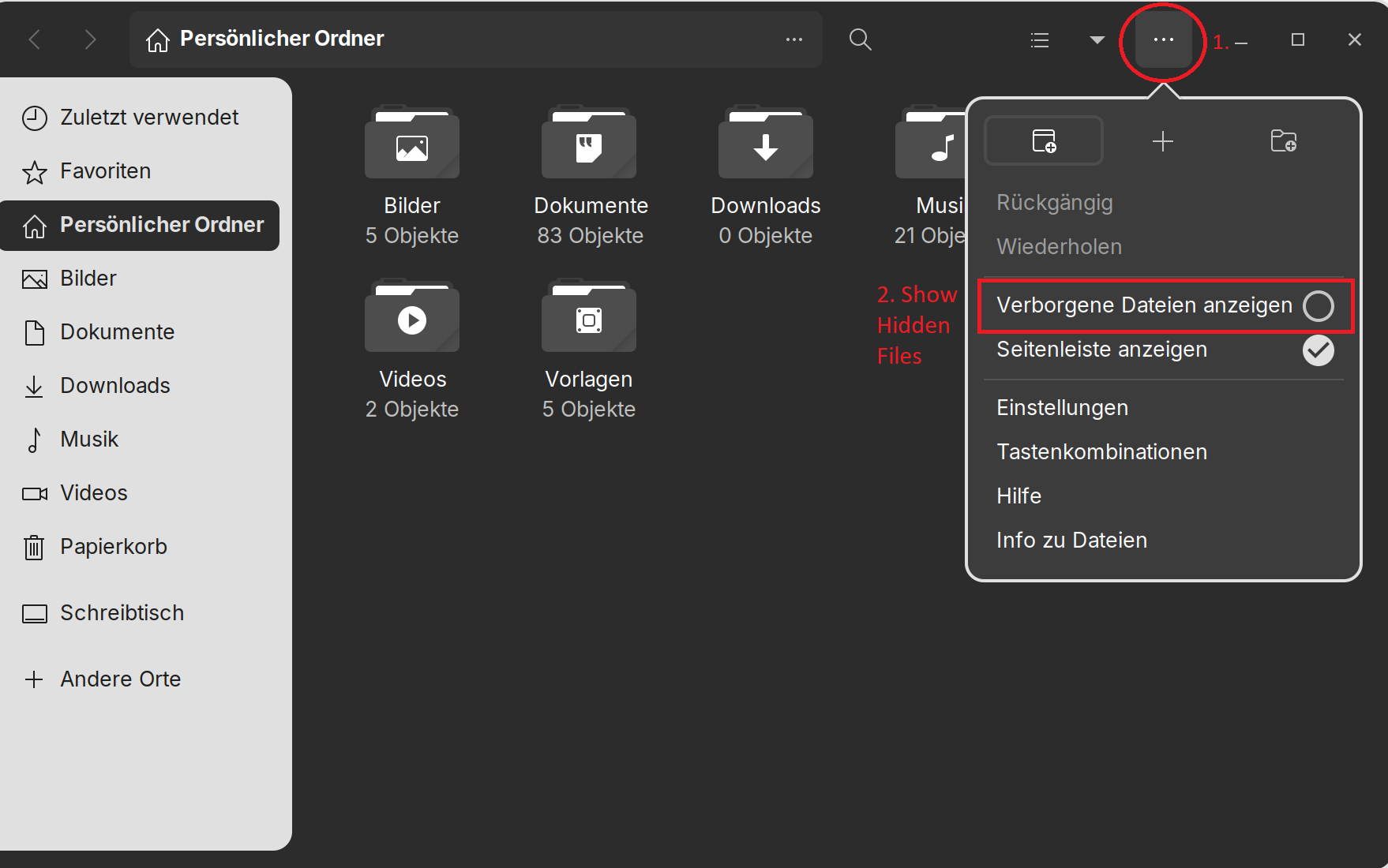

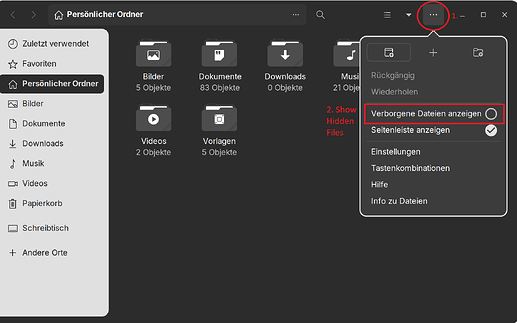

If it not already exists, You have to create the .icons Folder first. Open Nautilus (the File Manager) and click on the Menu Icon beneath the min/max(close Buttons and choose ''Show hidden Files'':

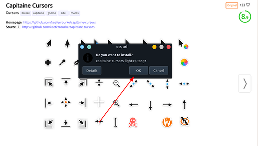

I don't understand why you guys complicate things for no reason. Pling literally has a built-in tool that allows users to just click Install and a window will popup, and it'll basically install the cursor pack (or theme, icons etc.) for you.

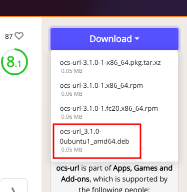

The site can install the package for you when you click Install as i mentioned above, but for that to work - you need to install ocs-url
Download the ocs-url.deb file and open a terminal:

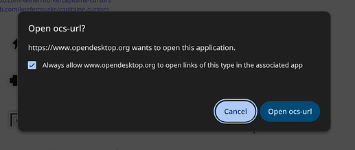

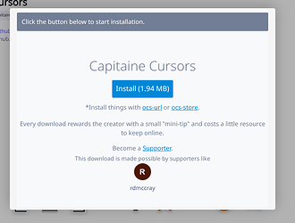

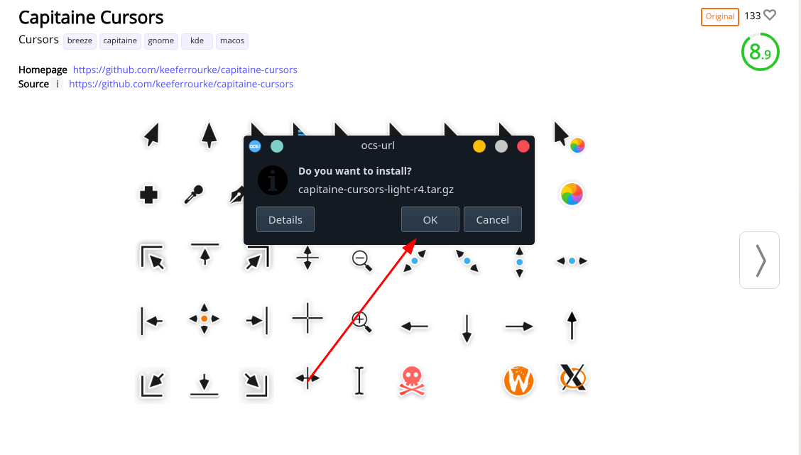

Head back to your browser, go to pling.com and find the cursor you want to install. Click the blue install button on the top right, and a window will pop up - proceed to install it:
tick this checkmark to skip this step in the future:
Click OK and see let ocs-url do its juju magic

Done! Installing via ocs works.
