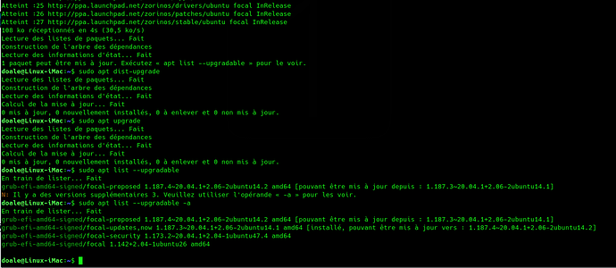

That's the problem, it does'nt do anything... I've never seen this before, it's like it does not know what to do, and so the update always stays as mentioned when I do apt update.
See the commands and their effect in this new screenshot.
Thanks !

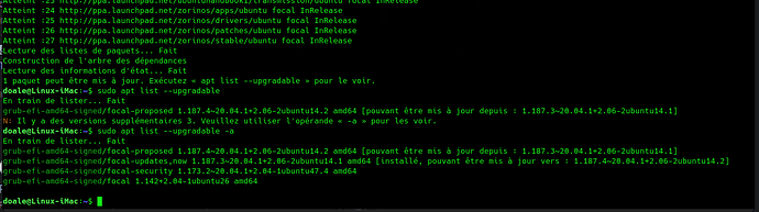

You can see that apt update says that 1 package can be updated, but the upgrade never do the job. That's why I show the list like apt ask me to with list --upgradable -a.
