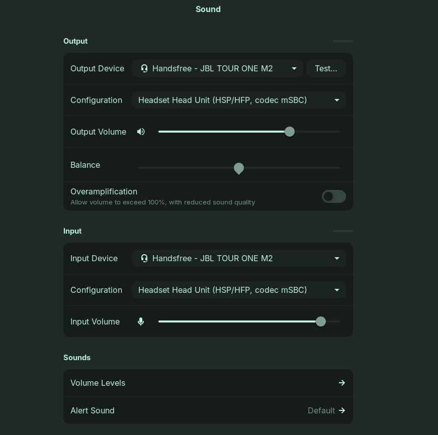

I recently installed Zorin OS 18 Core, but when I tried to use my JBL Tour One M2, it didn’t work as expected. Im using in bluetooth mode.

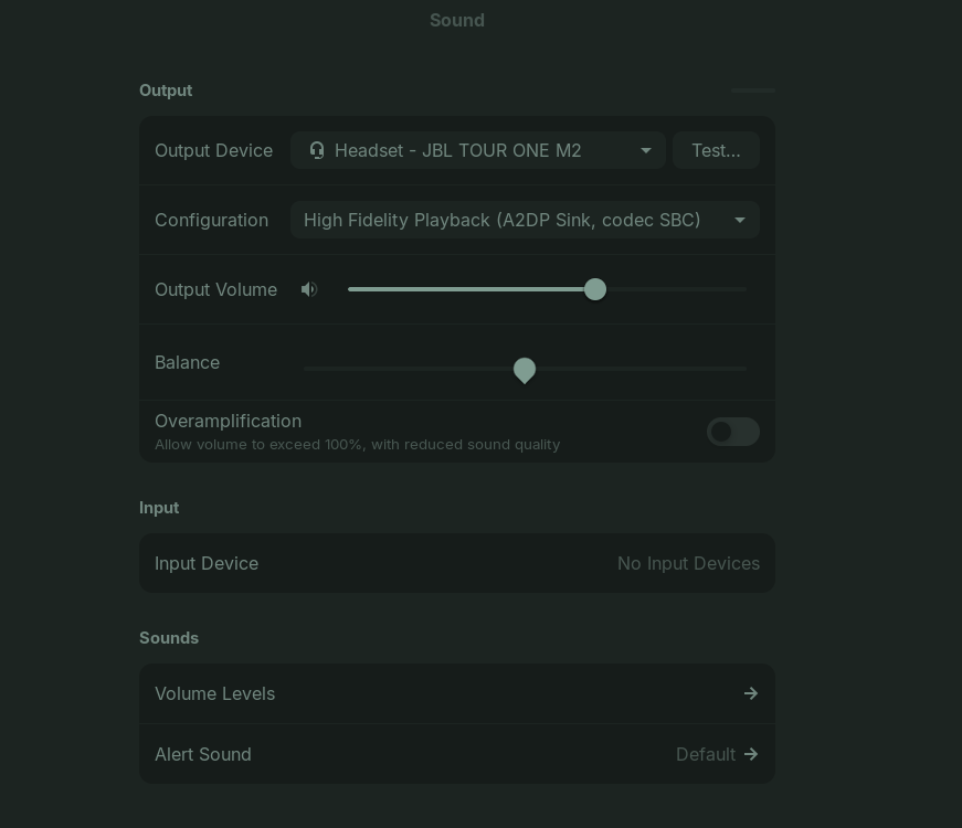

When I use the headset in the "Headset" mode, everything is fine — the sound works perfectly.
The issue happens when I switch to "Hands-Free" mode to use both audio and the microphone.

I can confirm its properly paired because in the Headset option the sound works just fine.
When I switch to Handsfree, i can’t hear anything anymore
