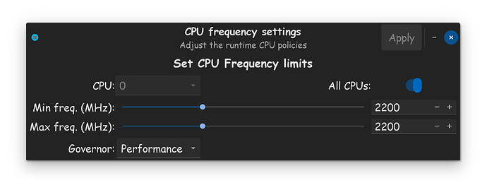

If your computer is 8 years old or newer, it will automatically change CPU frequency, based on what is required, controlled by the BIOS.
However, if you want to lock a CPU frequency on a specific number manual, it would be better to use a extensions, that allows you to lock it in, where you want it to be.
Some folks report that one is no longer available to them. If you can use that one, due to version limitation, then you could also try using this.
This app is a little more simple, as such, there is less to know to use it.
Like I said above, the only problem with extensions, is much of them are getting deprecated now days, forcing one to try a different extension.
As Linux distro's get upgraded to new versions, gnome in particular decides it doesn't like supporting extensions anymore, wants to get rid of them, so that complicates matter's.
But as I said above, you shouldn't need an app or extensions for auto changing cpu frequencies, your BIOS will do that naturally. So unless there is something I am missing here, this the only advice I can give you.
