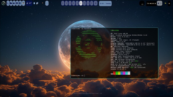

I have switched to Void Linux on my laptop. I would have to use an external USB SSD disk to retry an install and see if it work now. But I have big doubts that the grub problem with zfs is resolved.
