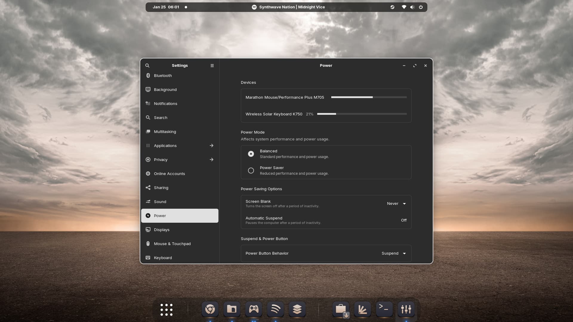

Right click on the background and click settings.
In settings go to Power.

That is not the same as main power battery and does not show under Zorin>Settings>Power
