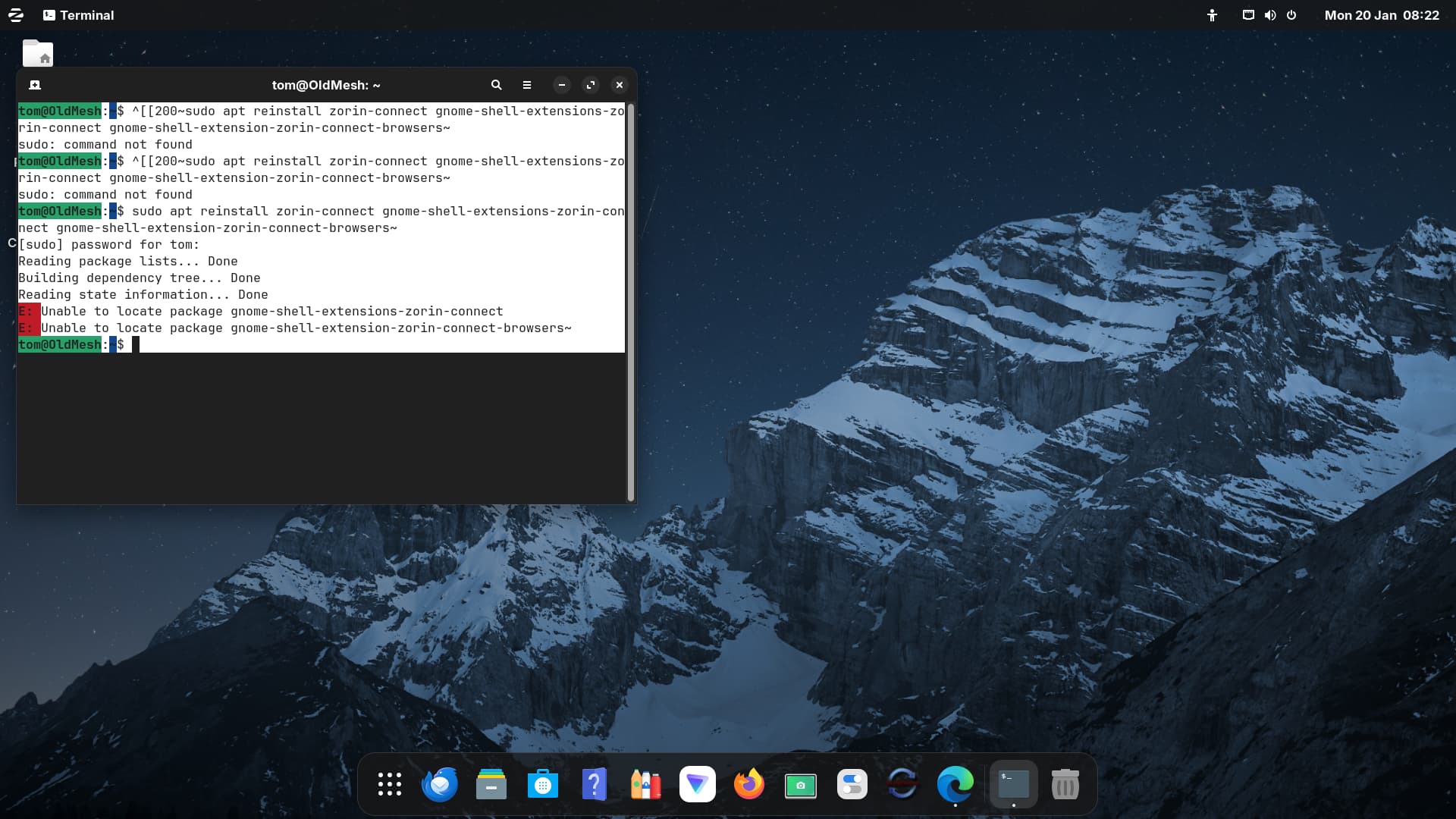

I tried the uninstall and, once I got the right command, it says this
Hi, thanks for the reply. See my reply to Ponce-de-Leon - this said the files couldn't be found. I then tried your Terminal command for install and it says everything is up to date so it seems to be installed

Okay, I see 2 Mistakes. One from me (Sorry for that) and one from You. In Your Command is at the End where browers stand a ~ what is wrong and I wrote an s too much. Here is the Command:
sudo apt reinstall zorin-connect gnome-shell-extension-zorin-connect gnome-shell-extension-zorin-connect-browsers
I creect the s Mistake by the Uninstall and Install commands, too. Again: Sorry for this.
