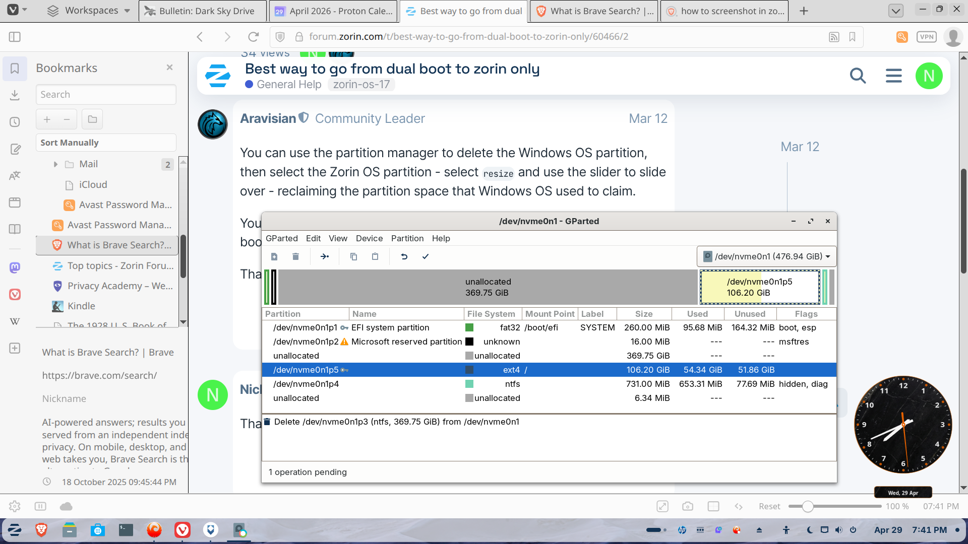

Went into Gparted, selected the Windows partition, unmounted it then deleted it. This is what I got.

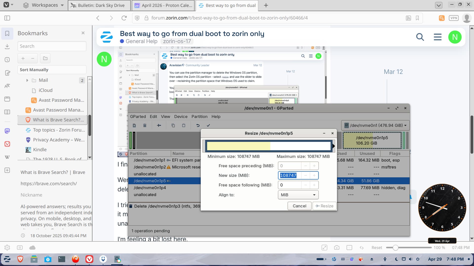

I tried to resize the Zorin partition but it will not seem to allow me to make it more than a tiny bit bigger than it is now. Maybe because the unallocated space feed up from windows is to the left?
I'm feeling a bit lost here.
This is the resize attempt on the Zorin partition
Are you resizing the Zorin OS partition while booted into it?
OR while booted into LiveUSB with the Zorin OS Partition unmounted?
I'm booted into it. From your question, I guess I need to find my USB boot stick and reboot into it, right? Then unmount the partition? Then try again and then remount? Then reboot back into Zorin.
Exactly, you want to perform any changes or FileSystemChecK on unmounted partitions.
OK will try,
One more quick question. When I went to close Gparted prior to rebooting to liveUSB it said I had one operation pending. I am assuming this must be the deletion, but it is probably half an hour ago I did that. Do i just quit anyway and see what is happening when I go to live USB?
Yes, you can just quit. It is a selection you made; it is not in Progress.
