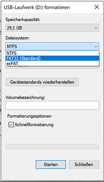

Tried to format the USB and the Windows (7) laptop that I have access to would NOT format it.
Is there a way (utility) I can change the NTFS USB over to FAT32 on Zorin?

When You make a right-click on Your USB Device, you should get a Format Option. Then You should be able to format it in a Window like this:
Another Option because You are on Windows would be to use the Creation Tool called Rufus. It will create the bootable USB Stick for You. and You can choose the Format.
Depending if Your BIOS is in UEFI or Legacy Mode, choose on the ''Partition Sheme'' Option GPT for UEFI or MBR for Legacy:
