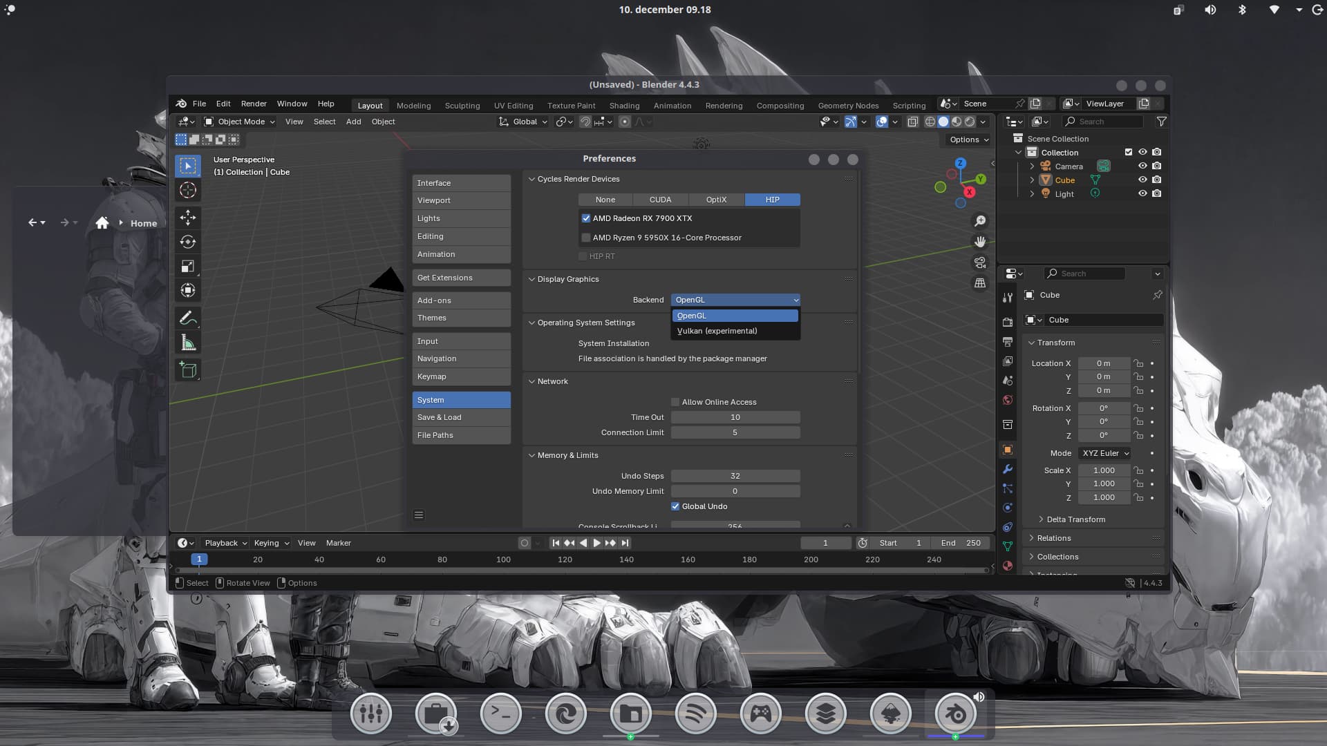

Blender Cycles, AMD GPU, Zorin 18 Core
Hello, with the recent AI boom and the end of support for windows ive opted to move to Zorin 18, with that ive built an AMD build but im having issues getting blender cycles to work.

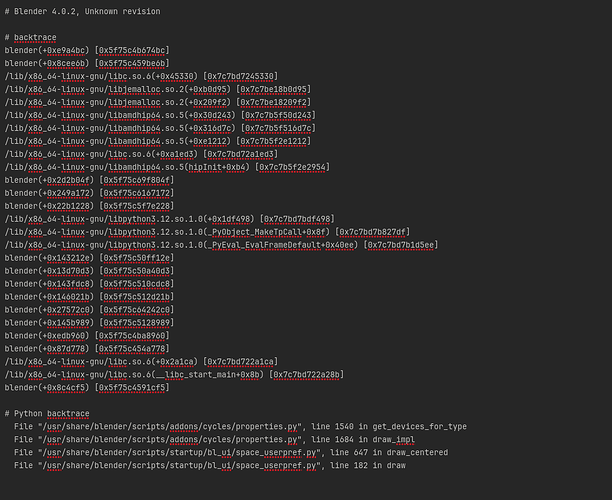

Hello! thank you for the response, unfortuneately when using the Zorin Os native package rather than the flatpack, simply clicking on HIP triggers blender to crash.
Im not sure how much it would help but ive attached the crash log:
