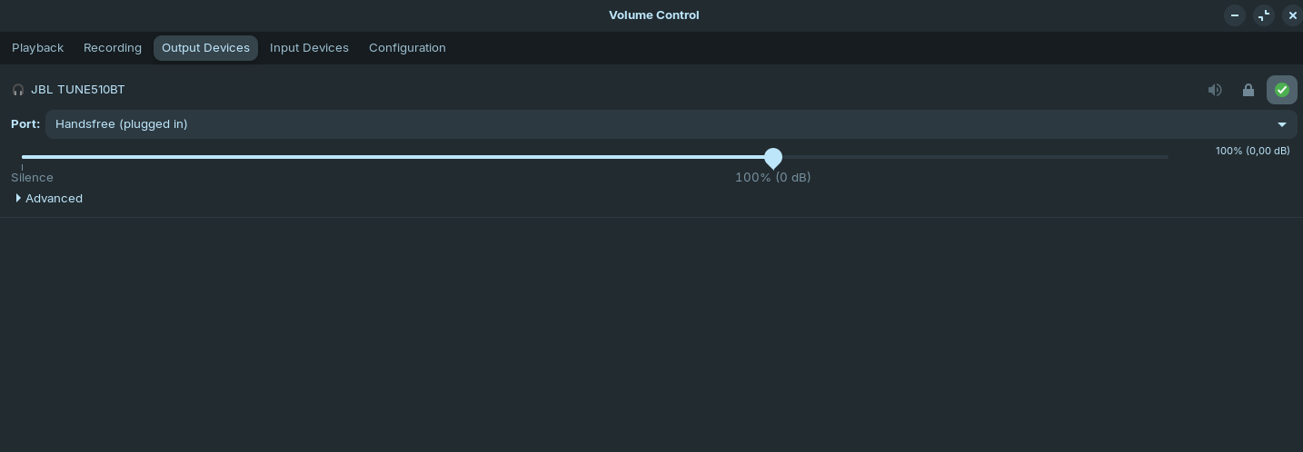

Bluetooth headphones stopped working for seemingly no reason
I connected my jbl headphones to the pc (dongle for bluetooth) to talk over the integrated mic but it refused to work. I tried the leo ai for a fix but it messed me up even more, leading to now my audio not working either. The chats with the ai i will include are in a foreign language, so if any translation is needed just tell me. I did every step that i was instructed except the last 3 strings.

input devices mi ne daje da promenim i samo je zakljucano na iskljuceno

zakljucano je u flatpaku a pavu mi je kao opcija samo dostupno pro audio

Sorry but I don't understand anything...
Did you try to reverse what the IA told you to do ?
Because for me the first thing I would have made you do is to try an older kernel....
i reversed everything except renaming the input chips name, since i don't know how to do that, also i appologise for the text being confusing
Sorry for my part I can't help you, maybe someodne else...
could you atleast tell me how to try an older kernel?
  • Restart the PC and hold Escape during boot to access the GRUB menu (may also be accessed with Shift)
  • Select "Advanced options for Zorin OS"
  • Here, you can see the available kernels to boot into. Choose the older one (without recovery option)
I don't understand the Language but from the Commands, it looks like You have installed Pulse Audio Volume Control. When this is still installed, waht Options do You have on the Configuration and Output Tabs for Your Headphones?
And the last Thing shows something for Discord. Does the Audio not work for this only or does it not work at all?
Well at first the audio worked and the problem was only with the microphone but now neither work at all
Did You tried on the Configuration Tab the different Audio Profiles from the Dropdown Menu?
I did, but for every option given it says in brackets unavailable except for pro audio, which doesn't work
What is with:
i apologise for the late response, it doesn't work at all, neither does the microphone
Are the Headphones connected directly or do You use a Dongle?
Bluetooth through a dongle
Did You checked the ''Additional Drivers'' Tab if there is a Driver offered? I mean, when the Dongle is plugged in.
There isn't a driver offered nor does it show up when i go to check in that tab.
I should point out the audio did work before i messed with it according to what ai told me, only the input was the problem.
What did AI told You?
well a few things but i narrowed it down to either it telling me to mess with qpwgraph or it changing the name of the input and output chip itself
It would be good to know more specific what was done.
In post #1 you can see the guide of AI.
@lac0nfidential Did you follow all those steps of AI before the problem with the sound happened?
What have you made to undo it?
